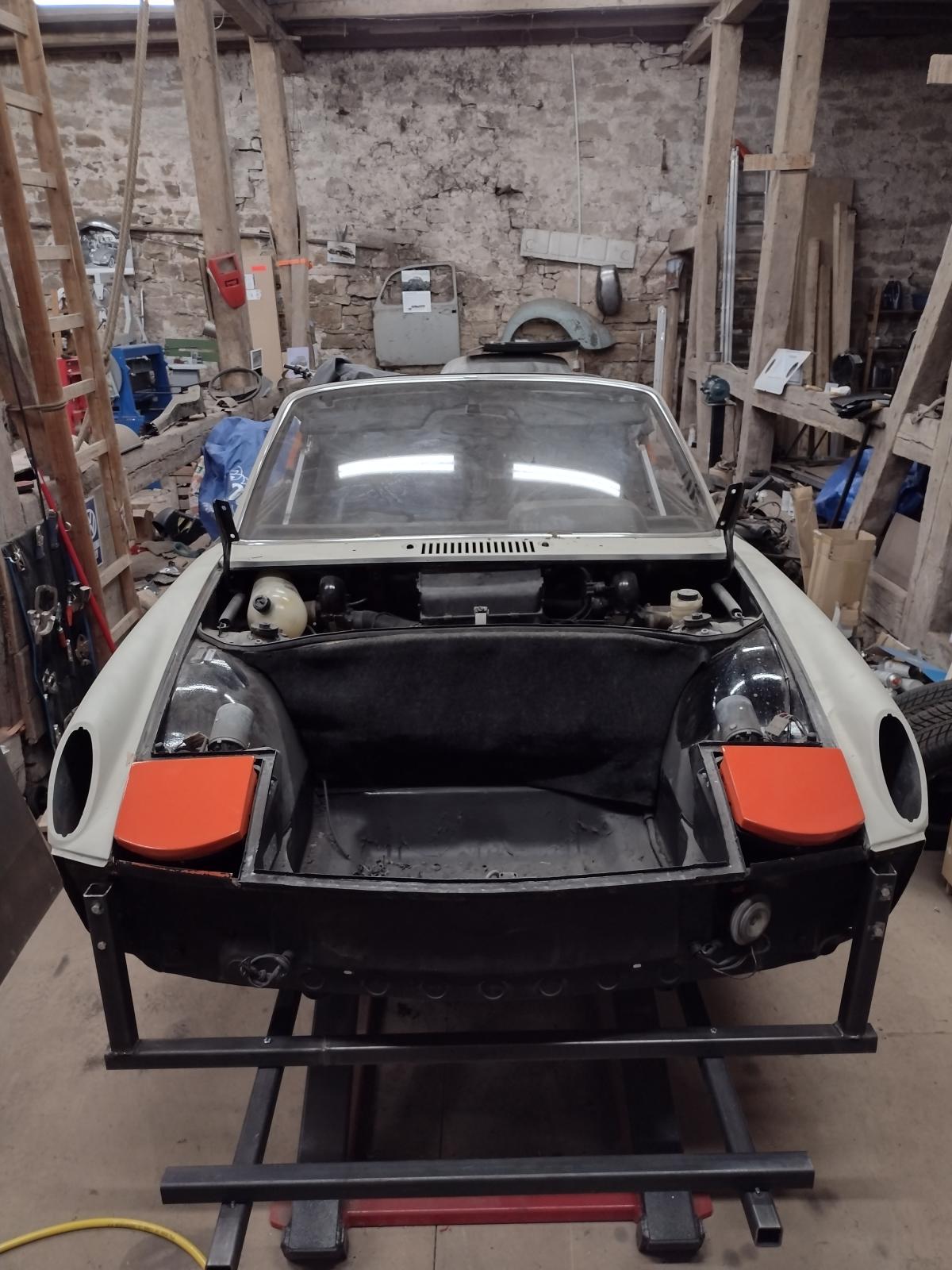

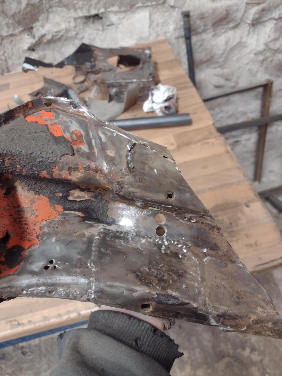

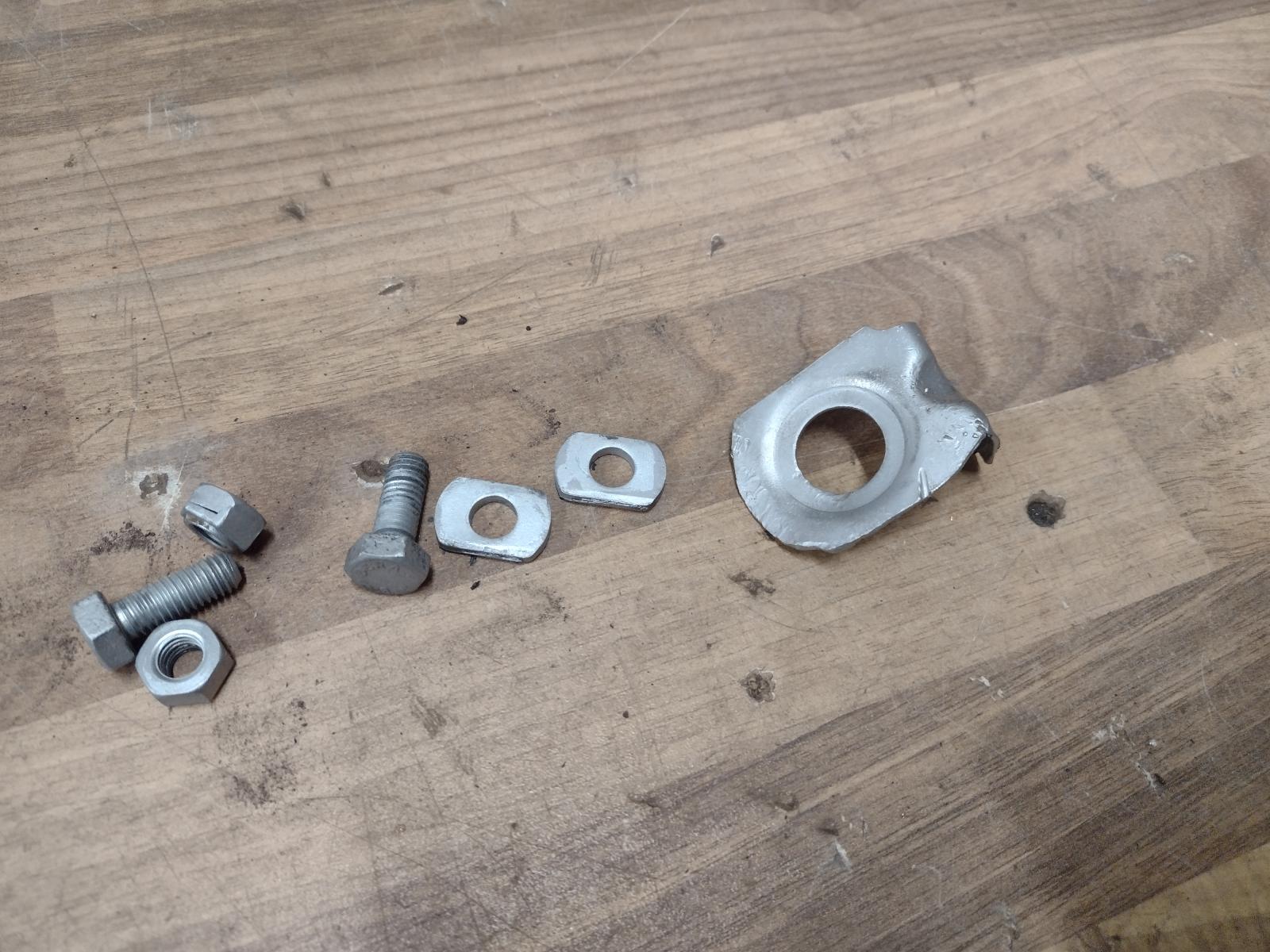

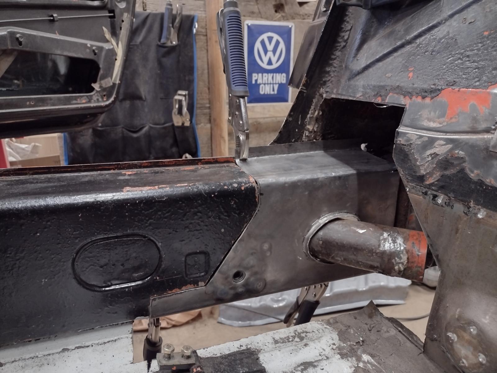

So, I finished welding the seat belt mounting point and adjusting my home made part of the long:
(IMG:http://www.914world.com/bbs2/uploads_offsite/www.thesamba.com-24690-1638781139.1.jpg)

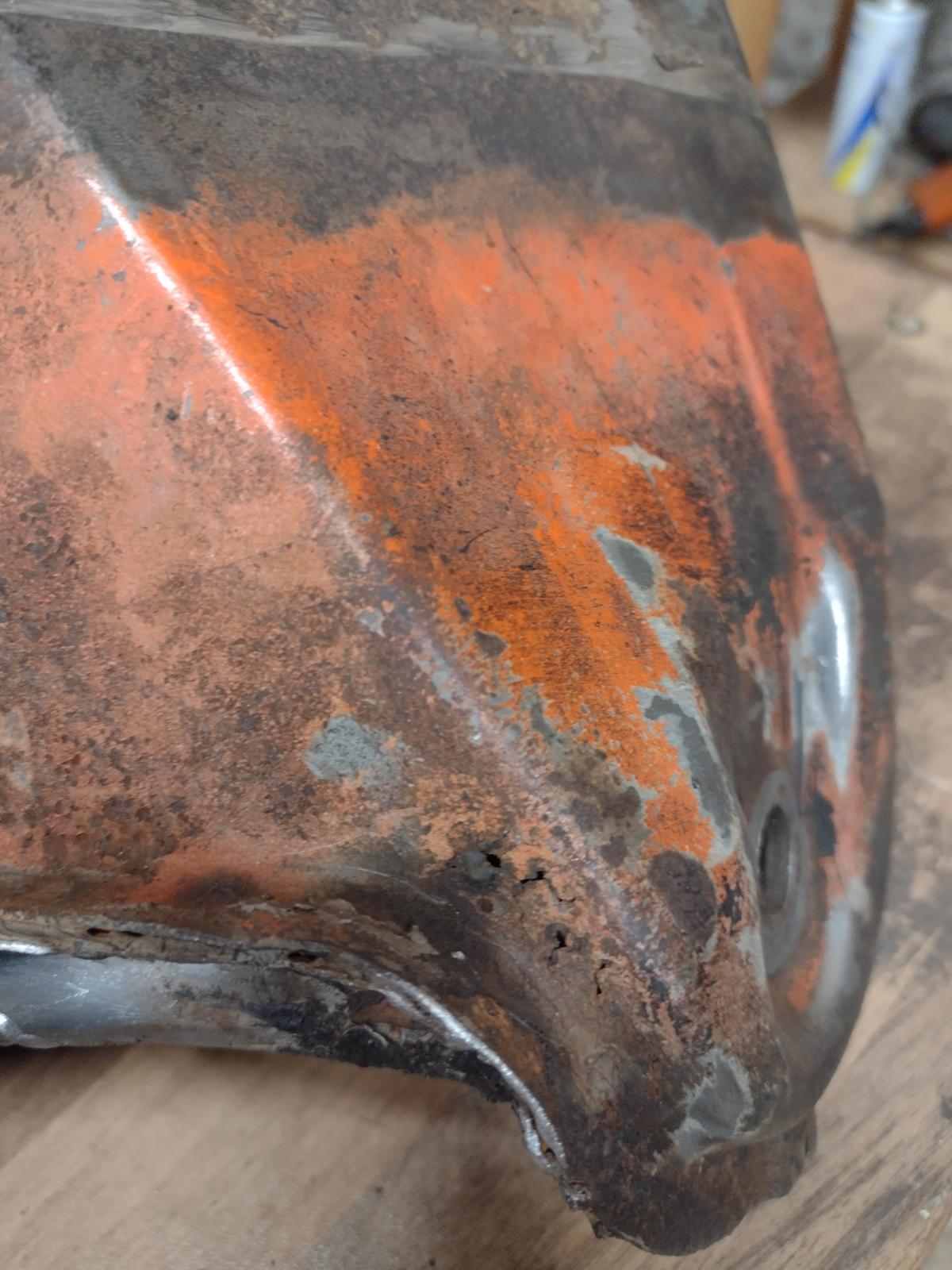

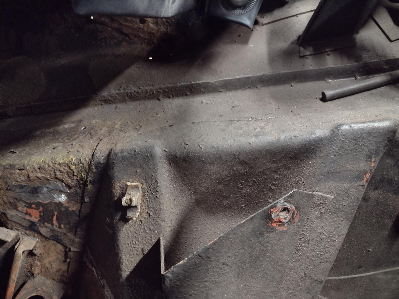

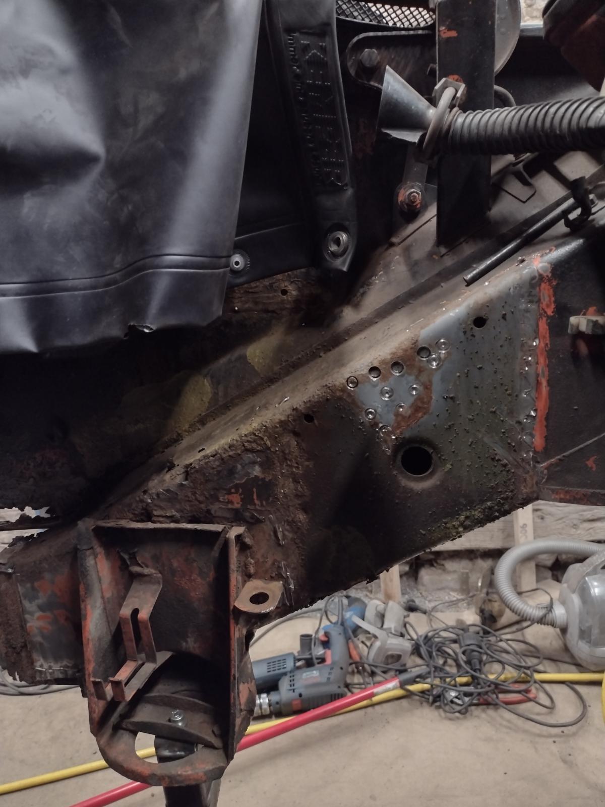

Then time to start on the back part. Plenty of rust:
(IMG:http://www.914world.com/bbs2/uploads_offsite/www.thesamba.com-24690-1638781141.2.jpg)

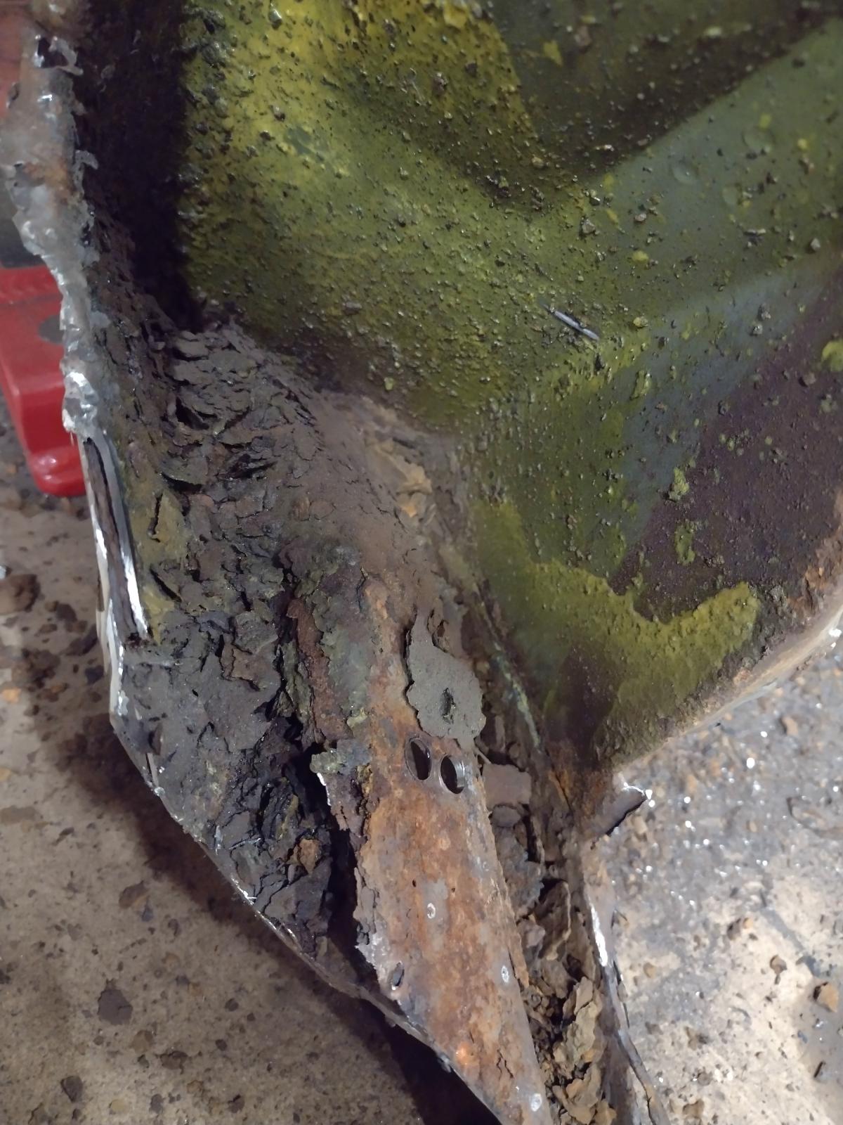

Inner suspension console has some rust, see here the holes:
(IMG:http://www.914world.com/bbs2/uploads_offsite/www.thesamba.com-24690-1638781141.3.jpg)

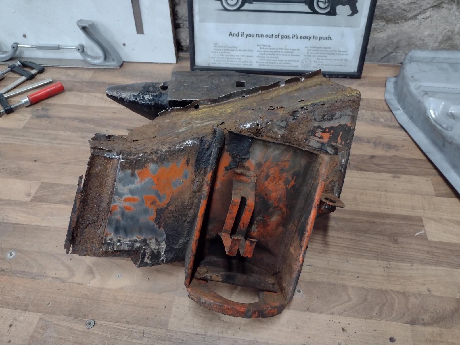

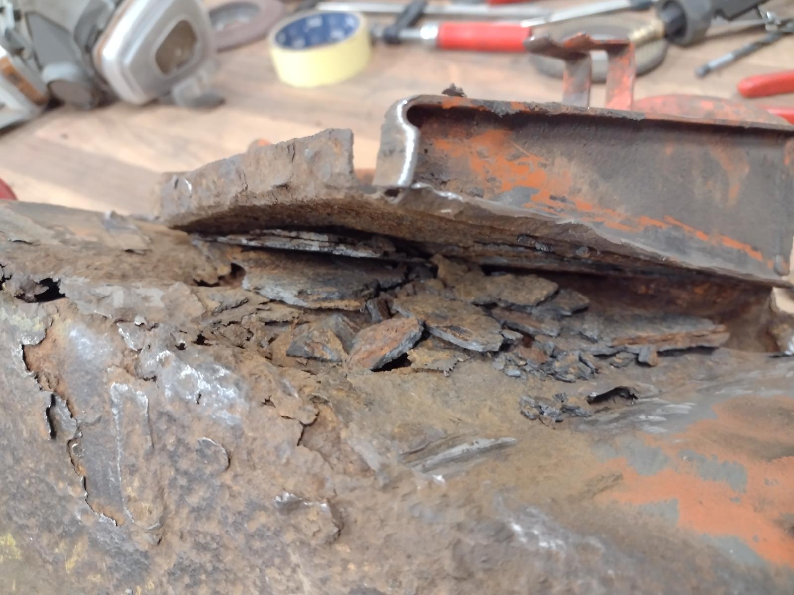

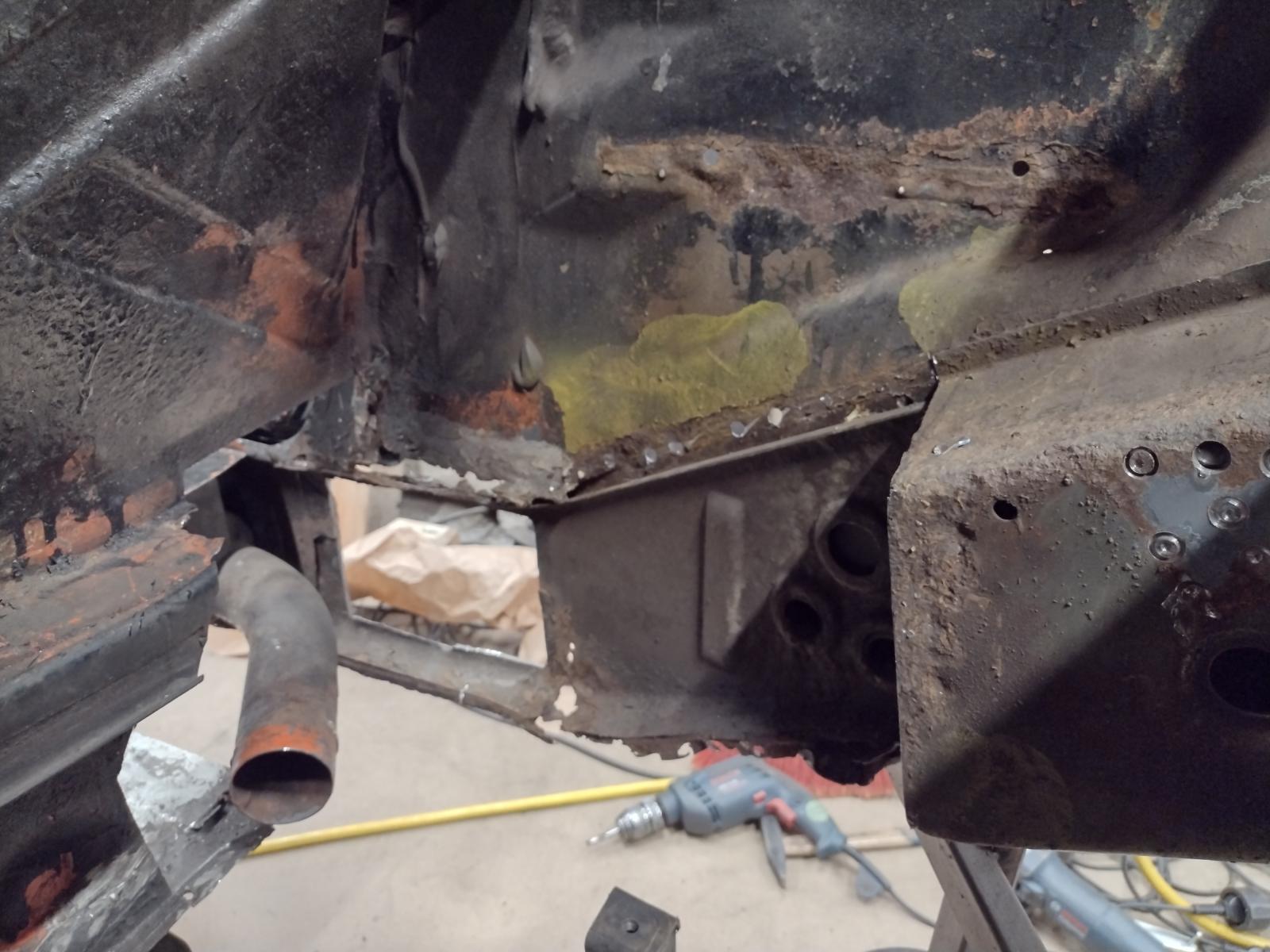

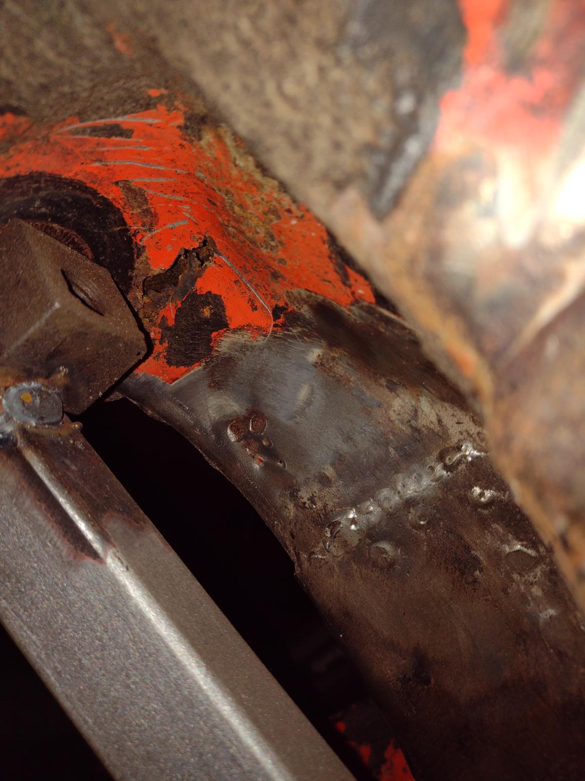

Some bad repairs with metal over rust, and looks like the long's rust gets up to it :
(IMG:http://www.914world.com/bbs2/uploads_offsite/www.thesamba.com-24690-1638781142.4.jpg)

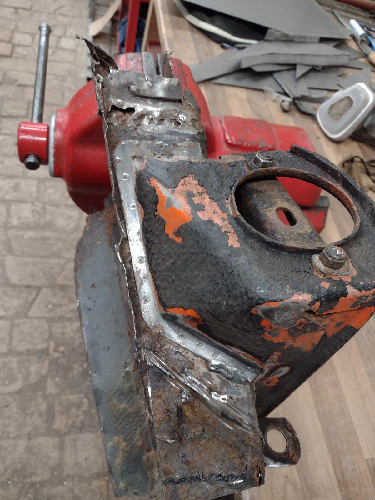

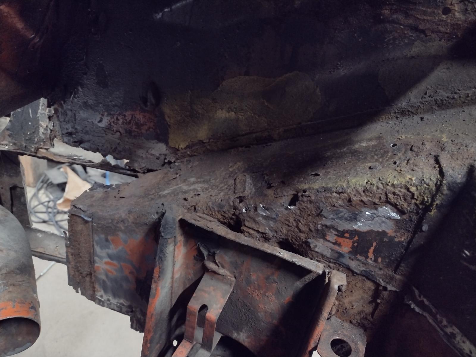

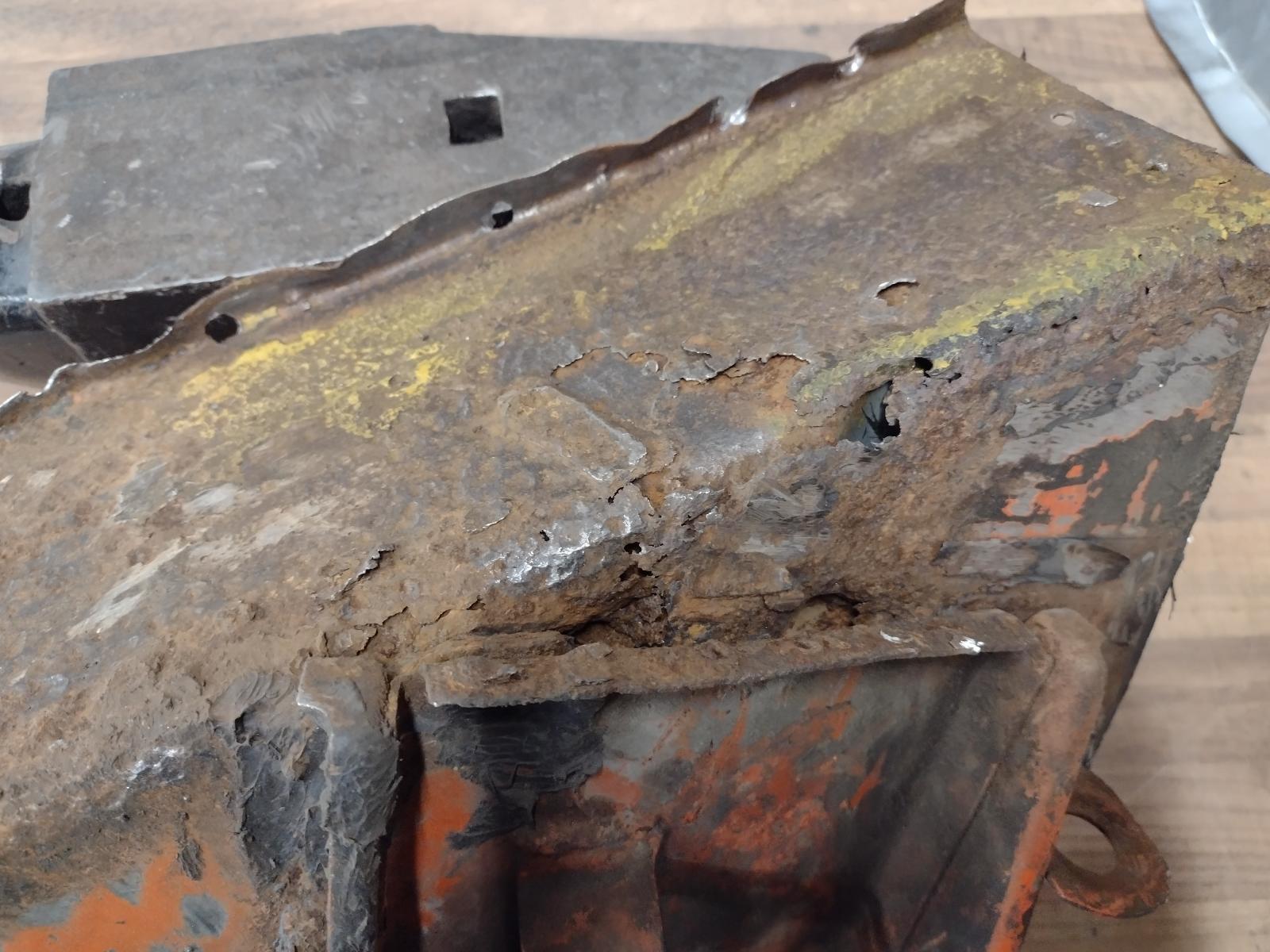

So decision was made to remove it to repair correctly..and I opened again a can of rust..
(IMG:http://www.914world.com/bbs2/uploads_offsite/www.thesamba.com-24690-1638781143.5.jpg)
(IMG:http://www.914world.com/bbs2/uploads_offsite/www.thesamba.com-24690-1638781143.6.jpg)
(IMG:http://www.914world.com/bbs2/uploads_offsite/www.thesamba.com-24690-1638781144.7.jpg)
So it's now removed:

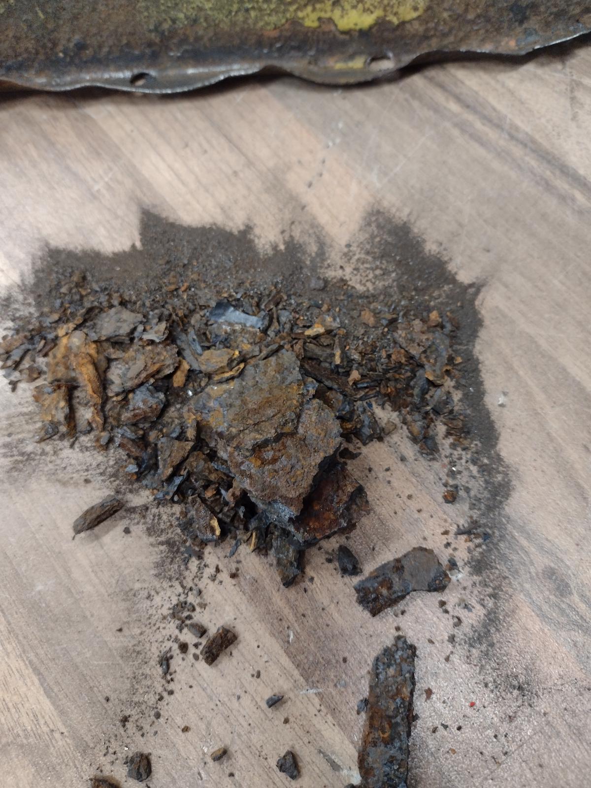

But it is really rusted through on several places and poorly repaired on others..
(IMG:http://www.914world.com/bbs2/uploads_offsite/www.thesamba.com-24690-1638781145.10.jpg)
(IMG:http://www.914world.com/bbs2/uploads_offsite/www.thesamba.com-24690-1638781145.11.jpg)

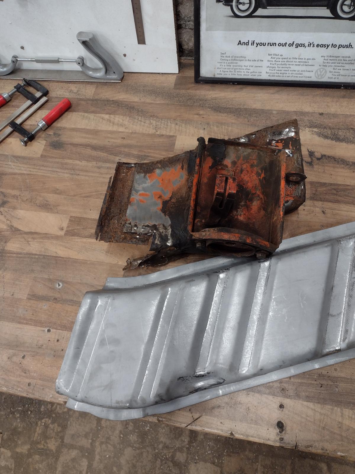

I think I will order a new one instead of fixing it..will be cleaner, efficienter and easier!
Just for fun made some assembly :
(IMG:http://www.914world.com/bbs2/uploads_offsite/www.thesamba.com-24690-1638781145.12.jpg)

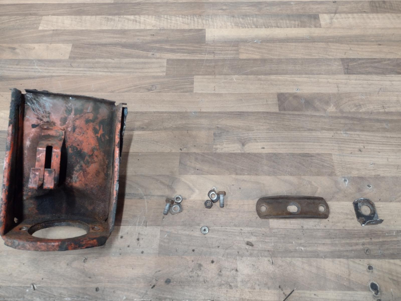

Time to remove the engine mount:
(IMG:http://www.914world.com/bbs2/uploads_offsite/www.thesamba.com-24690-1638781148.17.jpg)

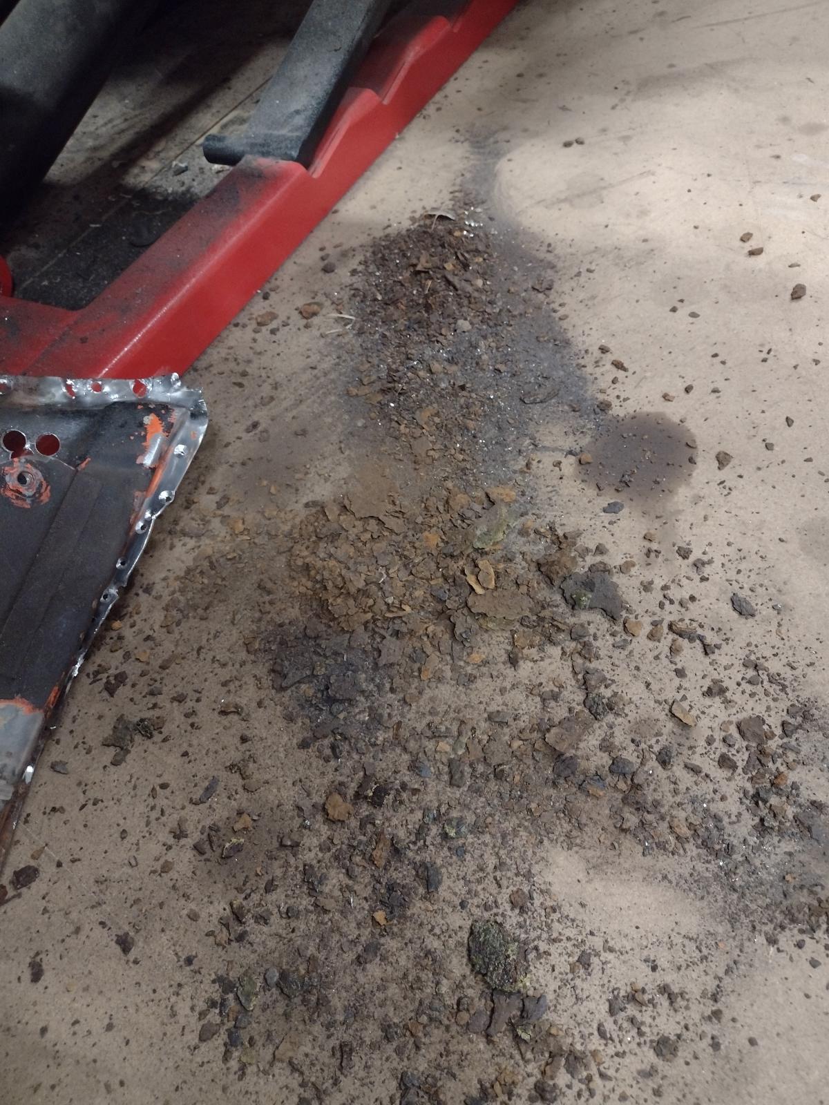

Rust behind it:
(IMG:http://www.914world.com/bbs2/uploads_offsite/www.thesamba.com-24690-1638781148.18.jpg)
(IMG:http://www.914world.com/bbs2/uploads_offsite/www.thesamba.com-24690-1638781148.19.jpg)
(IMG:http://www.914world.com/bbs2/uploads_offsite/www.thesamba.com-24690-1638781149.20.jpg)

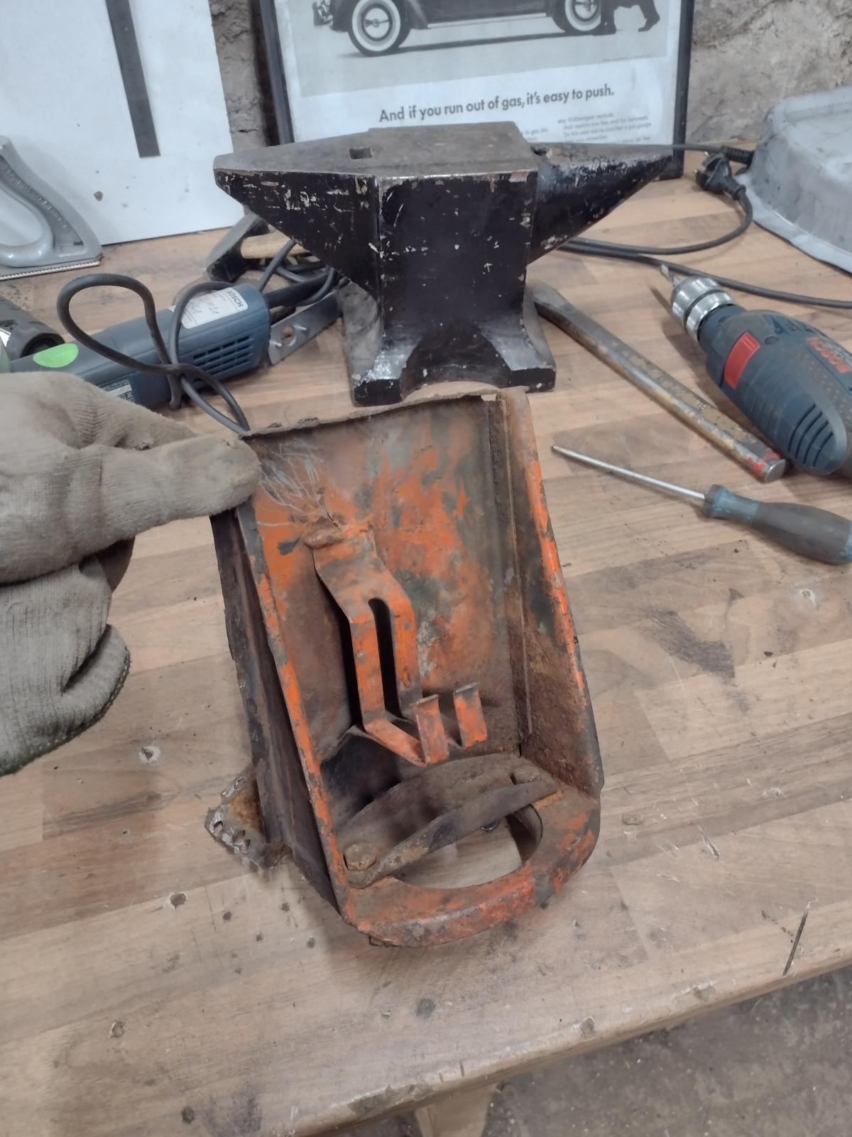

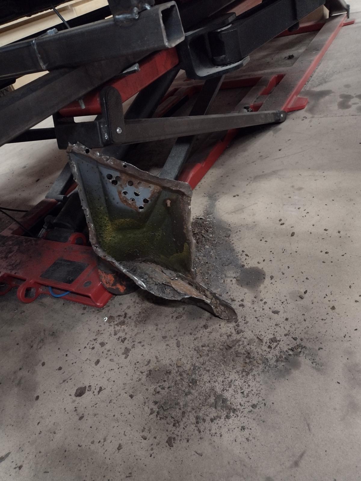

And out:
(IMG:http://www.914world.com/bbs2/uploads_offsite/www.thesamba.com-24690-1638781149.21.jpg)

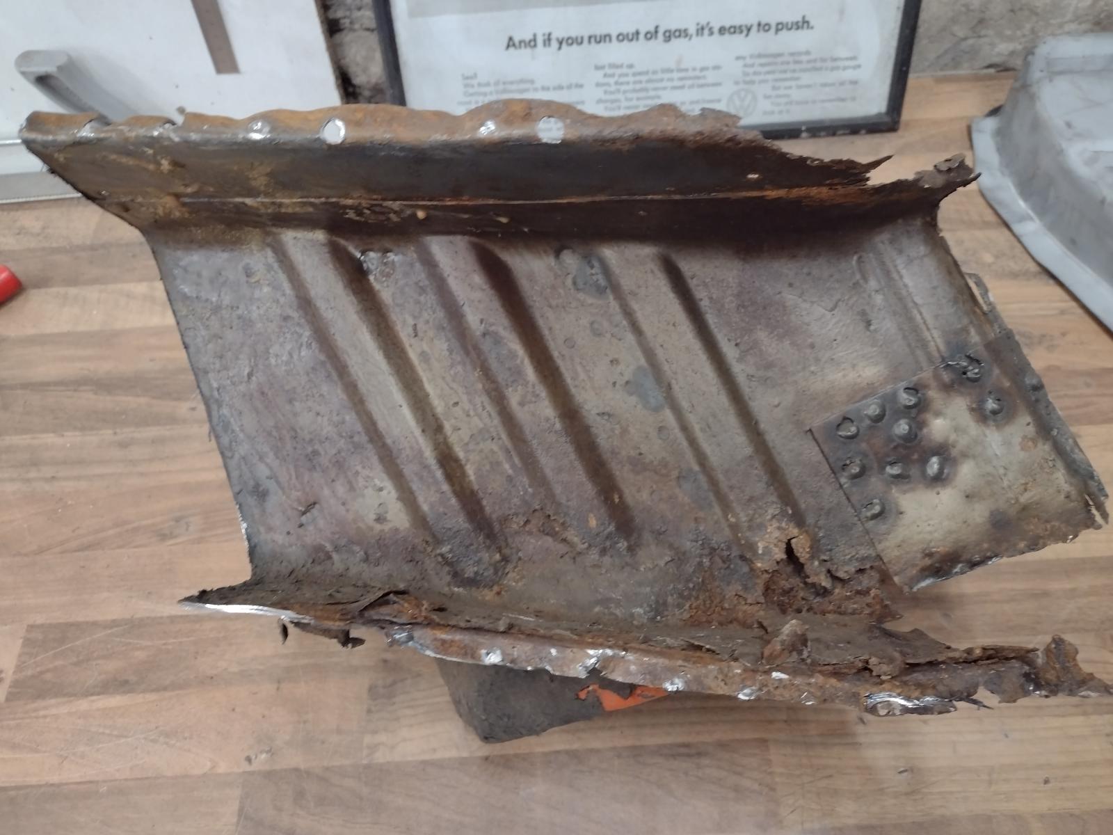

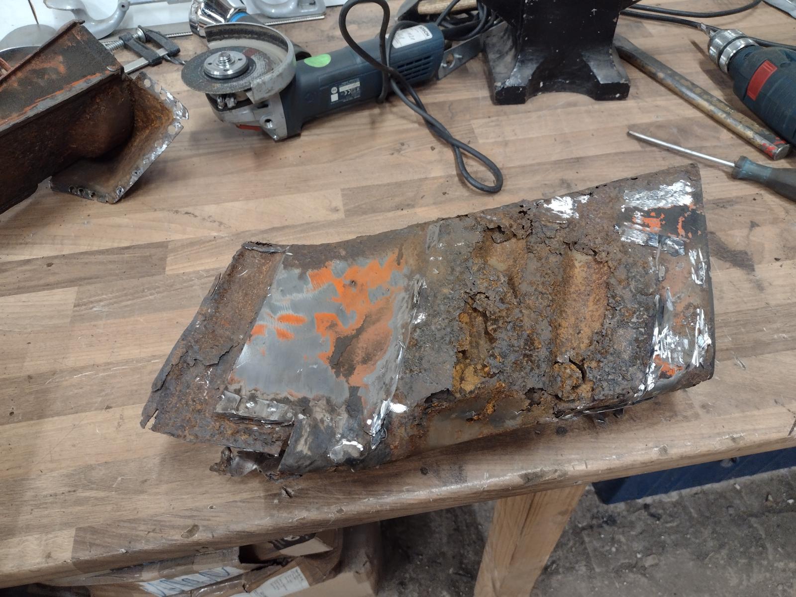

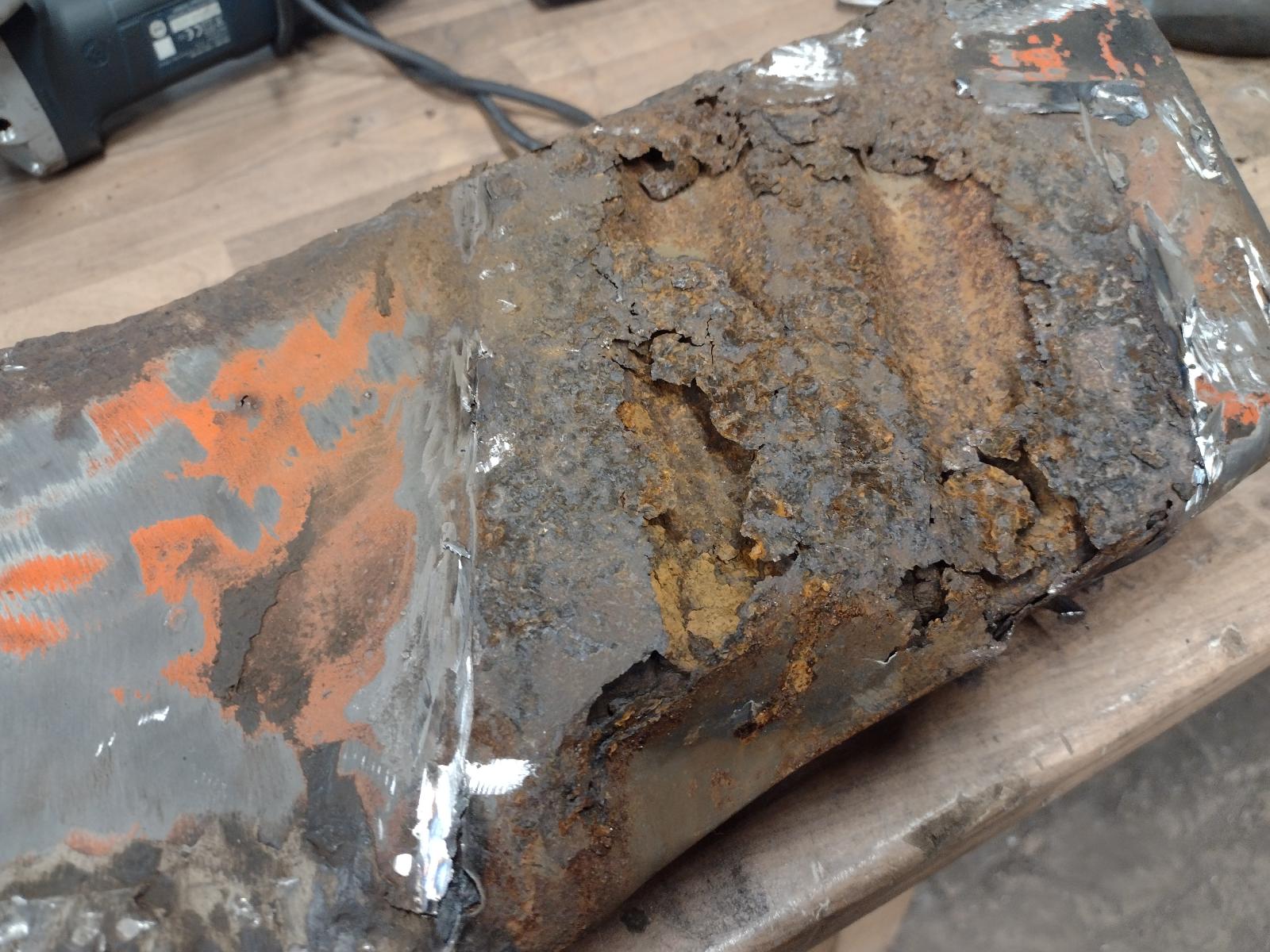

The long was really at the end of its life:
(IMG:http://www.914world.com/bbs2/uploads_offsite/www.thesamba.com-24690-1638781149.22.jpg)
(IMG:http://www.914world.com/bbs2/uploads_offsite/www.thesamba.com-24690-1638781150.23.jpg)
(IMG:http://www.914world.com/bbs2/uploads_offsite/www.thesamba.com-24690-1638781150.24.jpg)

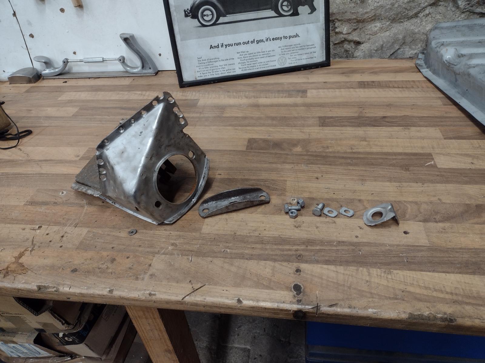

And now the parts ready for blasting:
(IMG:http://www.914world.com/bbs2/uploads_offsite/www.thesamba.com-24690-1638781151.25.jpg)
And blasted:
(IMG:http://www.914world.com/bbs2/uploads_offsite/www.thesamba.com-24690-1638781151.26.jpg)
(IMG:http://www.914world.com/bbs2/uploads_offsite/www.thesamba.com-24690-1638781151.27.jpg)

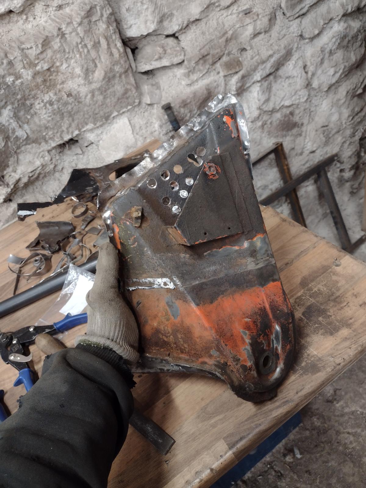

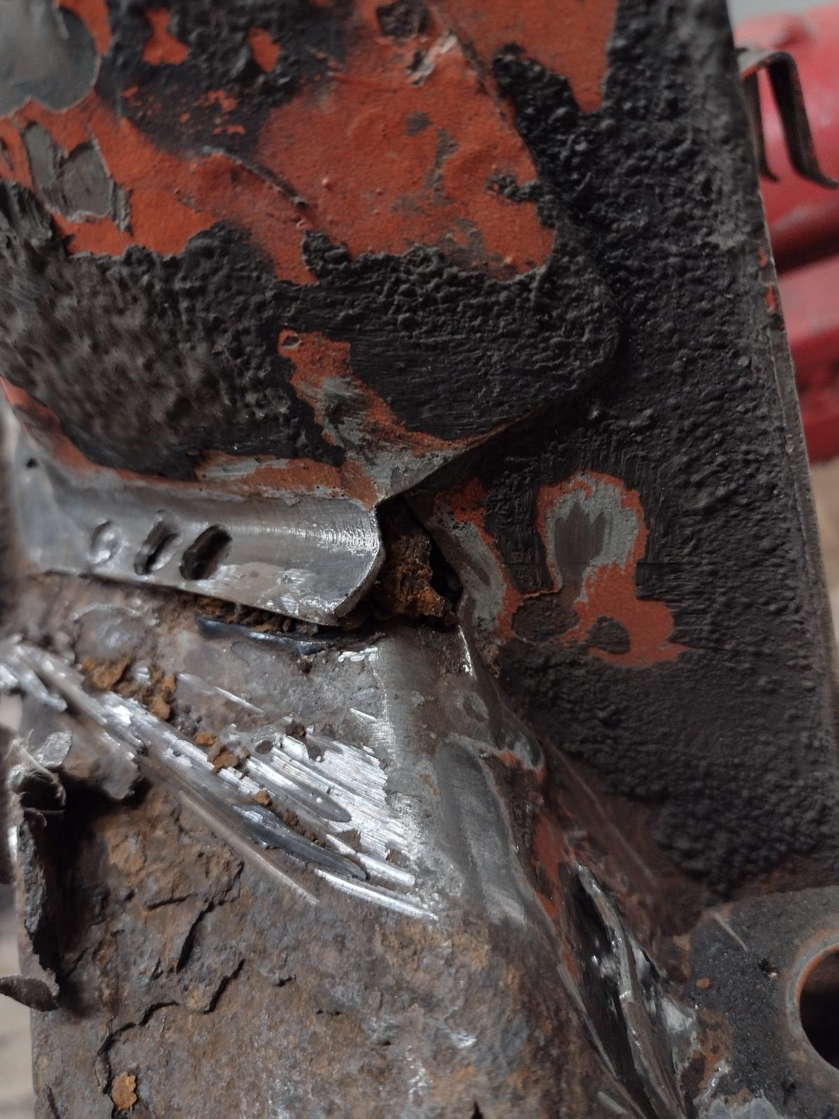

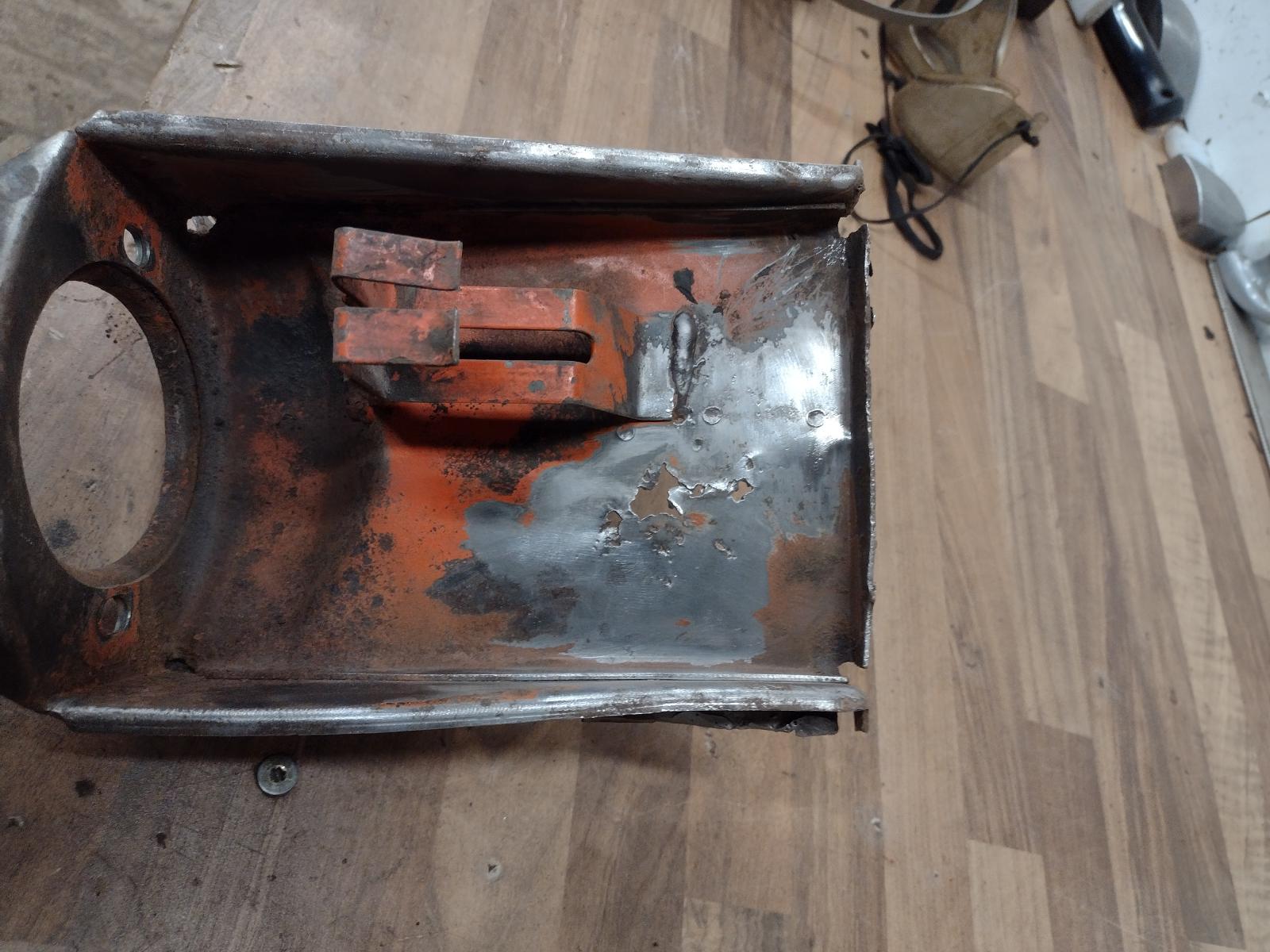

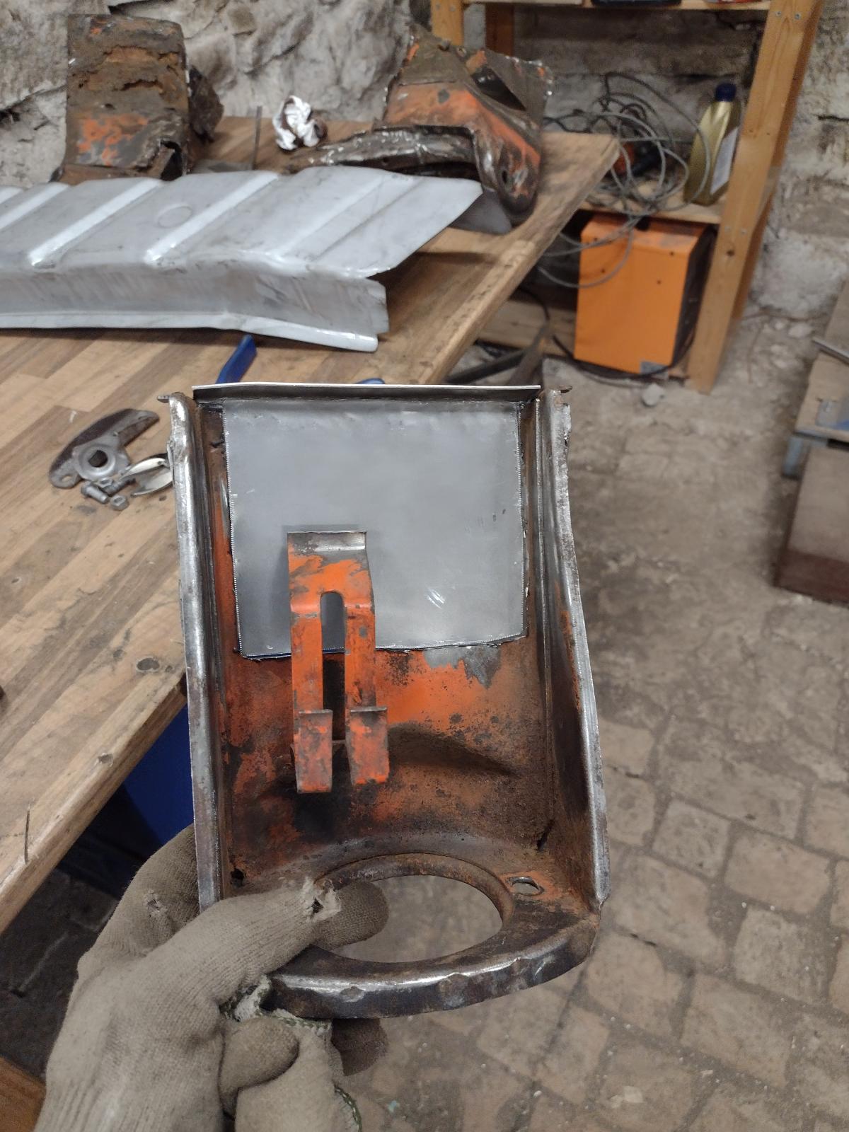

The engine mount showed some issues :
(IMG:http://www.914world.com/bbs2/uploads_offsite/www.thesamba.com-24690-1638781152.28.jpg)

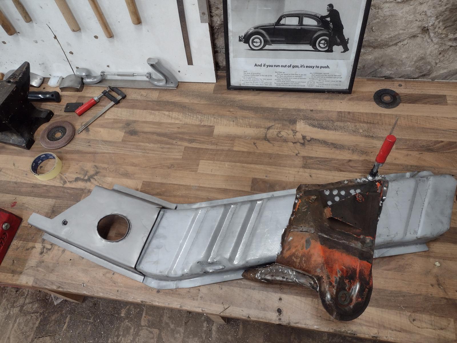

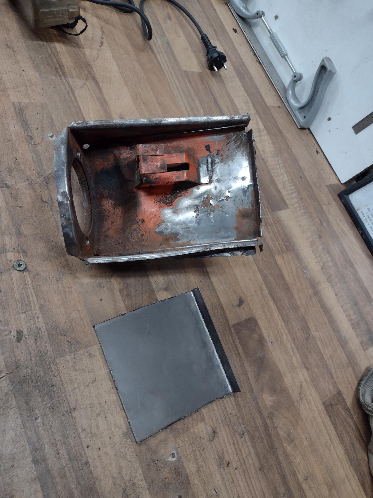

So let's fix it:
(IMG:http://www.914world.com/bbs2/uploads_offsite/www.thesamba.com-24690-1638781152.29.jpg)
Ready to weld:
(IMG:http://www.914world.com/bbs2/uploads_offsite/www.thesamba.com-24690-1638781153.30.jpg)
One picture with a hint of the color, good for the motivation !
(IMG:http://www.914world.com/bbs2/uploads_offsite/www.thesamba.com-24690-1638781153.31.jpg)
