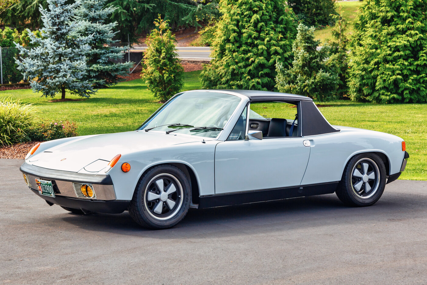

New member, long time lurker here. I'll be posting another 914-6 conversion project shortly, but posting a thanks for now for all the great info I've come across here.
I took the easy way into 914-6 ownership - I bought a completed car that was a track car whose PO had done the hard work. This car has a 3.2L engine, injected, with large riveted composite flares, and a pretty austere race-friendly interior with racing seats, roll cage, and little else - not even side windows or carpeting or panels. This car I refer to as the Outlaw - it's a middle finger to the purists and I absolutely love it.
But...I wanted a clean and pretty "cars and coffee" version. There's not a ton of value restoring the Outlaw. The Outlaw's body is fine, but it is purposely built.
I had bought a project from a local Porschephile who had too many nice projects (356, pre-73 911). his goal was originally to do a big Raby 4. He had stripped, prepped, and beautifully painted a really nice shell, and spent a small fortune getting the original bumpers and details correct. He had a set of mint Fuchs 14" wheels, bits and pieces from 2 interiors, and was really only missing the engine and some trim/interior bits. A deal was struck, trailer was hitched, boxes moved, and now it's my problem.
The conversion wisdom here seems to be to go big - 3.0l or more. But I have a big engine car. This is intended to be just a Sunday cruiser, no track time. Plus, I have access to perfectly nice prepped 2.7L that has case guards installed, a 911s cam, and the work mostly done, for a decent price, and it would sound just swell with PMOs. So I am heading this route. I am taking my time with the Pretty Car - not going to be concours but a great looking driver with super clean details, no flares, and more along the lines of an original -6 with a bit more oomph. I'll detail the suspension bits so it looks pretty on a lift, and I need to think through the oil cooling issues - it doesn't get super hot in the PNW but for a few days a year, and if I can avoid the expense of a front mounted cooler and running lines that would be just swell.
At least that's my current plan. We'll see where my budget leads. I have a good start - great primed and painted rust free shell, all the expensive body work complete, an engine lined up, and a clear vision of where I want to go.
Looking forward to the collective input and experience when I get started this winter.

davehg   Long time since I’ve upgraded the thread. Motor...   Jan 16 2022, 12:31 AM

davehg   Wow, hard to believe I've not updated this thr...   Nov 11 2023, 01:54 PM
davehg   Turning to the transmission, it was completely reb...   Nov 11 2023, 02:03 PM
davehg   For the interior, I struggled on whether to go com...   Nov 11 2023, 02:22 PM
davehg   The moment of truth on the first start up. and m...   Nov 11 2023, 02:38 PM

davehg   A few more tweaks now that I am past the break in....   Jun 25 2024, 09:56 PM
davehg   For fun, also showing its stablemate that is now c...   Jun 25 2024, 10:02 PM
