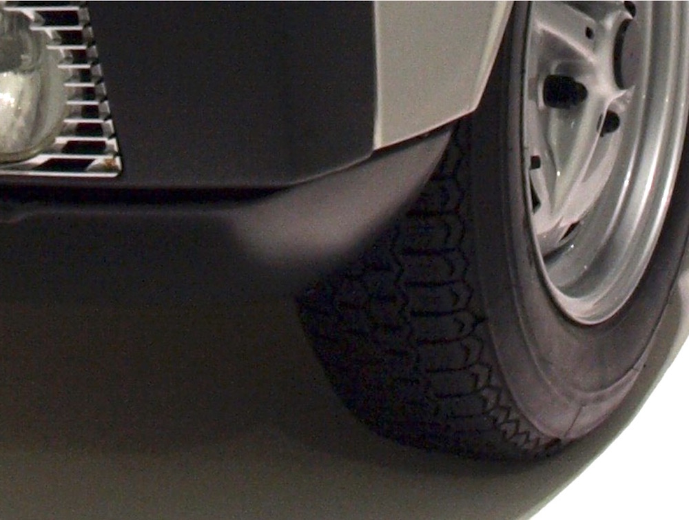

@jagalyn .
not sure how "correct" you want to be - a XZX (1975) is slightly out.
at best the last batch of 75 cars might have got them.
or you might have put a set on as replacements in the late 70s.
XZX superseded ZX.
914s had ZX (1968) fitted new in some markets.
XAS (1968) were a choice for sixes with 14 inch wheels.
attached an image i took of dr. marchant's 74 1.8 in the porsche museum 15 years ago.
don't know if they are original tyres. if not i'm guessing proper replacement originals. ZX. car is otherwise unrestored i believe. (IMG:style_emoticons/default/beerchug.gif)
