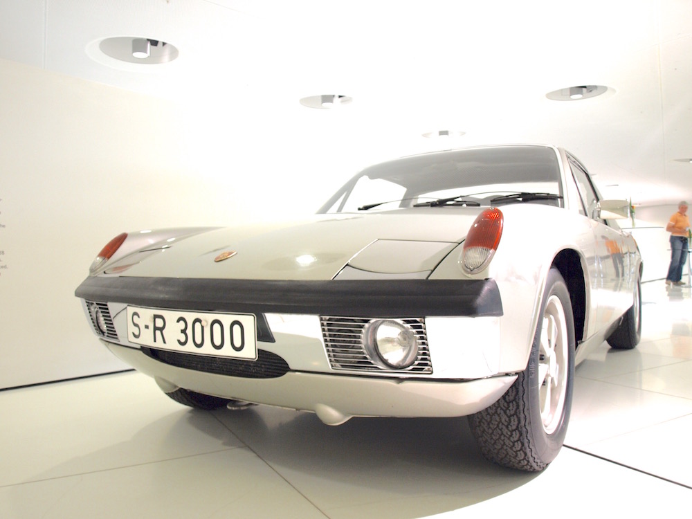

this was with photos of other 2.
dr. f porsche's 8.
was running XWX.
serious tyre for the time.
checked out prices -- i thought XAS burned a thermo nuclear hole in my wallet! (IMG:style_emoticons/default/blink.gif)
(bum steer on ZX above, period correct but michelin don't do them in the size, only the XZX in a 15 for a 914.)
