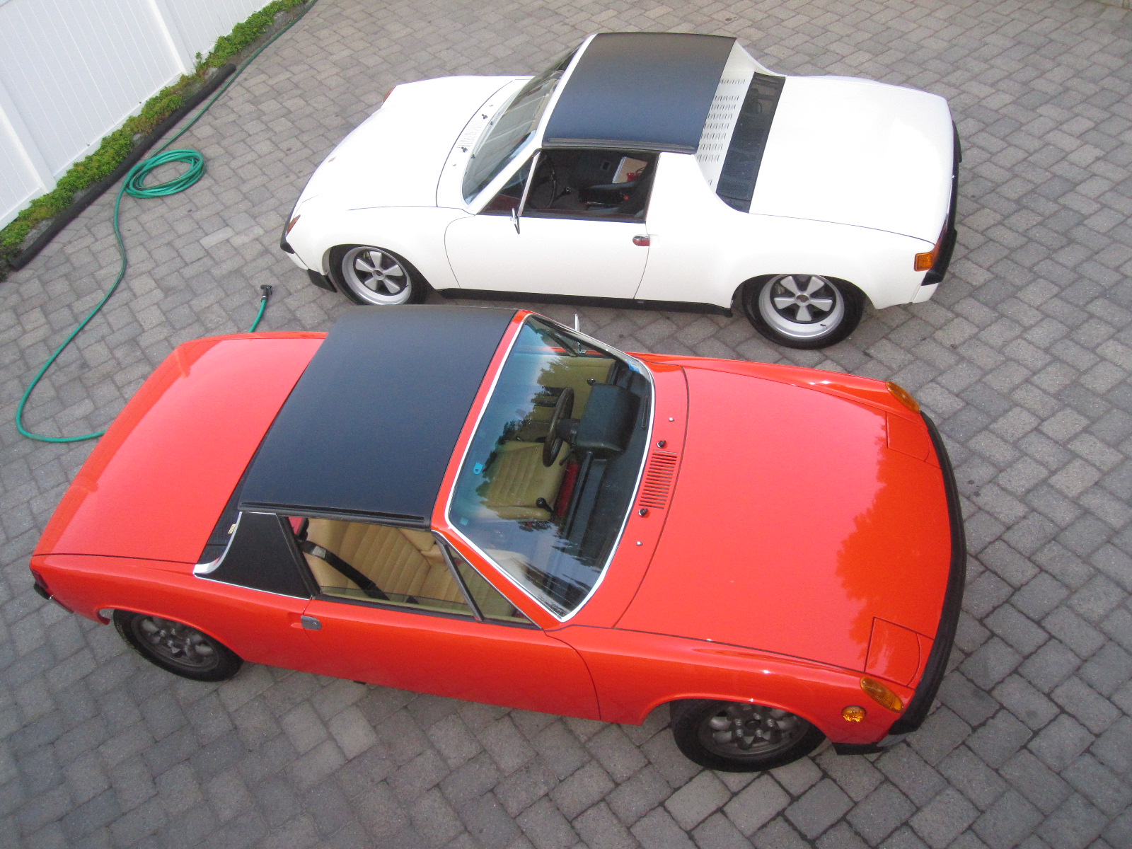

Hey Tom,
You have like-minded company close by. I'm North Jersey. My white car has many of the features you've focused on. A 3.0 is in the works right now. This is a thread that I started on the topic. I'm glad to talk anytime.
-Rory
