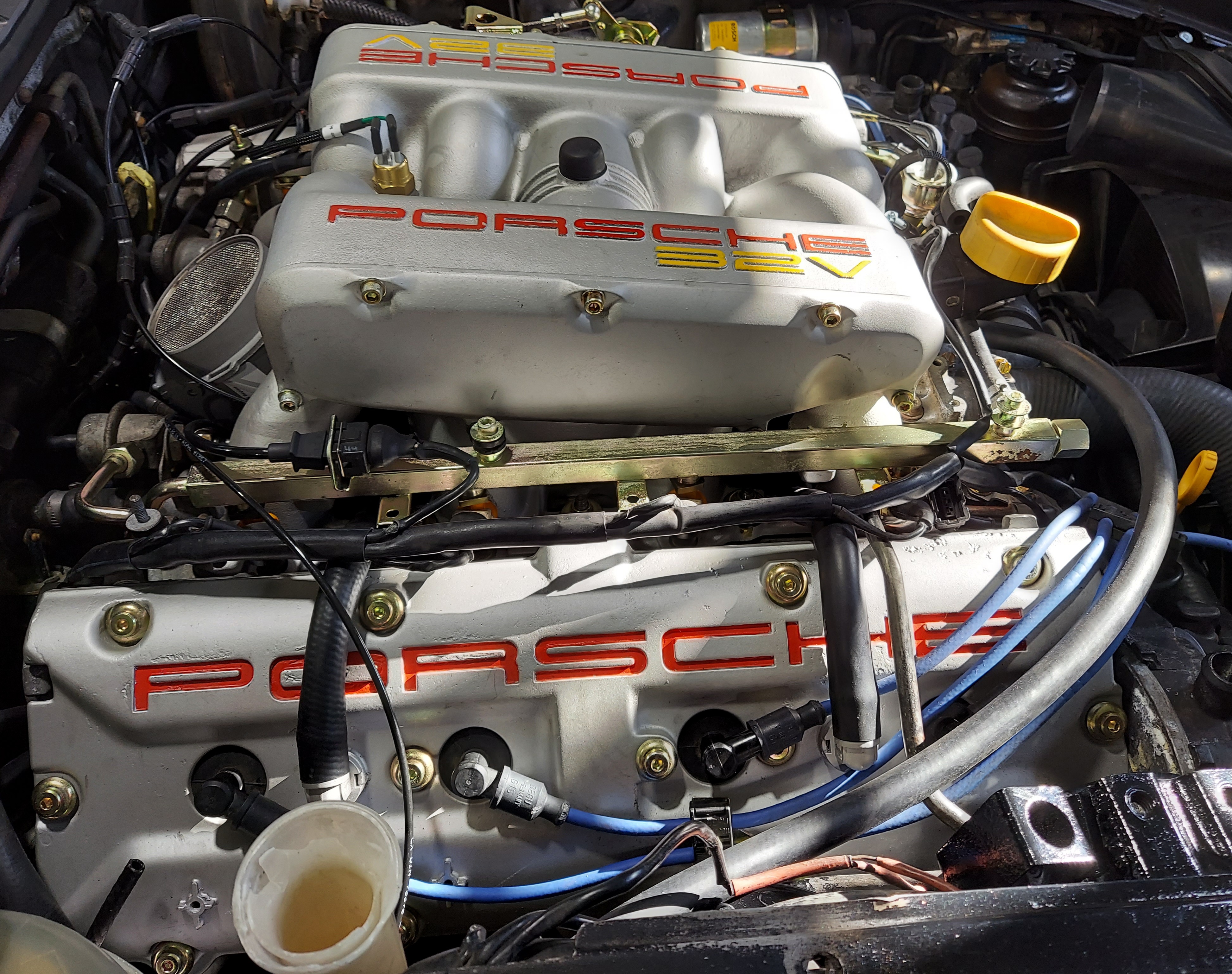

I just couldn't pass it up. Needs a new hood, engine wiring, airbox,engine fuel lines but it was so nice and so cheap I will collect parts this summer for next winter project its an 89s4Attached Image Attached ImageAttached ImageAttached Image

Big progress. I have everything buttoned up except the new FPR and the dampers. Waiting for a nicer day to allow the garage doors to be open for venting. Still need to figure out the fuel pump but I spent a bunch of time on just finishing up odds and ends.. I think I might have a leak at the water bridge which sucks but I did miss one coolant connection initially so it maybe residual. If I need to put a new o ring in the bridge what am I looking at for taking that apart? Is that intake off or?Attached Image Attached Image

mb911   Big progress. I have everything buttoned up excep...   Feb 26 2022, 04:00 PM
mb911   RE: OT bought a shark   Feb 26 2022, 04:00 PM
ddire333   nice work, looks great, water bridge can be done w...   Feb 27 2022, 06:23 AM
mb911   Well the Water bridge turns out was not leaking. ...   Mar 6 2022, 03:35 PM
