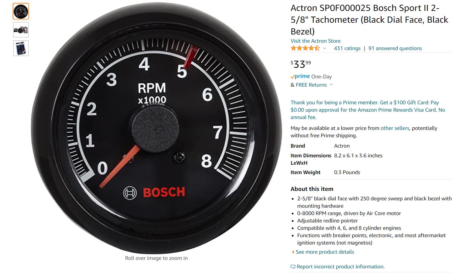

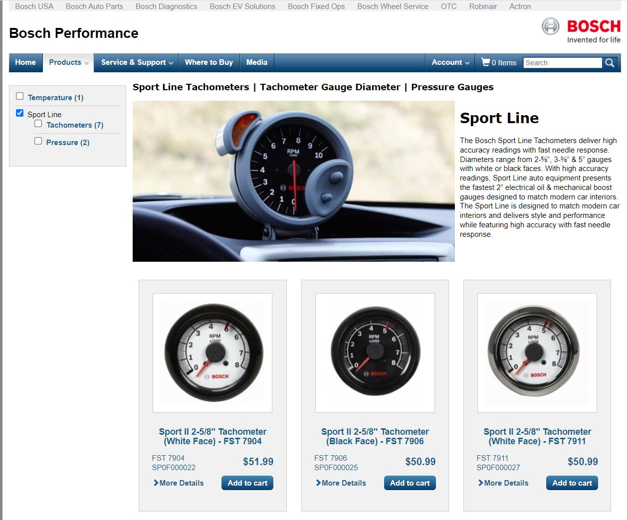

This is a screenshot of Bosch webpage showing the 3 variations of that tachometer.
FST 7906 (black face) happens to be in the mid $30 range on Amazon.
I couldn't find the FST 7904 (white face) on Amazon, and it was in the $50 range on other websites.
Order placed (IMG:style_emoticons/default/sunglasses.gif)
