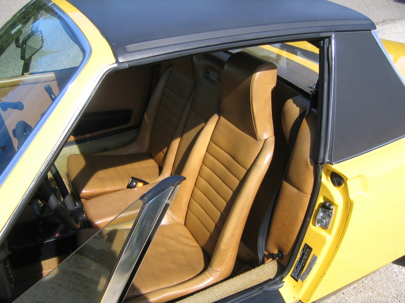

The DOT sticker I have on my door doesn't look like what I see on other 1975 914's. The PPS said my car was Equipped for California. This is what the current sticker looks like:
Was this done just for California?
Thanks,
DaveB

My 76 mostly original paint car I sold to Dax in begum that was a CA car shows the vin sticker and the misaligned silver Smog sticker for CA
Sorry that the picture is not that good but there you have it.
Bob B

and what your car is showing bob is that all cat/non-cat labels are silver.
no need to worry about the contrasting background color thing - no stamping out holes.
looks like the "turkish apprentice" was given strict instructions on how to achieve the effect.
line one up with inner door jamb. other with outer edge.
set up ex mm from bottom of vin.
despite our jokes it is pretty germanic. (IMG:style_emoticons/default/evilgrin.gif) (IMG:style_emoticons/default/blink.gif)
