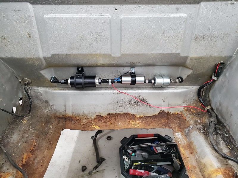

I got the new fuel system plumbed and ready. Ran a fused wire off number 8 fuse, ya know, for extra fuseage. Got rid of that horrid AC box. Which leaves me with a gapping hole that will receive a sheet of aluminum (temporarily). Also got my horns working so that's a good thing. Engine could be here tomorrow.
