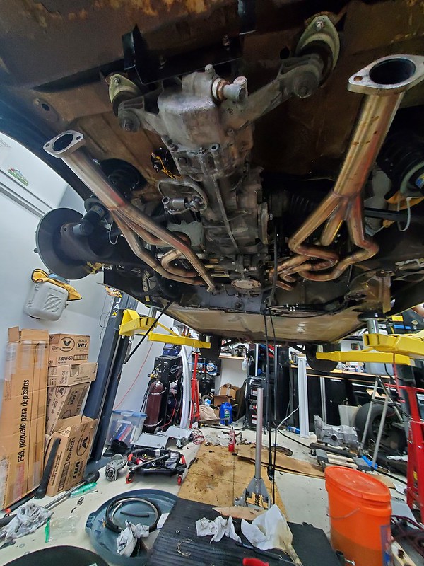

Hey all - not sure if you all were aware that I have been in the middle of a conversion build since last year. Well the time finally came, or should I say a fire under my butt, to get me to push for a completion. By completion I mean a running/driving 6. Quick back story. Bought the car from a member 74 2.0. Already had glass flares, 5 lug, and an overheating engine. Dropped that out as I had a 2.7 waiting to be finished. Collected parts for the engine. Collected parts for the conversion. Sat back and waited for it to build itself, it didn't. Finally bought my tix for Okteenerfest so now I'm forced to get it done in time. I recently posted up an extensive to do list.
She won't be a show winner, but she may just get me there.
Here is the current state of affairs.
2.7 - ITB twin plug EFI
(IMG:http://www.914world.com/bbs2/uploads_offsite/live.staticflickr.com-18763-1628735514.1.jpg)
(IMG:http://www.914world.com/bbs2/uploads_offsite/live.staticflickr.com-18763-1628735515.2.jpg)
(IMG:http://www.914world.com/bbs2/uploads_offsite/live.staticflickr.com-18763-1628735515.3.jpg)
(IMG:http://www.914world.com/bbs2/uploads_offsite/live.staticflickr.com-18763-1628735515.4.jpg)
(IMG:http://www.914world.com/bbs2/uploads_offsite/live.staticflickr.com-18763-1628735516.5.jpg)
(IMG:http://www.914world.com/bbs2/uploads_offsite/live.staticflickr.com-18763-1628735516.6.jpg)

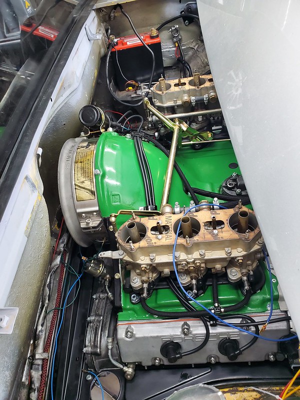

Engine is in!
First start video. Running good. Just need to hook all the cables back up, reattach shift rod, adjust clutch and throttle, reattach and torque axles, little tidying up and she should be good for her maiden voyage. Got to this point last year prior to Okteenerfest only to be stunted by some major oil leaks.
