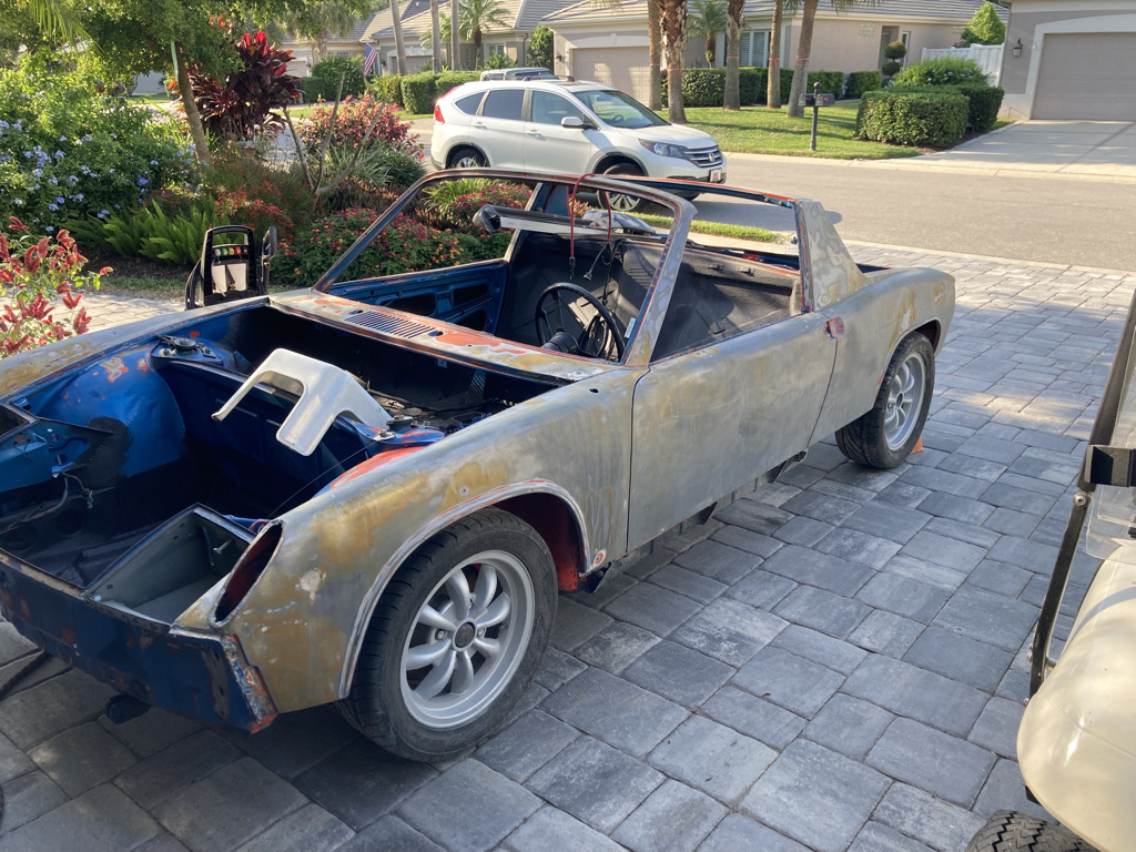

Hello all
New project. 1970, no rust other than surface rust from 38 years in the Arizona desert.
I am going to convert it to electric.

The car goes to the paint shop on 6 June. I think we are going with Porsche Murano Green, from the 80's. Everything else will bedliner black.
Car weighs 1200 lb empty (it is around 570# in front and 630# in the rear), including the wheels, front and rear lids, rocker panels and targa top-no glass, no powertrain. no seats. I sanded all of the 40 year old bondo off, which was cracked. Undercoated everything with Second Skin Spectrum.
Car started out as orange. someone resprayed everything in blue. Tough getting all the blue painted areas prepped sufficiently for new paint.
