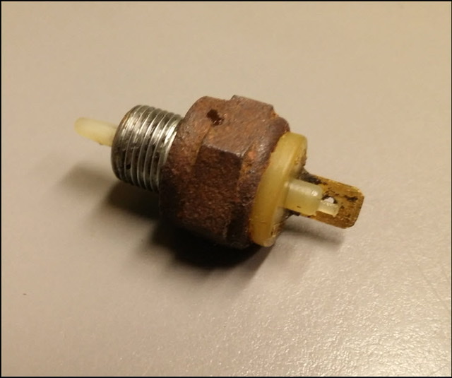

Bob and I bled the brakes Sunday and they work fine, fluid level is high. While bleeding the resivoir ran real low once.
Today, I just noticed the re light blinking even with the parking brake handle fully down. IIRC, there’s a reset button? But I don’t remember where it is. Attached image(s)

I turned the front wheels full right but didn’t see it; does the belly pan have to be removed 1st ?
Here’s a pic of what I’m looking for….. Attached image(s)

NARP74 I have also had my parking brake button get flaky.... Jul 18 2022, 09:40 AM
troth It should have a rubber cap over it. Jul 18 2022, 11:35 AM
emerygt350 It's visible through a small area where your t... Jul 18 2022, 11:45 AM

sportlicherFahrer Shouldn't. Depending on ride height you might... Jul 18 2022, 12:20 PM
jim_hoyland Took the wheel off and found the rubber cap had to... Jul 18 2022, 01:14 PM
jim_hoyland Mission accomplished :) still gotta get the car ... Jul 18 2022, 02:05 PM
