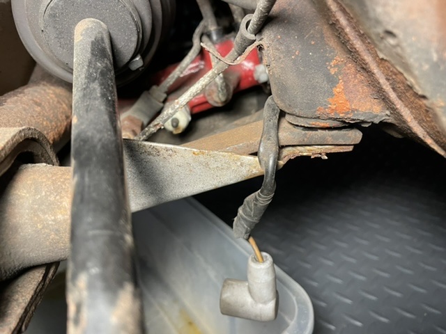

Bob and I bled the brakes Sunday and they work fine, fluid level is high. While bleeding the resivoir ran real low once.
Today, I just noticed the re light blinking even with the parking brake handle fully down. IIRC, there’s a reset button? But I don’t remember where it is. Attached image(s)

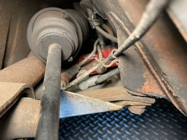

Took the wheel off and found the rubber cap had to reach in with long needle nose plier to get it off.
Then I pushed the reset button. Problem now is I don’t have enough room to reach in to put the wire and cap back on. And, the bolts holding the pan on are frozen. Attached image(s)
