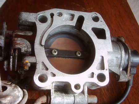

I can't believe I didn't see this thread before... (IMG:http://www.914world.com/bbs2/html/emoticons/wacko.gif)
Anyways...I'm also debating a IR or plenum system for my 2.7/4.
A Honda Accord 2.0 FI TB....at 64mm it's huge compared to a 914 TB. Not too much crap on it, has an idle bleed screw, but it does rotate opposite from a 914 TB, so I'd have to get a new TPS.
