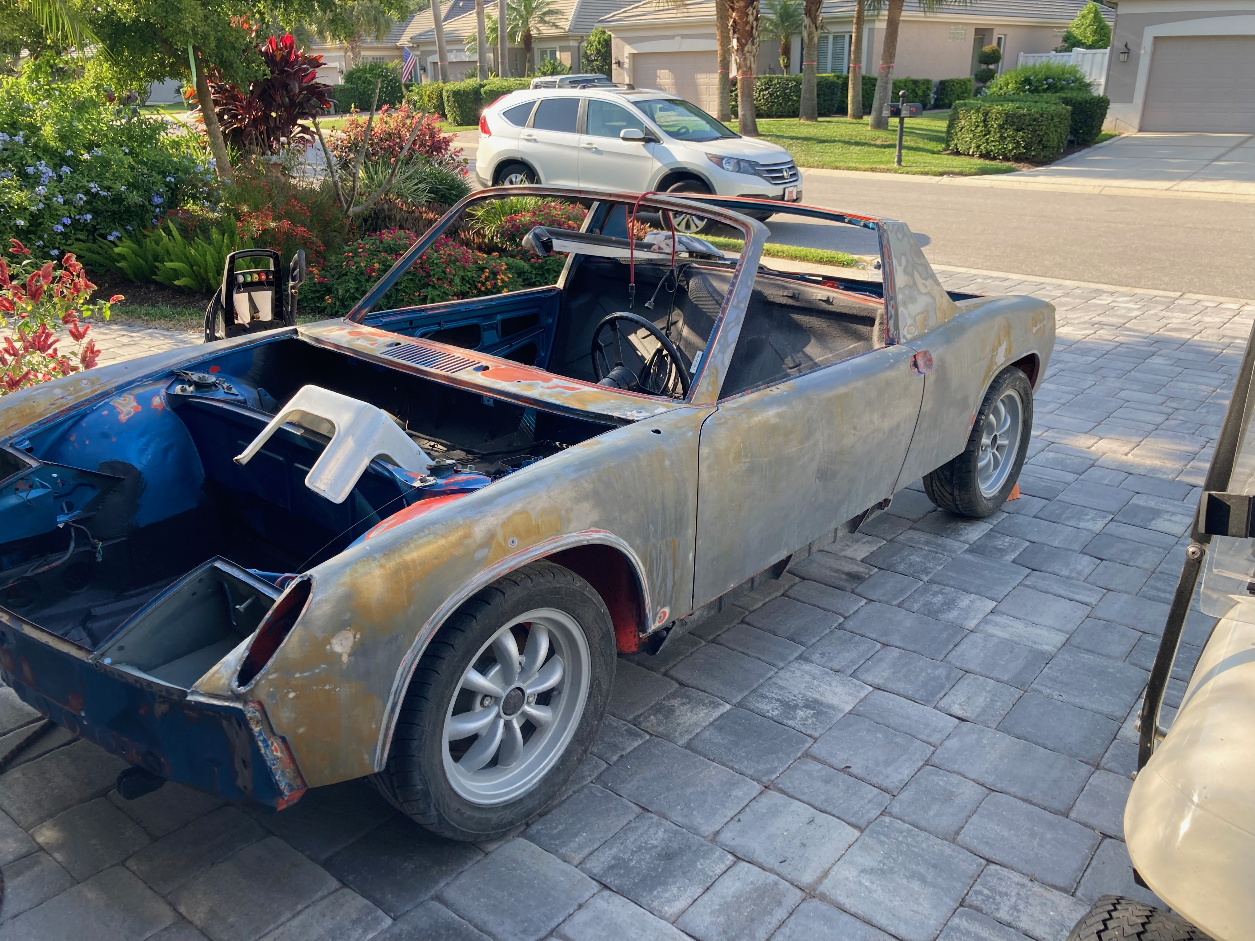

New project. 1970, no rust other than surface rust from 38 years in the Arizona desert.
I am going to convert it to electric.
This is an upload test:

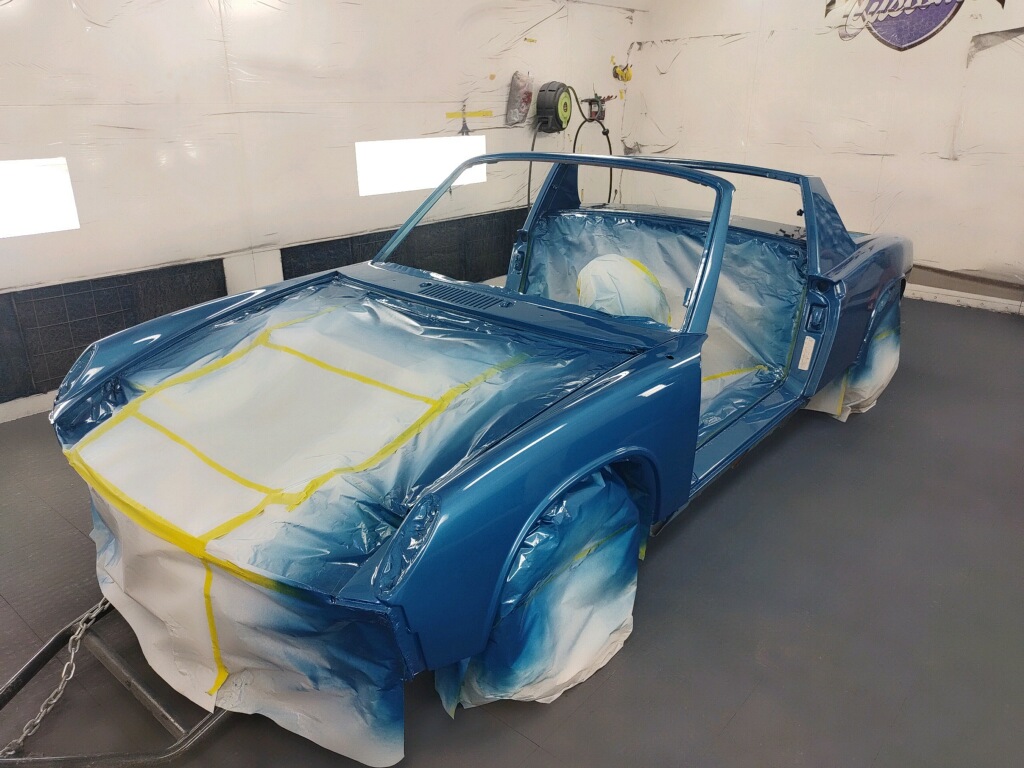

Short update: Got this from the painter today. Evidently there are a couple (at least) of Porsche Murano Green, so we came up with this instead. Everything not shiny and blue/green is bedliner.
