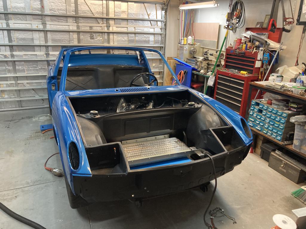

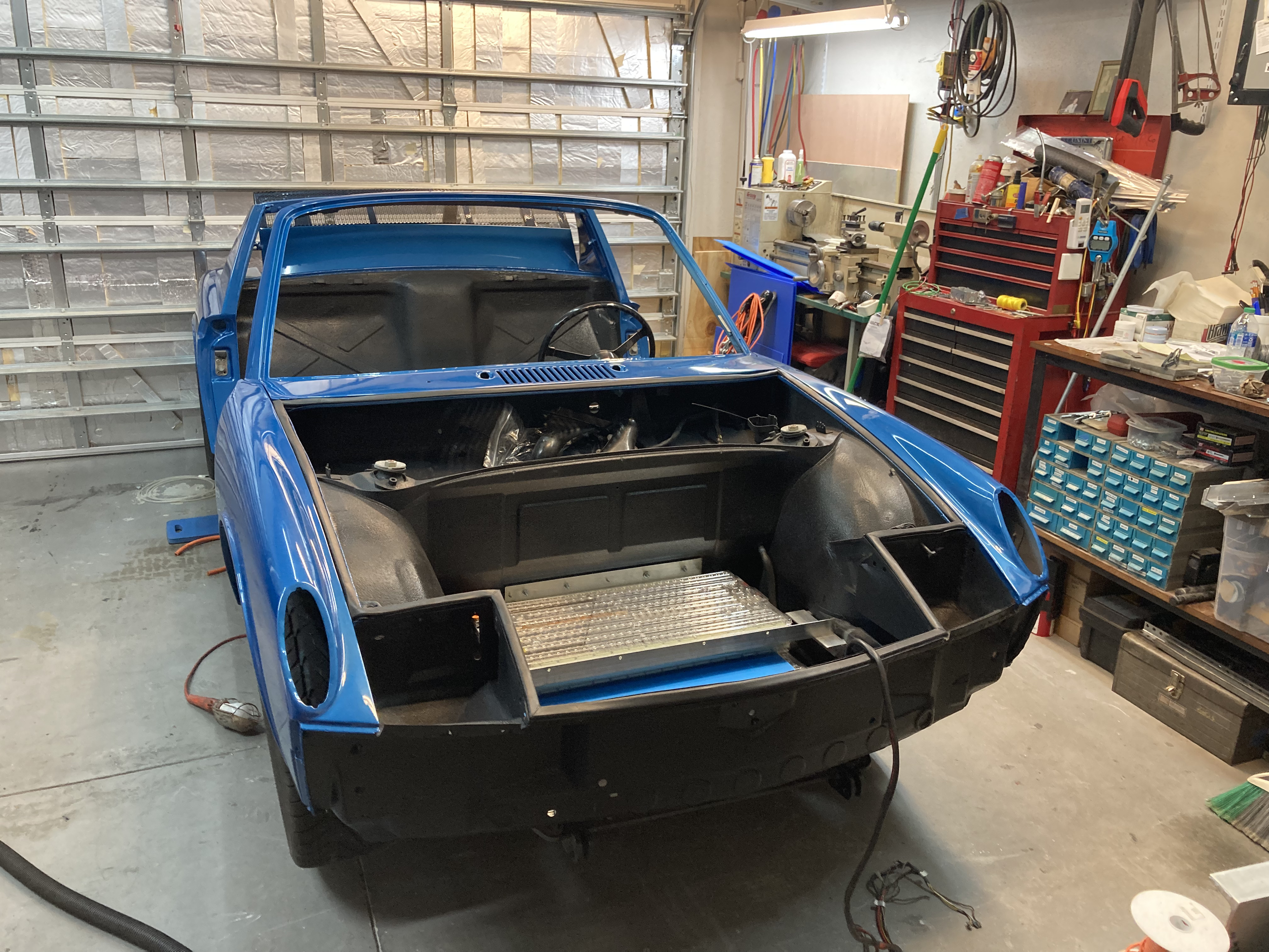

Quick progress report:
6 of the 7 Tesla modules are in. I managed to get two 2/0 wires in the tunnel.
Motor is mounted on the gearbox. I did install the Quiafe TBD. The charger is laid out, but I have to fab some brackets for it. No cooling system yet.

pek771   Quick progress report: 6 of the 7 Tesla modules ...   Sep 1 2022, 07:05 PM
pek771   Doesn't take up much room.   Sep 1 2022, 07:08 PM
