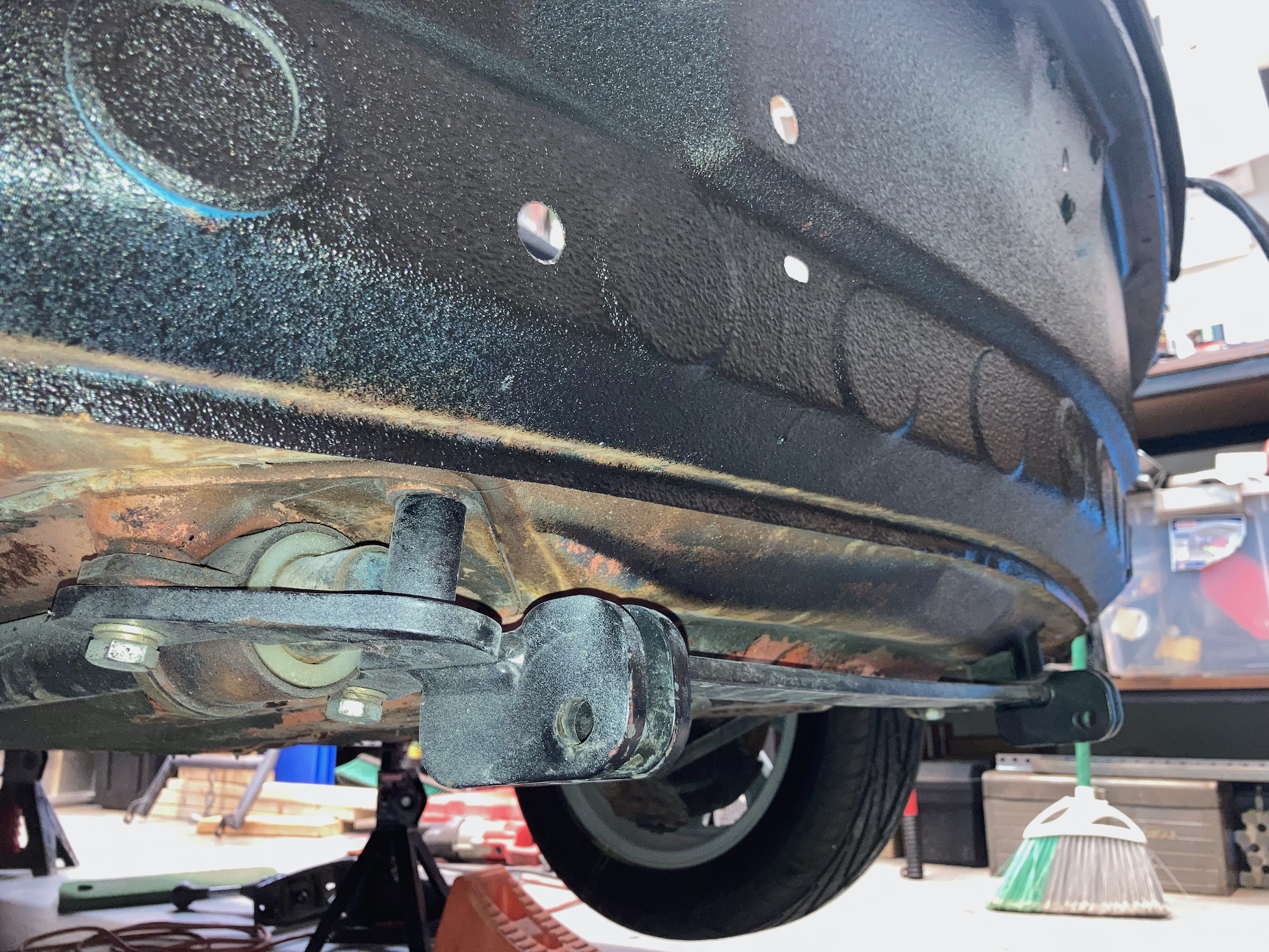

DRPHIL914   @pek771 what tow bar did you use? the one on th...   Sep 2 2022, 07:57 AM
pek771   Phil, I got that hitch plate from 914Rubber. It ac...   Sep 2 2022, 10:00 AM
