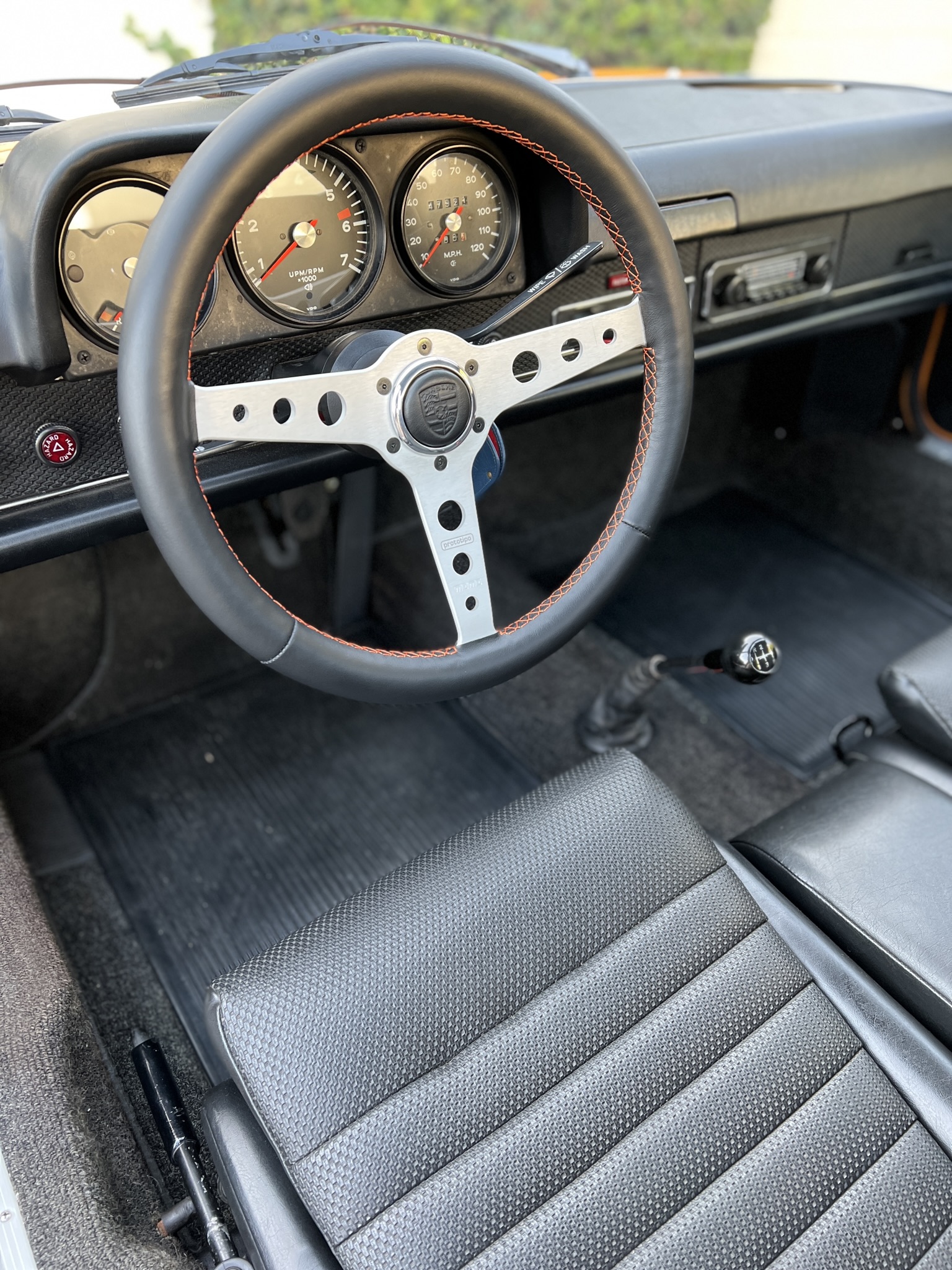

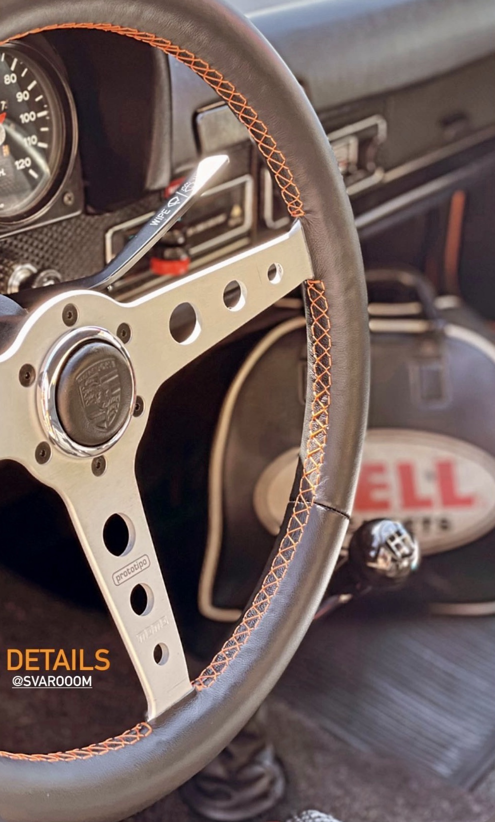

Here is my newly added Momo 370mm. Size is factory stock! Had the wheel custom stitched and redone leather. Love it!

Varooom   Here is my newly added Momo 370mm. Size is factory...   Nov 2 2022, 04:35 PM
GreatPumpkin   Here is my newly added Momo 370mm. Size is factor...   Nov 2 2022, 04:46 PM
Varooom   Here is my newly added Momo 370mm. Size is facto...   Nov 3 2022, 11:02 AM
Cairo94507   Very nicely done- that looks great. :beer2:   Nov 2 2022, 05:05 PM
