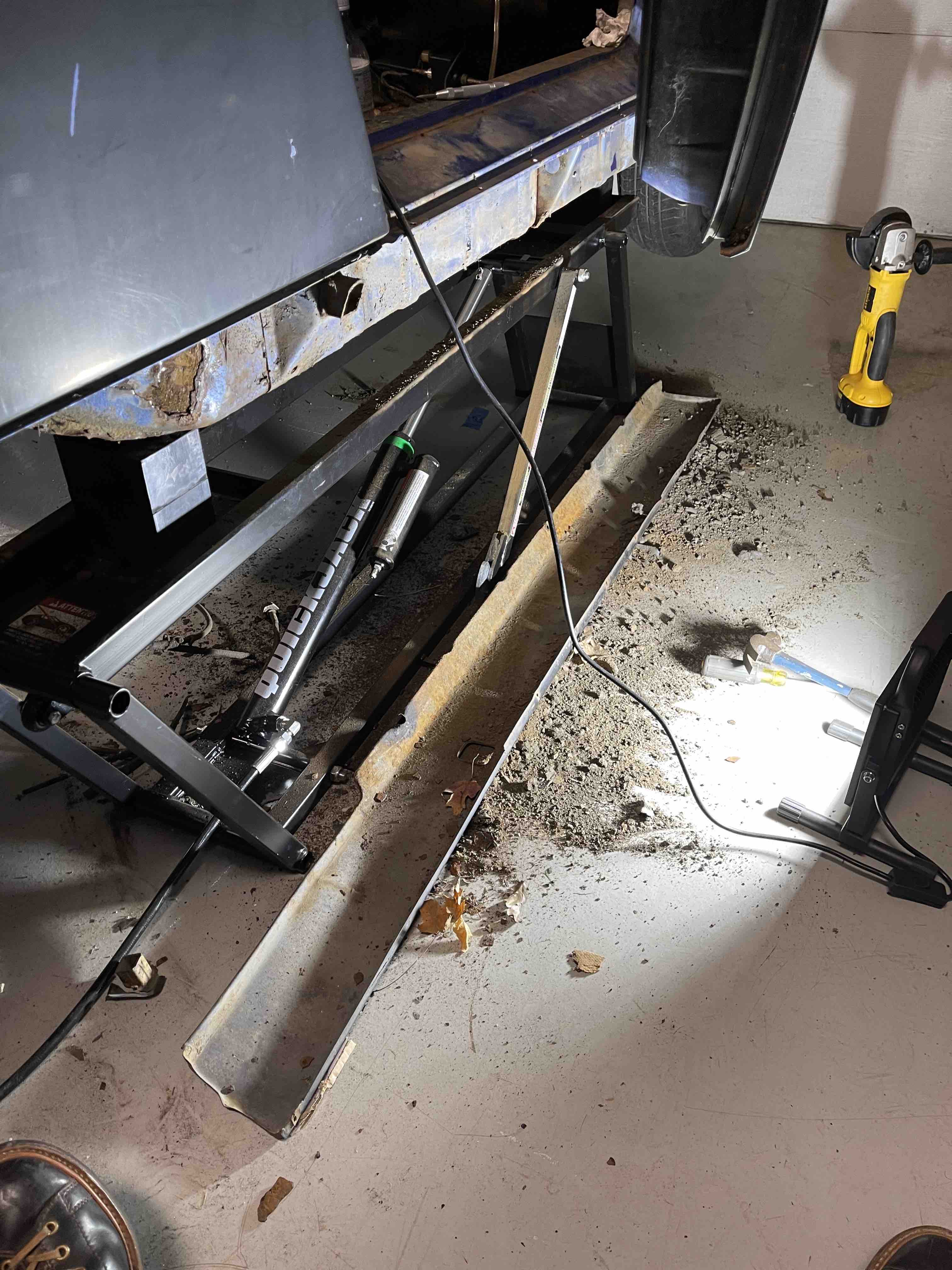

I recently got a Quickjack 7000 TLX. I need the long X model to reach the jack points on my other vehicles. But I have failed to lift the 914.
My first attempt had the Quickjacks in the "official" positions, i.e. with the lower base pivots forward. Note this is not what I consider safe for 911s and probably for 914s, since the car center of gravity can end up outside (behind) the end of the lower base.

I use two of the pads interlocked. That allows the quick jack to contact the body before it contacts the tires.

76-914   Bob, It has been pointed out to me that those aren...   Dec 12 2022, 09:29 PM
mepstein   Bob, It has been pointed out to me that those are...   Dec 12 2022, 09:38 PM
Robarabian   You should have the pinch weld rubber pads. You ca...   Dec 12 2022, 09:37 PM
Freezin 914   I have the QJ 5000, it is tight by the wheels, but...   Dec 12 2022, 10:05 PM
914sgofast2   I have the 5000 model too and it is finicky to get...   Dec 12 2022, 10:21 PM
bandjoey   Do not try to flip the lift sideways. As it lifts...   Dec 12 2022, 10:32 PM
SirAndy   You can use the engine crossbar ok. Only if it is...   Dec 12 2022, 10:53 PM

mlindner   On both front and rear I use a larger board over t...   Dec 13 2022, 05:26 AM
Retroracer   Seconded (thirded?) for NOT putting any significan...   Dec 13 2022, 08:22 AM

DaveB   I use two of the pads interlocked. That allows the...   Dec 13 2022, 11:28 AM
PanelBilly   I use a 2x6 on each side to make it longer.   Dec 13 2022, 01:56 PM

RKramden   Cut a slot in a short piece of 4x4 it straddle the...   Dec 13 2022, 05:03 PM

The Double S   I have the 7000SLX which I had to use sideways for...   Dec 13 2022, 05:59 PM
bkrantz   Thanks, everyone. I agree about the risks of usin...   Dec 13 2022, 08:05 PM
