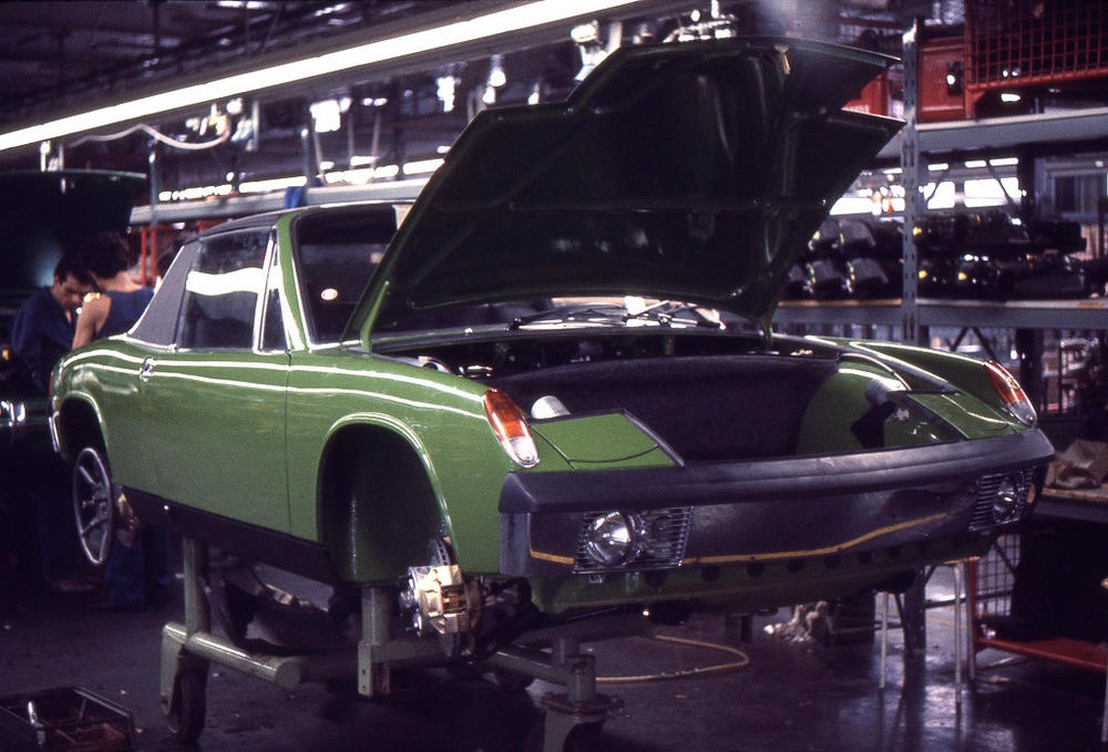

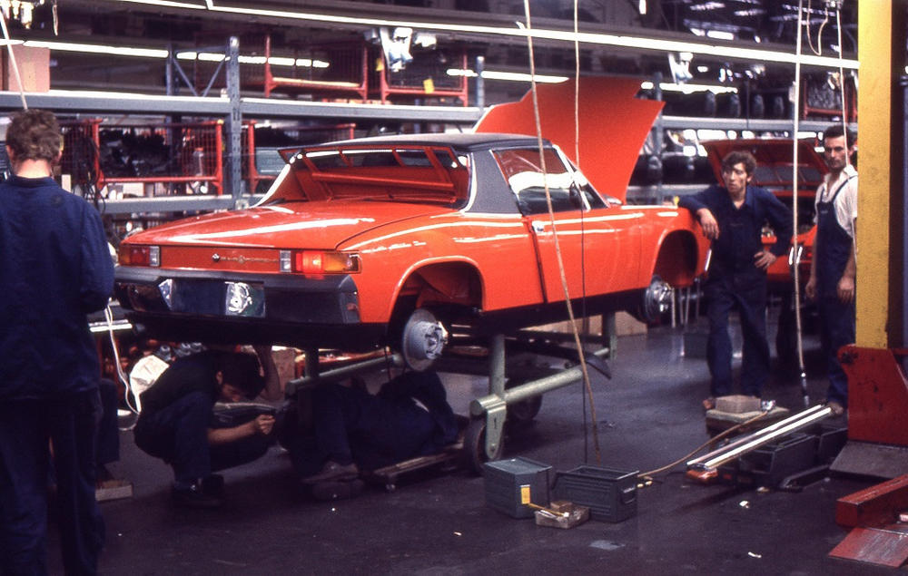

checking out these old manufacturing photos, seems to me porsche at least were using the donuts to sit the 6 body shells on cradle carts at stuttgart.
or am i not seeing this right ?????
looked at some karmann factory photos of 914 production line.
karmann did not seem to do this. overhead cradles and sled carts seemed to be a different set up for supporting the bodies during manufacture.
donuts were some kind of porsche thing for the 6s?
if they were they must have been able to support weight of car but maybe load is spread correctly by engagement with a designed fitting and the donut merely alligns it. but its not such a concentrated point load? dunno?

The factory always used all 4 donuts to either hang the chassis from the overhead conveyor belt or when on dollies.
They also didn't have the full weight of the fully assembled car until the very end of the production line.
Again, if you actually look at the location of the 4 donuts and you look at what's on the other side of them, you can see why jacking from them is a bad idea.
In the front, it's just the sheet metal of the front floor pan. It will buckle. Seen it many times.
In the rear, it's just the sheet metal of the small triangle. Seen those buckled many times as well.
