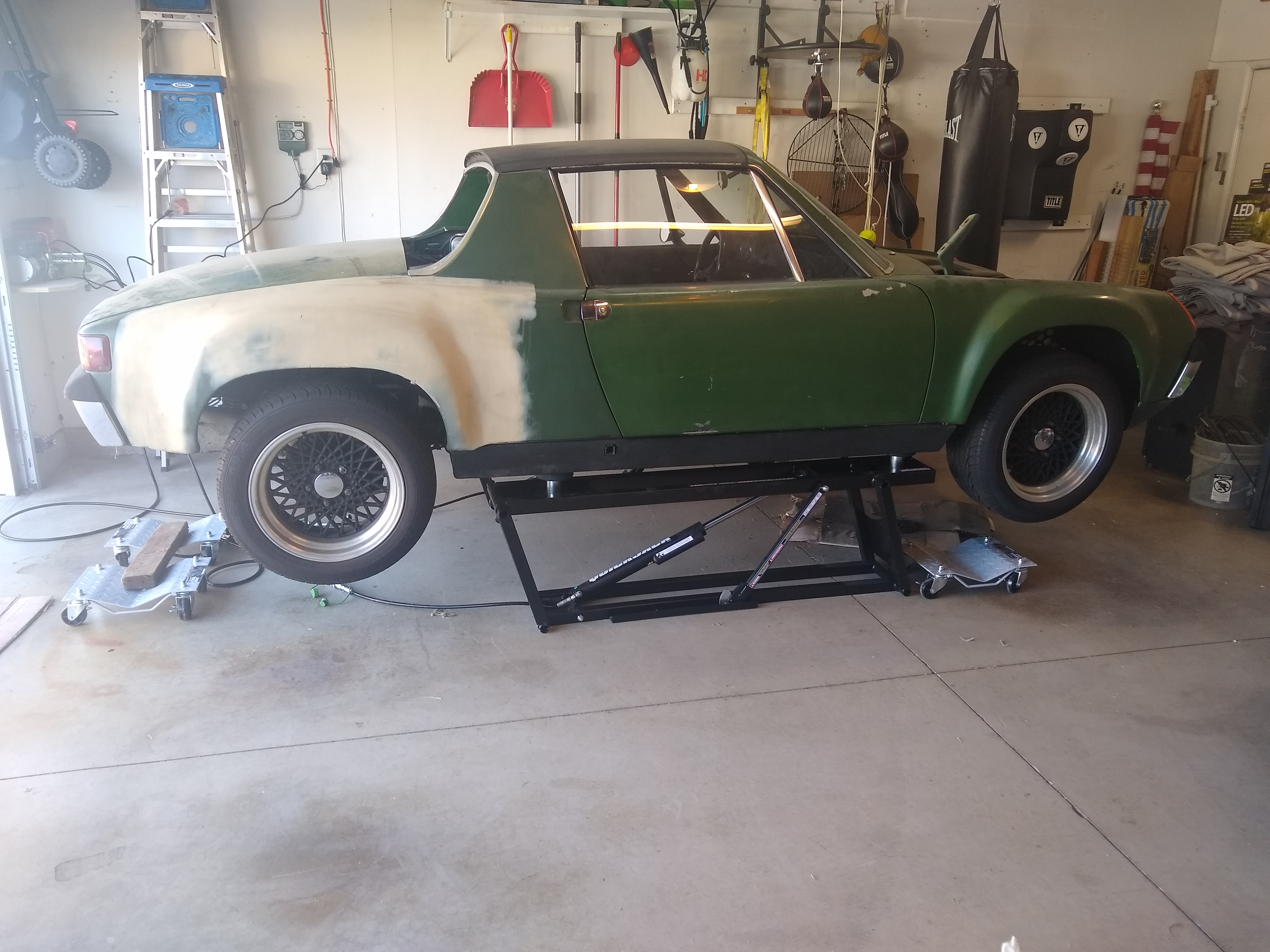

I have the 7000SLX which I had to use sideways for my wife's Honda Civic because I was having issues placing the blocks. Still very tight sideways but worked as needed. That and the pinch weld idea seems like the safest solution.
Below is a picture of my car on the 7000SLX. I bought a set of 5000TLX frames, that I haven't setup yet, which is supposed to have a 3 inch taller lifting capability. I would imagine the frames are longer for that reason and is why they are making contact with your tires.
