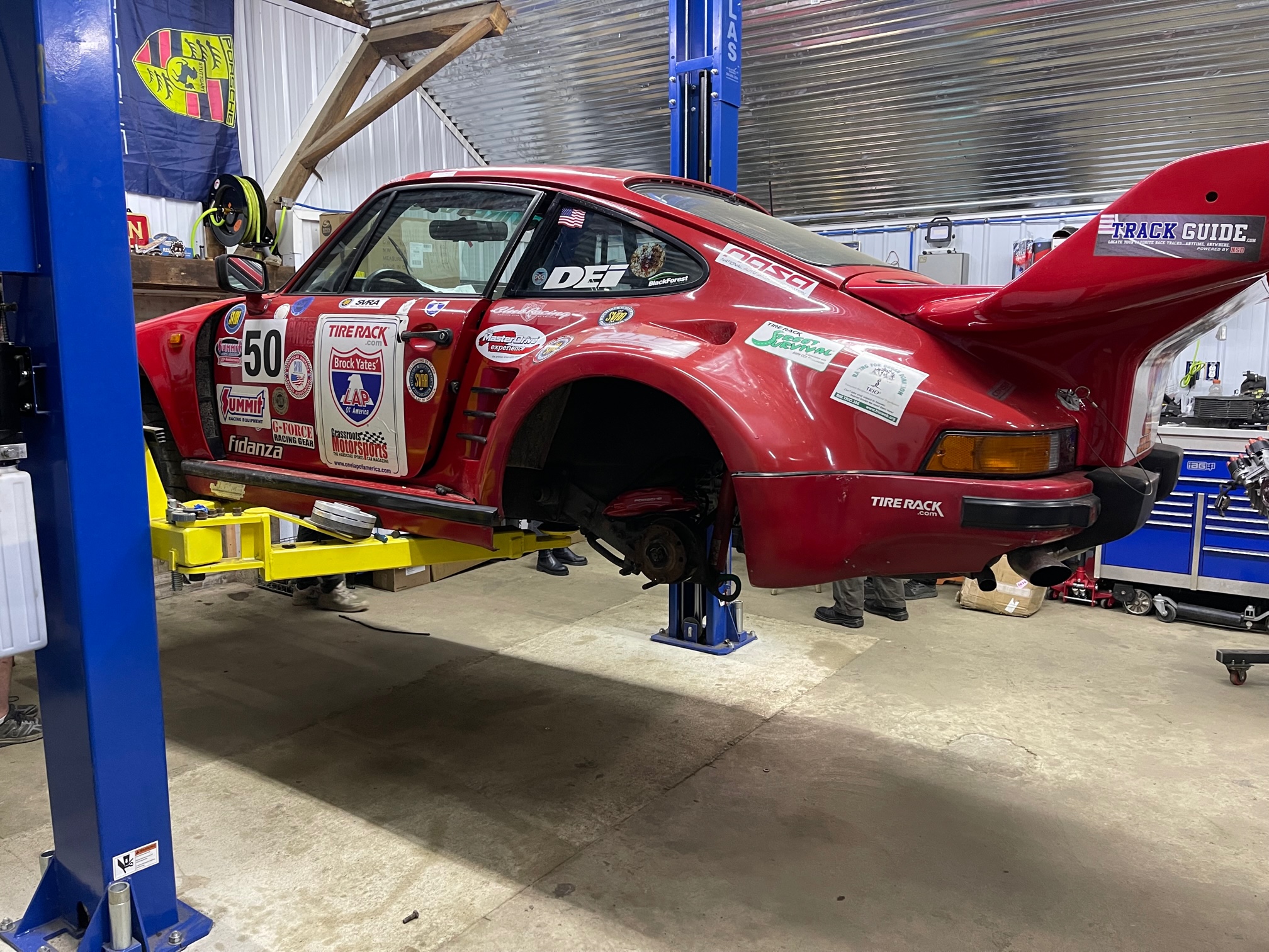

Our lift is pretty sturdy.

Don’t saw horses make it a little difficult to work under a car? Part of the attraction of a lift is getting the car in the air in seconds.
