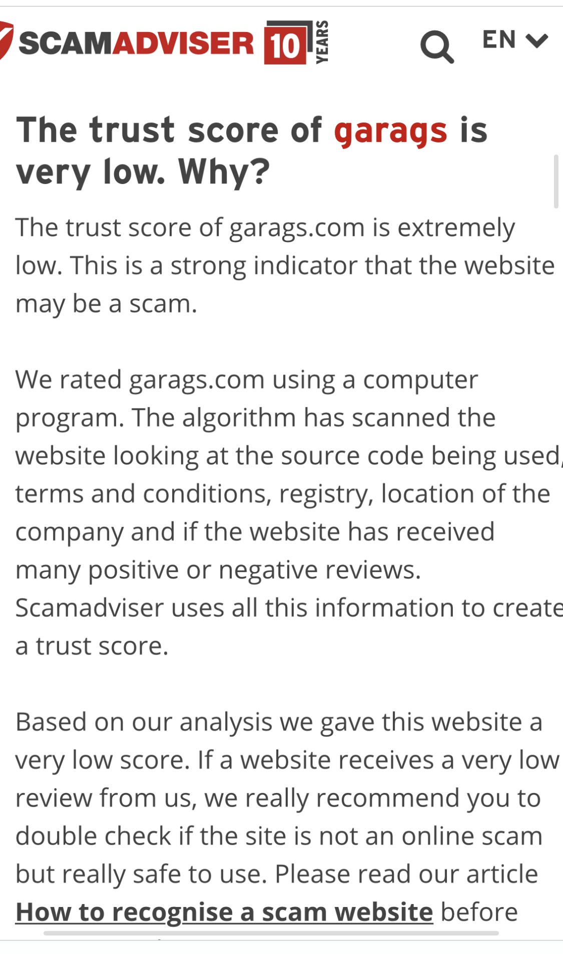

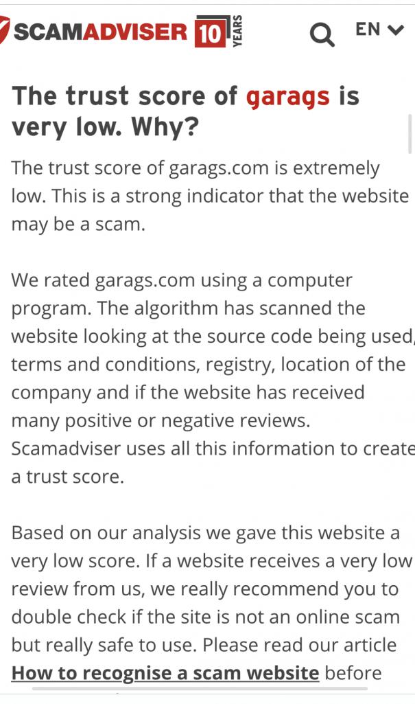

burton73   https://garags.com/product/maxjax-m6k-porta...mp;u...   Dec 14 2022, 08:56 PM
vitamin914   [url=https://garags.com/product/maxjax-m6k-portab...   Dec 15 2022, 06:34 AM
burton73   IS SHIPPING FREE? Yes, shipping is free in United...   Dec 14 2022, 08:59 PM
mepstein   I’m sure it’s a scam site. Lots of them around...   Dec 15 2022, 07:55 AM

vitamin914   Another way to look for scam websites is to check ...   Dec 15 2022, 03:25 PM
