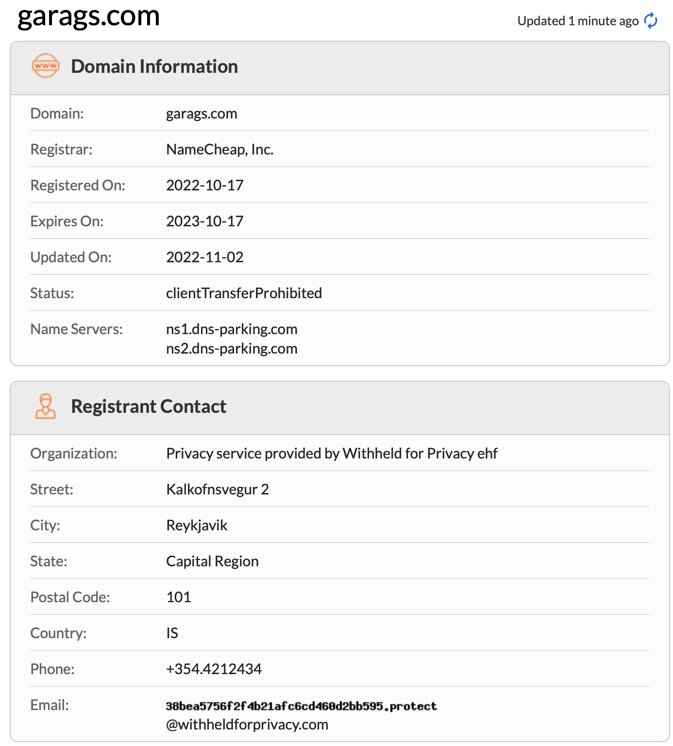

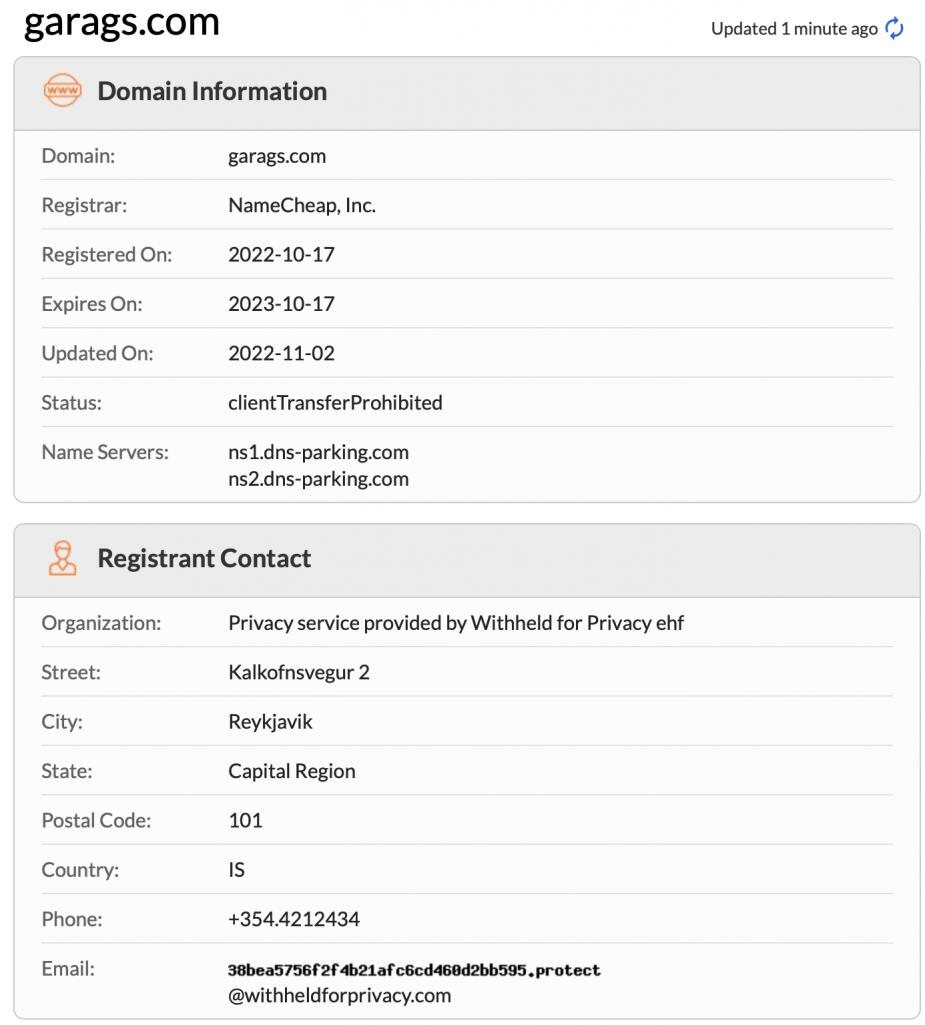

Another way to look for scam websites is to check the website domain registration (whois.com). The garags.com is beyond suspicious. Registered two months ago in Reykjavik, Iceland.
Really sounds legit don't it? Don't even risk your email address on this site.
I was suckered on a scam website for Puma shoes - very well done scam site. Caught it fast enough so they only managed a small test amount before the bank cancelled the card and reversed the charge.
