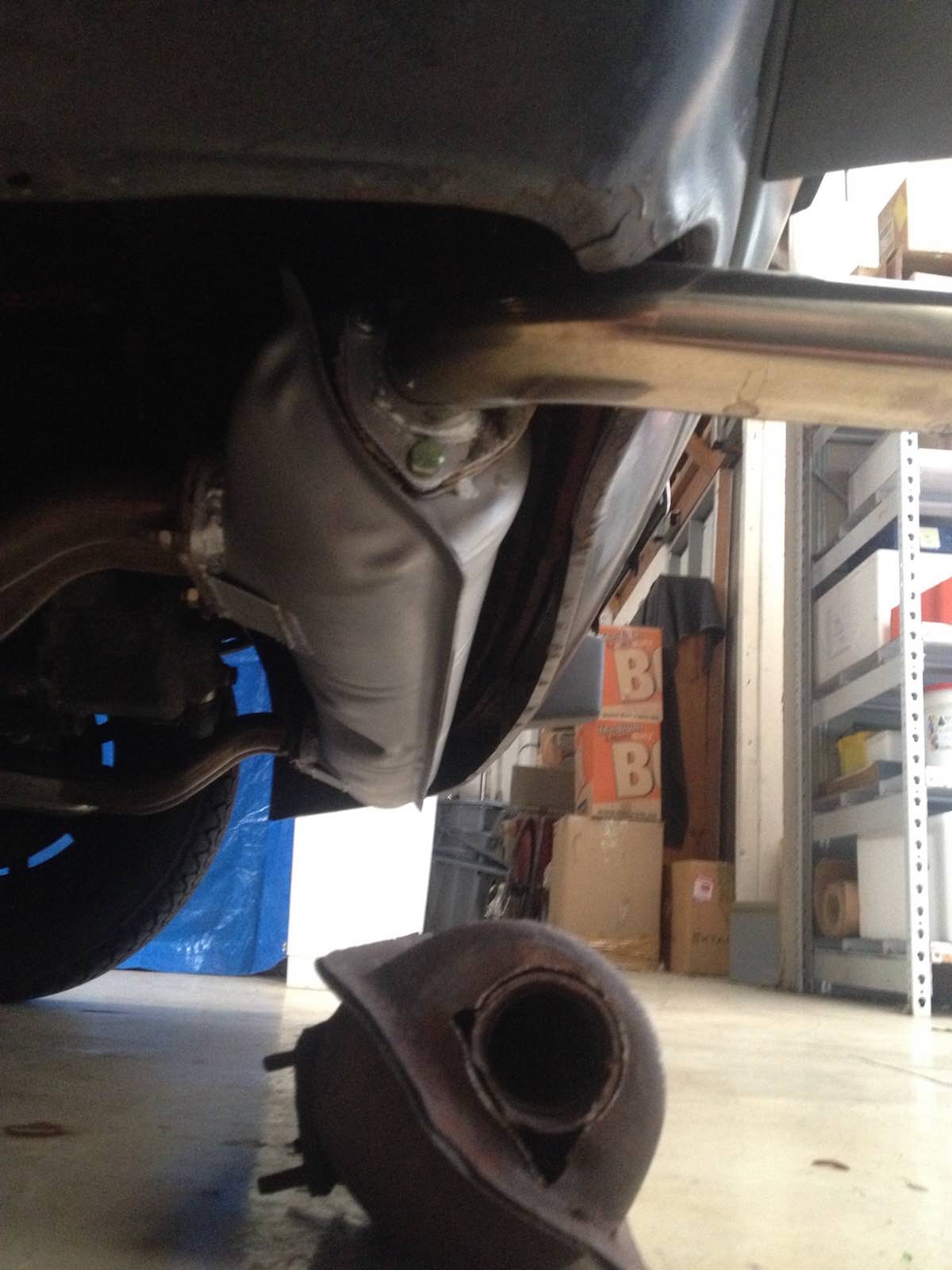

here is another photo of mine showing how the exhaust that came off mine (the rusty one on the floor) is exactly like the bus one i modified. what i don't know is whether my car came from the factory with this exhaust as i picked up the car in 1989. it could have already been a replacement muffler by that point in time.
and what i can see is the pictures of dansk 914 exhausts form adverts when i look closely do seem to match the 412 sedan version pictured in thread i found. ie when fitted the dents in them would be oriented up.
pretty funny stuff.
so what i am saying?
there definitely must have been two different kinds of ways you could get the 914 muffler back in the 70s and 80s as a spare part.
one way would have been the unit that dansk appear to be making which is actually a LHS side tailpipe 412 sedan muffler. could also be fitted to 914.
the other type would be a bus or 412 variant muffler with the inlet flanges inverted 180 deg which is the rusty old unit i pulled off my 914 and had been on it since at least 1989 but may not have been a factory fitted muffler but a spare part muffler.
i reckon it would depend on who made the mufflers as to how these things got rationalised. the unit i pulled of my car was a LANGE.
