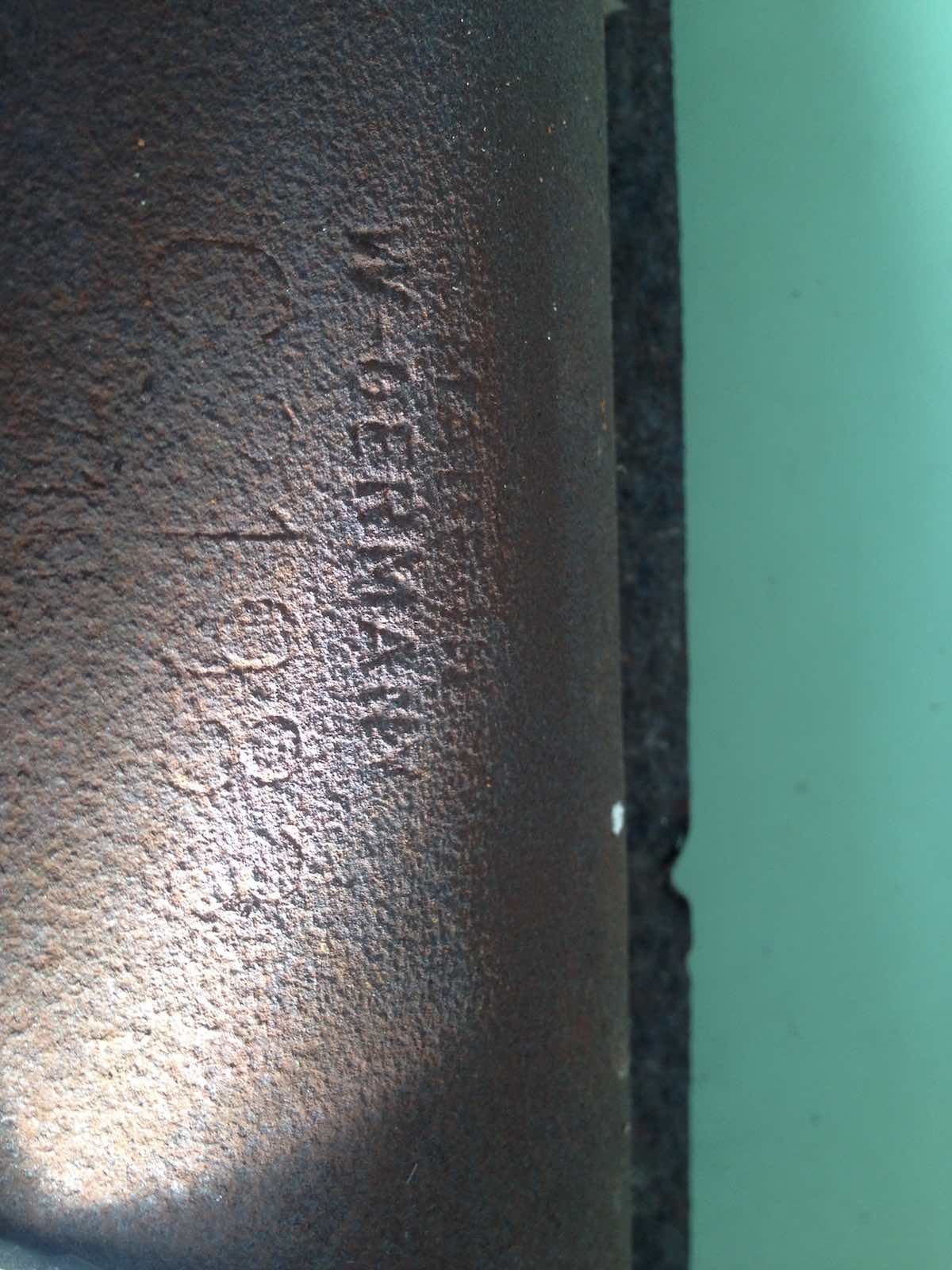

i pulled the old muffler down and took a good look at it.
its definitely a replacement not original from factory.
has a 1983 date stamp on it.
i thought it had a LANGE stamp on it somewhere but must be my imagination.
def not an ERNST or a LEISTRITZ because they did not weld the little reinforcement tabs on from the inlet flanges back to the body of the muffler as far as i know. but its german.

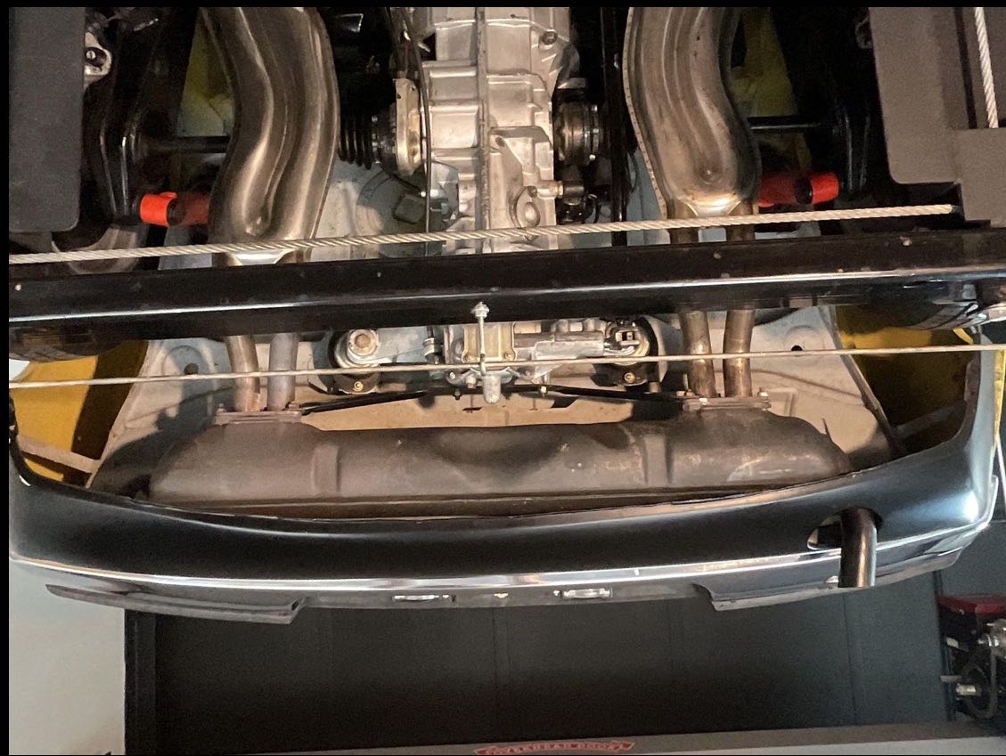

@potomacmidget
while i was snooping around i found this early car on BAT fitted with later muffler as per 74 and its pretty clear its got a unique tailpipe to let it get out the early valence.
must bend back slightly after it exits muffler and then bend out through the valence to get through the original tailpipe hole.
either its a custom fab tailpipe or you can / or could get them.
