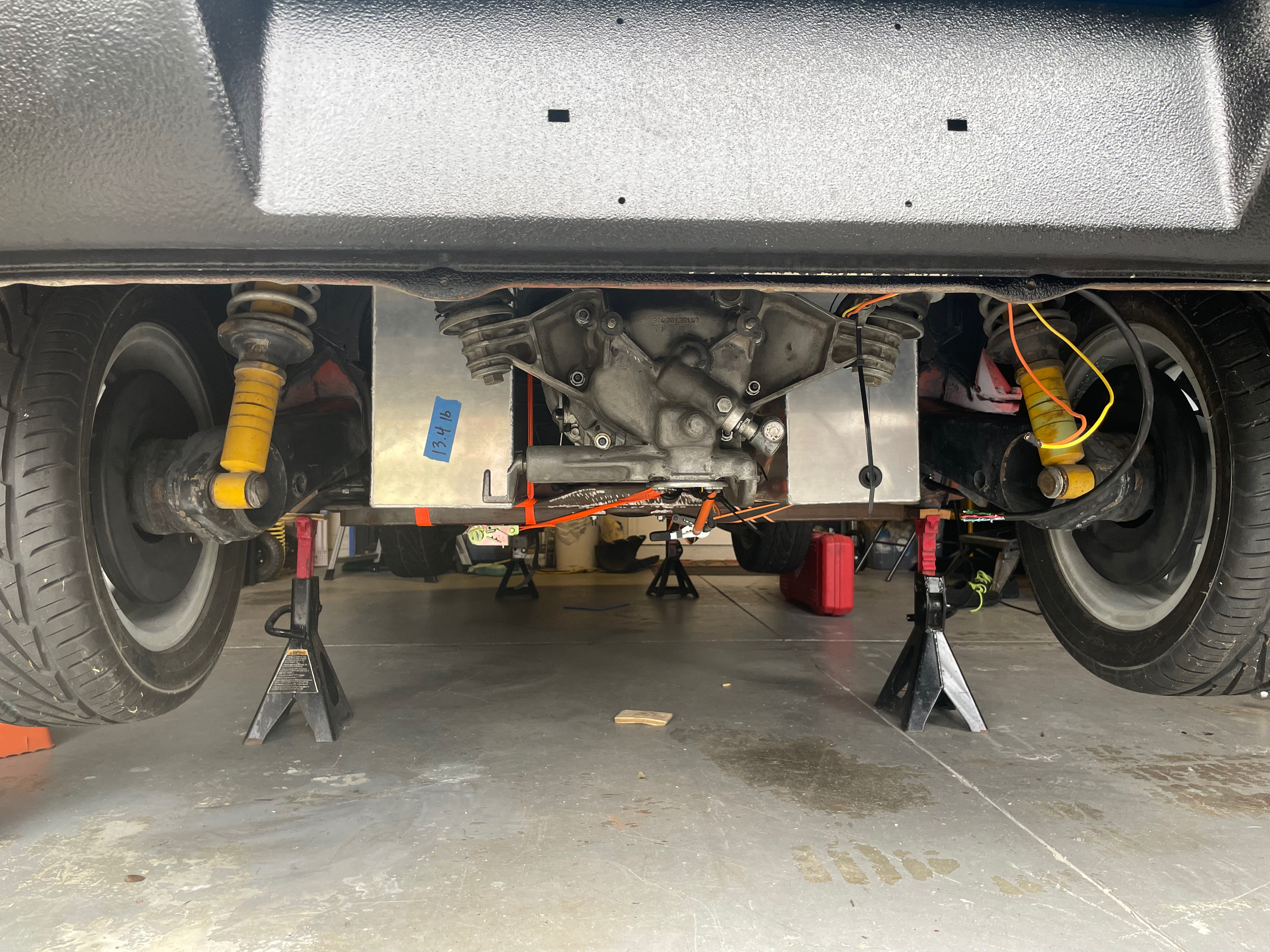

Moving to NC in two weeks. Been getting the car ready to pull up to NC from Florida. I am going to flat tow it. I have a TOAD portable braking system for it.I'm debating the merits of putting the front and rear glass in first.
I had two battery boxes built up in Tampa. All seven Tesla modules are in, but not wired. I have them in pretty secure, so this little trip will be a good test.
Rear battery boxes with batteries are 125 Lb each, and the motor and controller are 139 Lb, so this works out fairly closely to the original 4 cylinder weight.
When I get the car up to Carolina, I'll go through the weights and corner weights. I am pretty sure that the car will spin like a top, and not roll over:)

pek771   Update 1 October 2023: Rear battery boxes are in (...   Oct 1 2023, 05:04 AM

VaccaRabite   How close are the axles to the battery boxes that ...   Oct 2 2023, 09:49 AM
