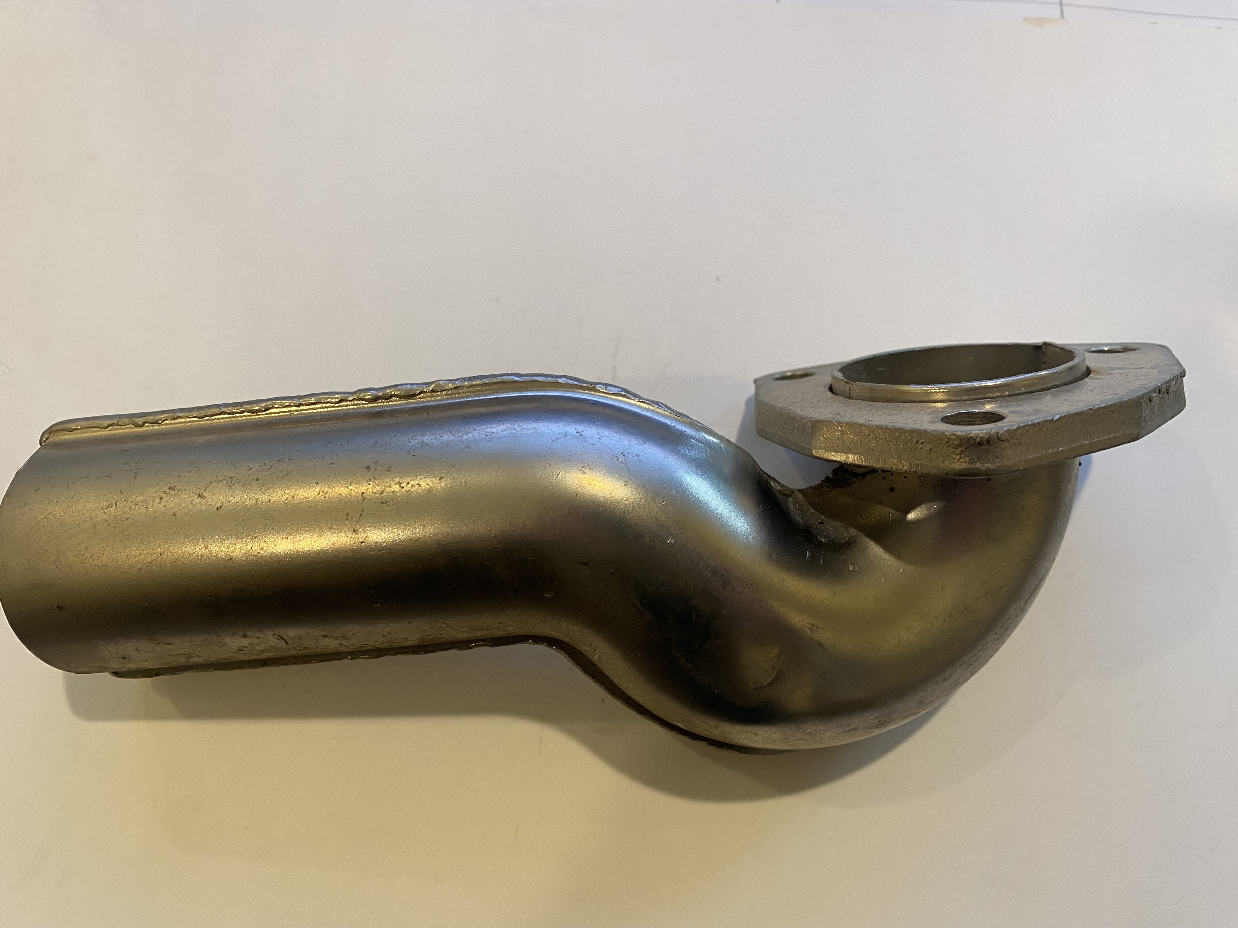

Garland   “while i was snooping around i found this early ...   Jan 3 2023, 09:17 AM
dr914@autoatlanta.com   and for the early cars with the long valance with ...   Jan 3 2023, 09:37 AM

Garland   I’ve never seen one, before. The tip I have is f...   Jan 3 2023, 02:17 PM
