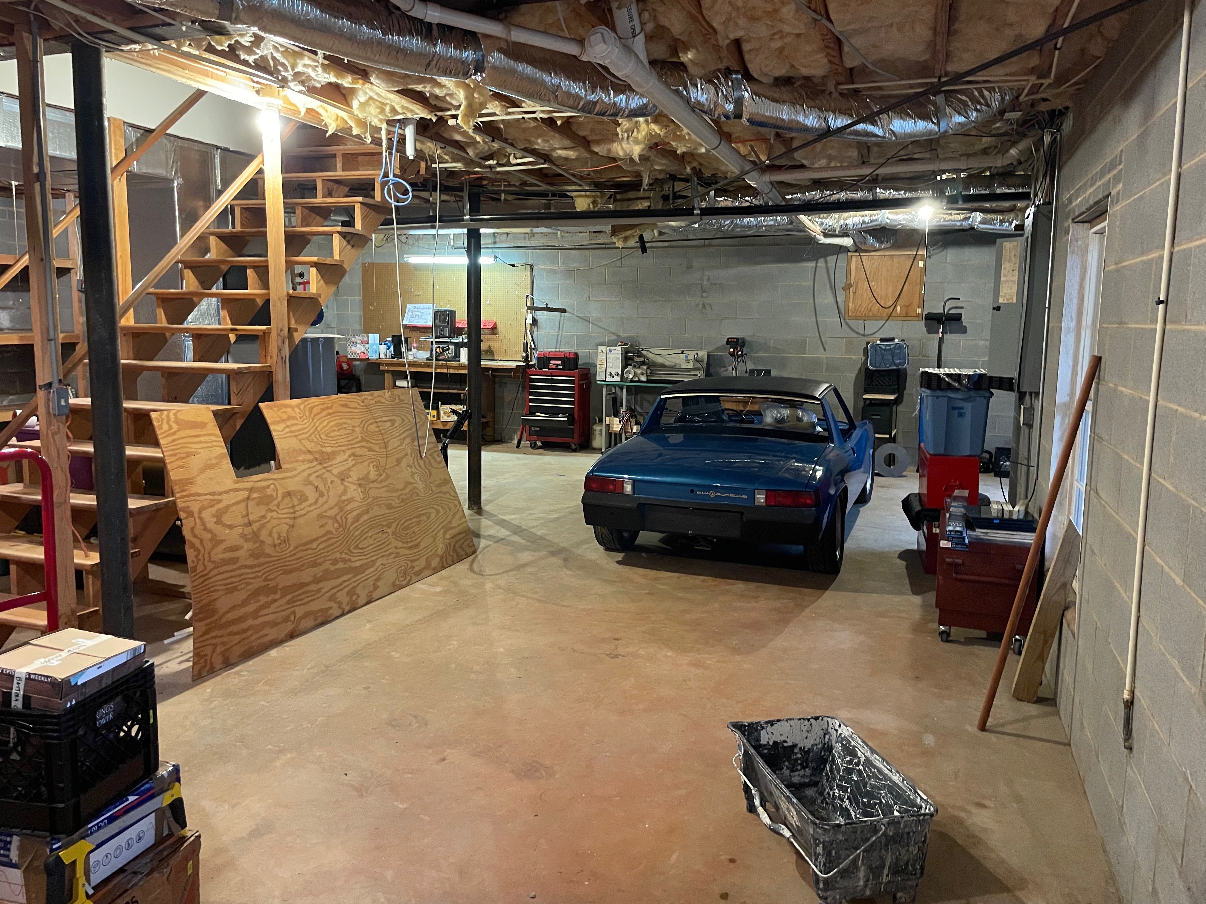

post Jan 19 2023, 12:18 PM
Posts: 275
Joined: 23-November 05
From: Conover, NC
Member No.: 5,175
BTW, I seemed to have made it to Conover, NC. Flat towed the 914 here from Florida.

pek771   BTW, I seemed to have made it to Conover, NC. Flat...   Jan 19 2023, 12:18 PM
