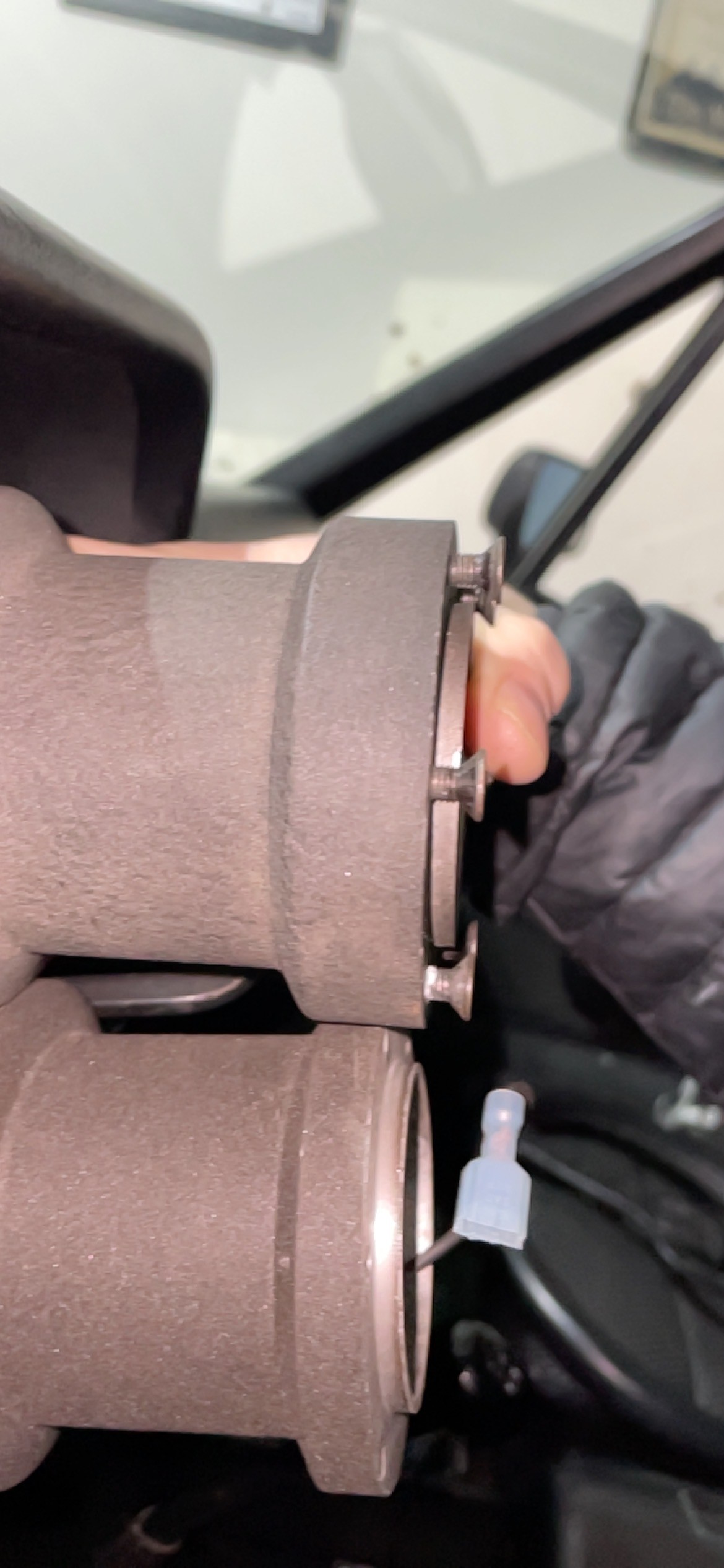

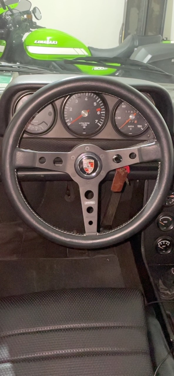

About 10 years ago my son bought and installed a Prototipo as a Father's Day gift!
While I love it, I find myself accidentally turning on the wipers while AXing or even just pulling out onto a road quickly!
At 350mm is also blocks the gauges and always seemed a bit small.
I was given another 370mm Momo - can help me identify what model and whose signature is on it?

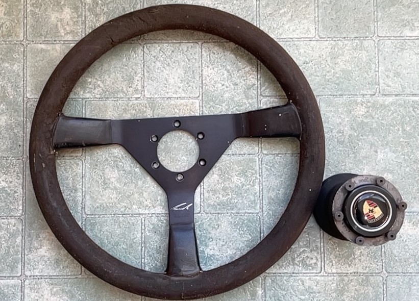

As you can see it needs a new cover. I want to recover it myself - who makes the nicest kit?

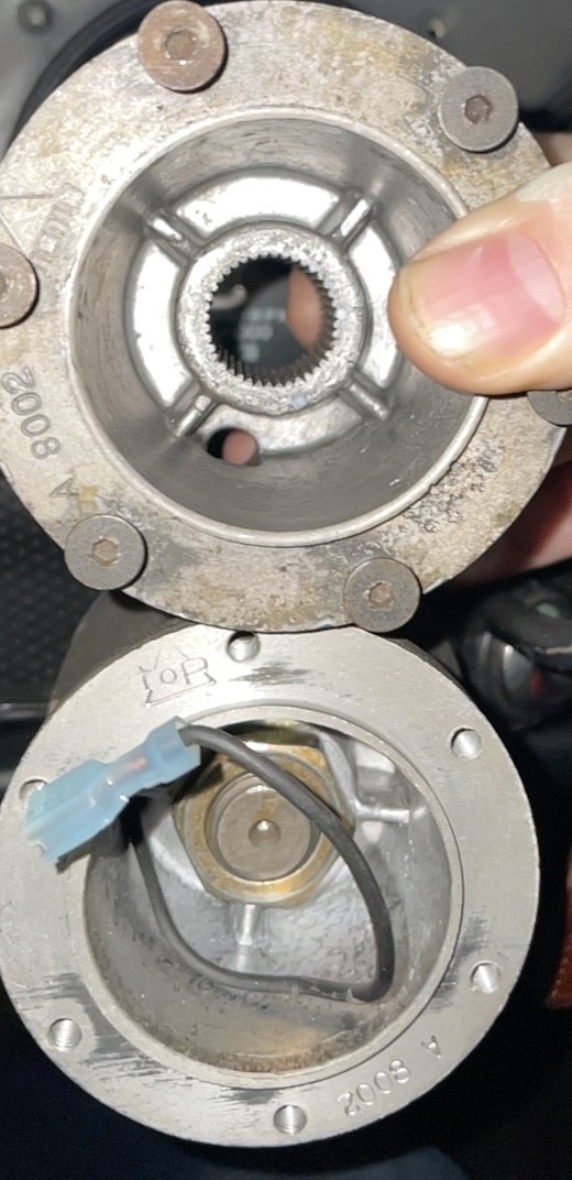

A bigger mystery, and maybe why I don't here more complaints about turning on the wipers, why is the 8002 hub my son installed is shorter than the one that came with the "Mystery Momo"?

GregAmy   That may be a JDM Momo steering wheel, some Japane...   Jan 27 2023, 09:43 AM
scott_in_nh   That may be a JDM Momo steering wheel, some Japan...   Jan 27 2023, 10:03 AM
gokart73   That’s a Niki Lauda Momo from the late ‘70’s...   Jan 27 2023, 03:08 PM
scott_in_nh   That’s a Niki Lauda Momo from the late ‘70’...   Jan 27 2023, 03:47 PM
Freezin 914   That’s a Niki Lauda Momo from the late ‘70â€...   Jan 27 2023, 08:57 PM
scott_in_nh   I did install the longer of the two 8002's wit...   Jan 27 2023, 04:23 PM
