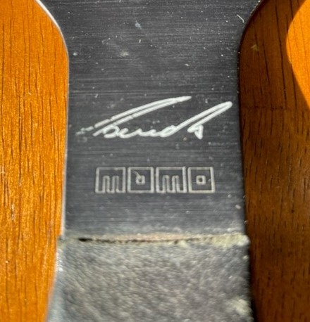

That may be a JDM Momo steering wheel, some Japanese cars had that, but with a center cover that fit between those padded areas where the thumb lies. Also used in Europe. I snagged one of those off eBay for the race car (mine is 380mm).
You'll need a closer photo for that sig.
Install one of the below. It will move the steering wheel up to get the wheel out of the way of viewing the gauges, and will space the wheel toward you a little bit. You won't even notice the eccentric when you're using it.

QUOTE(GregAmy @ Jan 27 2023, 10:43 AM) *
https://www.jwestengineering.com/Steering-E...apter_p_19.html
I'm considering the offset and will likely go that way if I stay with the Proto.
For now at least I will install the longer hub.

That’s a Niki Lauda Momo from the late ‘70’s or early ‘80’s. Should be a X - XX month/date stamped on the back.
Not a lot of survivors. Certainly worth restoring or refurbishing.

QUOTE(gokart73 @ Jan 27 2023, 04:08 PM) *
Cool thanks!
The date code is 9 78 (IMG:style_emoticons/default/smile.gif)
