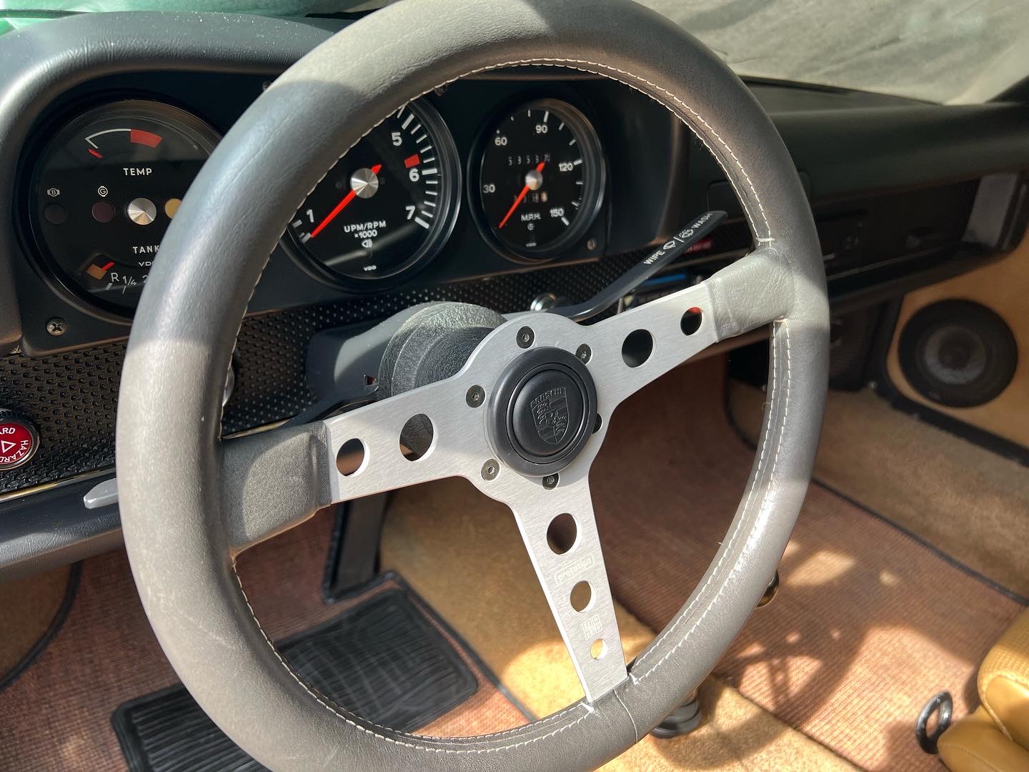

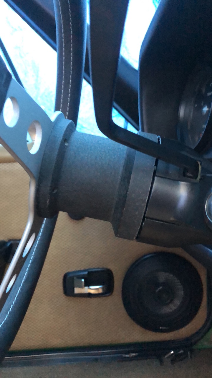

Got my momo from Amazon, with a Porsche hub, did not fit. So I sourced the 8002 from eBay, and worked perfectly.
The momo prototipo is the version with the distressed leather, which I think looks good, fits the mood. Lastly the leather horn button.
