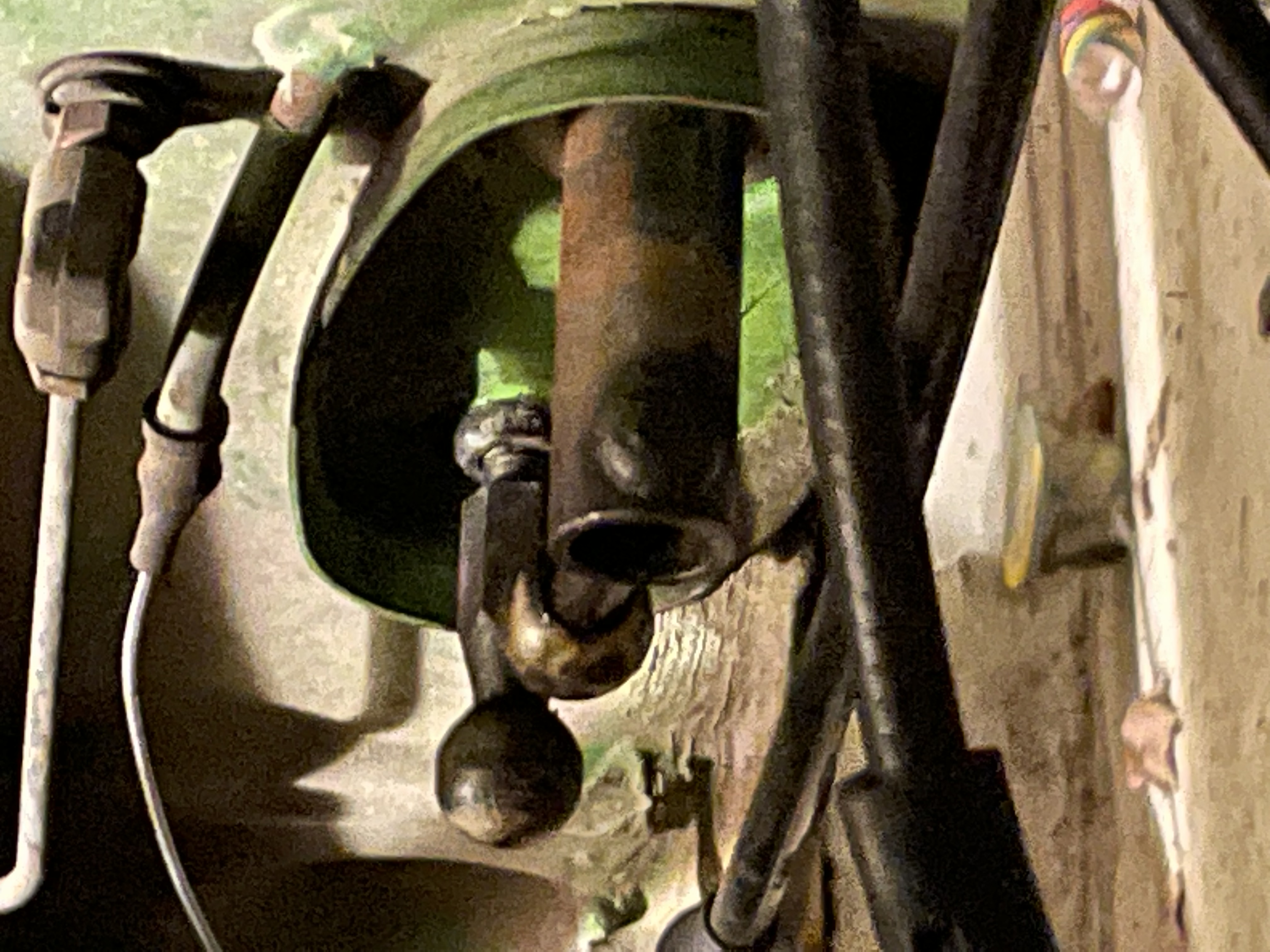

QUOTE(Drex @ Mar 14 2023, 01:49 AM) *
Krazy
i'm not quite following you on this
are you saying that i could have detached
the linkage at the firewall and then lowered the engine?
i'm waiting for the lift plate and the M8 triple square bit
Drex
Tell you what, let me take a look at mine when I get home so I don't tell you wrong.
krazykonrad
post Mar 14 2023, 05:00 PM
Posts: 1,181
Joined: 21-February 06
From: Canton, GA
Member No.: 5,610
QUOTE(krazykonrad @ Mar 14 2023, 06:50 AM) *
Yes, my shift rod is still in the car. Attached Image
