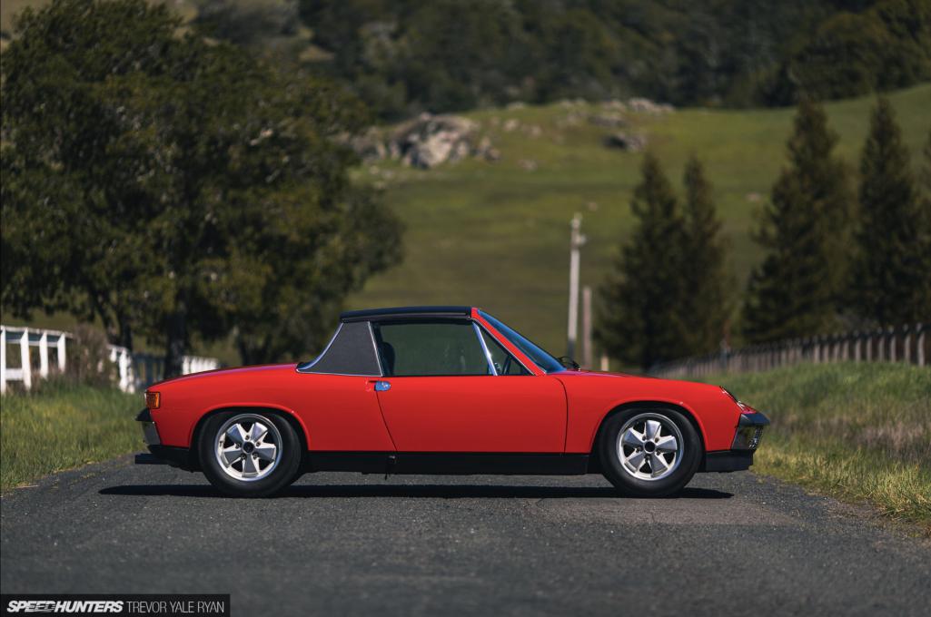

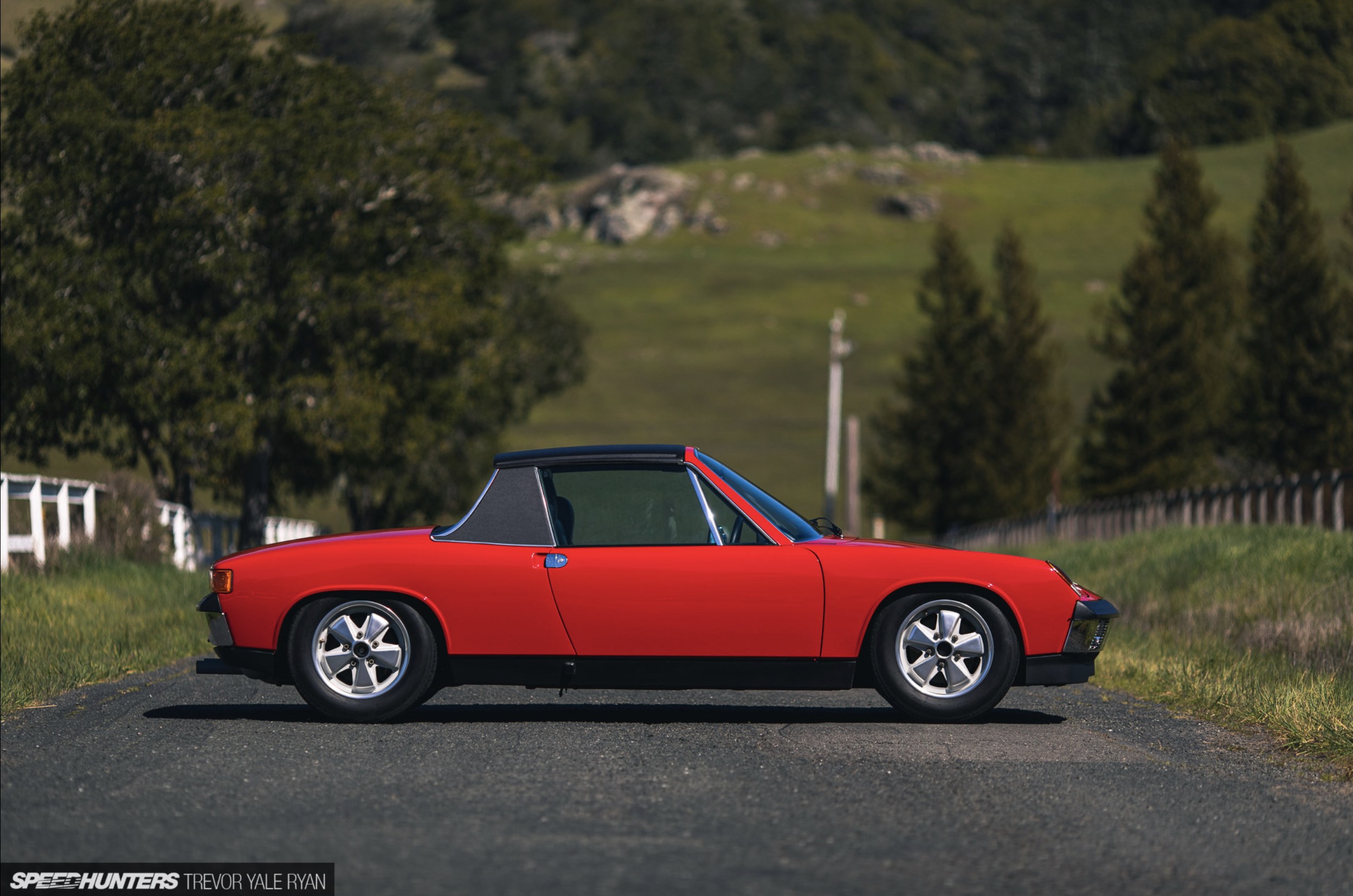

^ Gorgeous build—as much as I love the M471-flared cars, I really dig NB "subtle" builds.
Mine is "just" a warm 2.2 w/200hp, but no need for a front cooler so far. Might be fun to get the white car above, Dave's blue car, and my old red crate together for some pics—red, white, blue... (IMG:style_emoticons/default/flag.gif)
