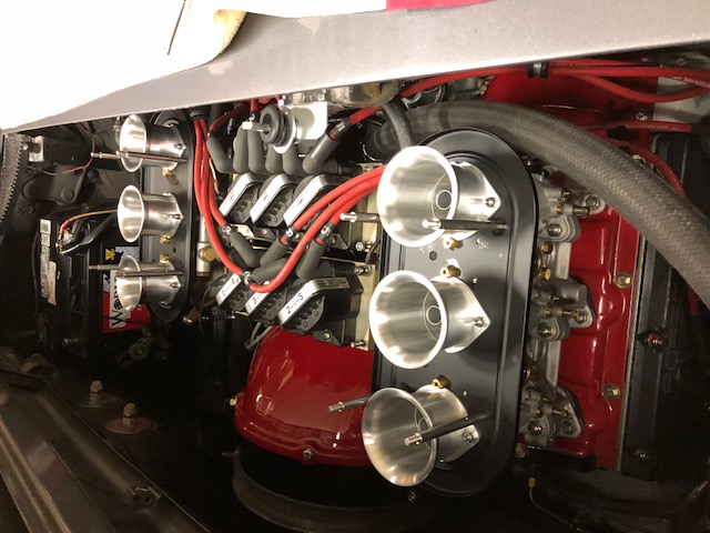

BillJ   Was curious why twin plug? RS pistons are low com...   Mar 23 2023, 12:39 PM
davehg   Was curious why twin plug? RS pistons are low co...   Nov 11 2023, 03:14 PM
BillJ   Was curious why twin plug? RS pistons are low c...   Nov 11 2023, 11:28 PM
