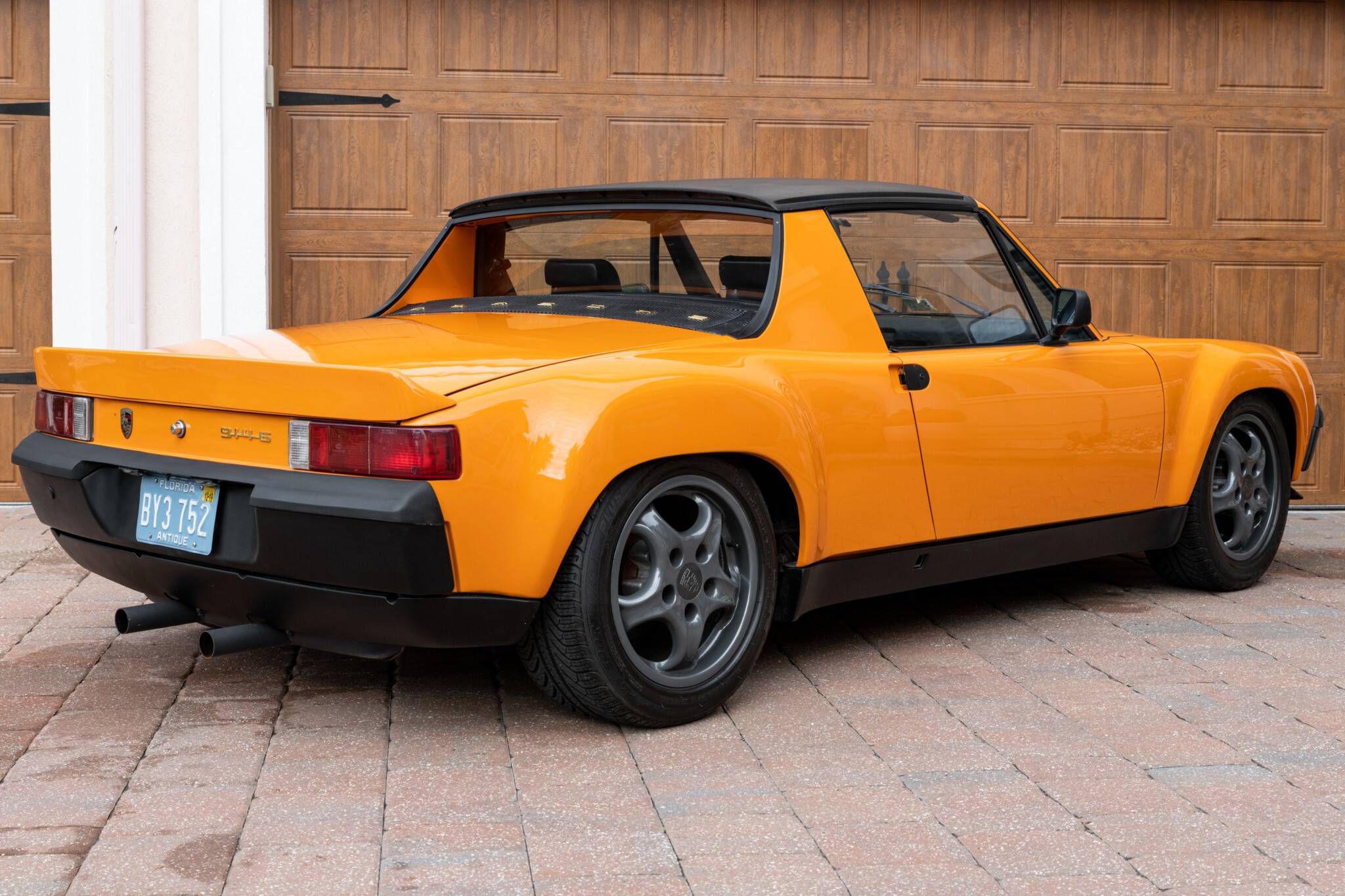

flat4guy   16x7   Mar 31 2023, 08:46 PM

raw1298   Cup 2 17x9 and 17x7.5. Could fit 17x10 and 17x8 w...   Apr 1 2023, 05:22 AM

ssstikircr   F: 18x8 225/40-18 R: 18x9.5 255/35-18   Apr 1 2023, 05:11 PM
flat4guy   F: 18x8 225/40-18 R: 18x9.5 255/35-18 This i...   Apr 14 2023, 09:09 PM
