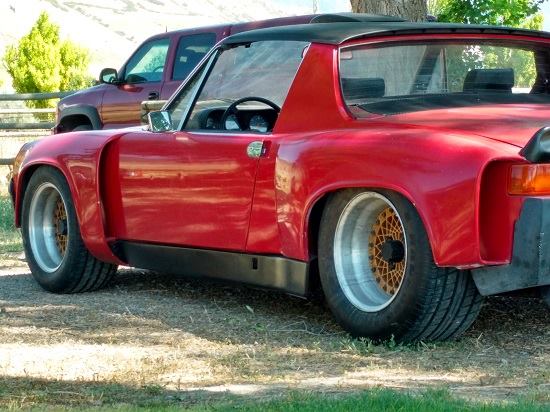

914 with steel flares (AA GT copies). Not installed yet so have room for metal negotiation during the install. Already a 5 lugger.
Obvious a few variables such as ride height to take into consideration.
What is the widest wheel combination that can be used? 7x15 front and 8x15 rear seems to be the common yet dated and am trying to get away from those size's.
What about 17 inch wheels with a lower profile tire? Anyone ever run 7.5X17 in front and 9x17 in the rear? Would like to use 16 or preferably 17 inches wheels due to tire options available .What are some of the back space measurements you guys have used?
Looking for feedback and idea's. Have not decied on wheels yet.
Like the Rota Fox's and the price is right. Also considering used factory Fuchs as an option but I am unsure of backspace/offsets for the 914. Not worried about rubber robbing HP since a fat six is pushing.

RedRuM. 10x15 and 12 x 15

Blood red 914-6gt   On my fiberglass flares I can get 9s on the rear. ...   Sep 25 2007, 01:59 AM
woobn8r   15, 16, 17, 18...they all fit. You just need a tir...   Sep 25 2007, 07:53 AM

Todd Enlund   17x8 &9 235-40 front,255-40 rear. Jerry ...   Sep 25 2007, 08:08 PM

dgw   I had 8 and 9x16 fuchs on my fiberglass flared car...   Sep 26 2007, 11:33 PM

retrotech   These are 8" x 17 with 235 on all 4. Previous...   Oct 10 2007, 12:42 PM

retrotech   This picture is with 7" x 17. I have this set...   Oct 10 2007, 12:56 PM
East coaster   My car with AA repro steel flares and 9x17 rears, ...   Oct 10 2007, 07:35 PM

flat4guy   16x7   Mar 31 2023, 08:46 PM

raw1298   Cup 2 17x9 and 17x7.5. Could fit 17x10 and 17x8 w...   Apr 1 2023, 05:22 AM

ssstikircr   F: 18x8 225/40-18 R: 18x9.5 255/35-18   Apr 1 2023, 05:11 PM
