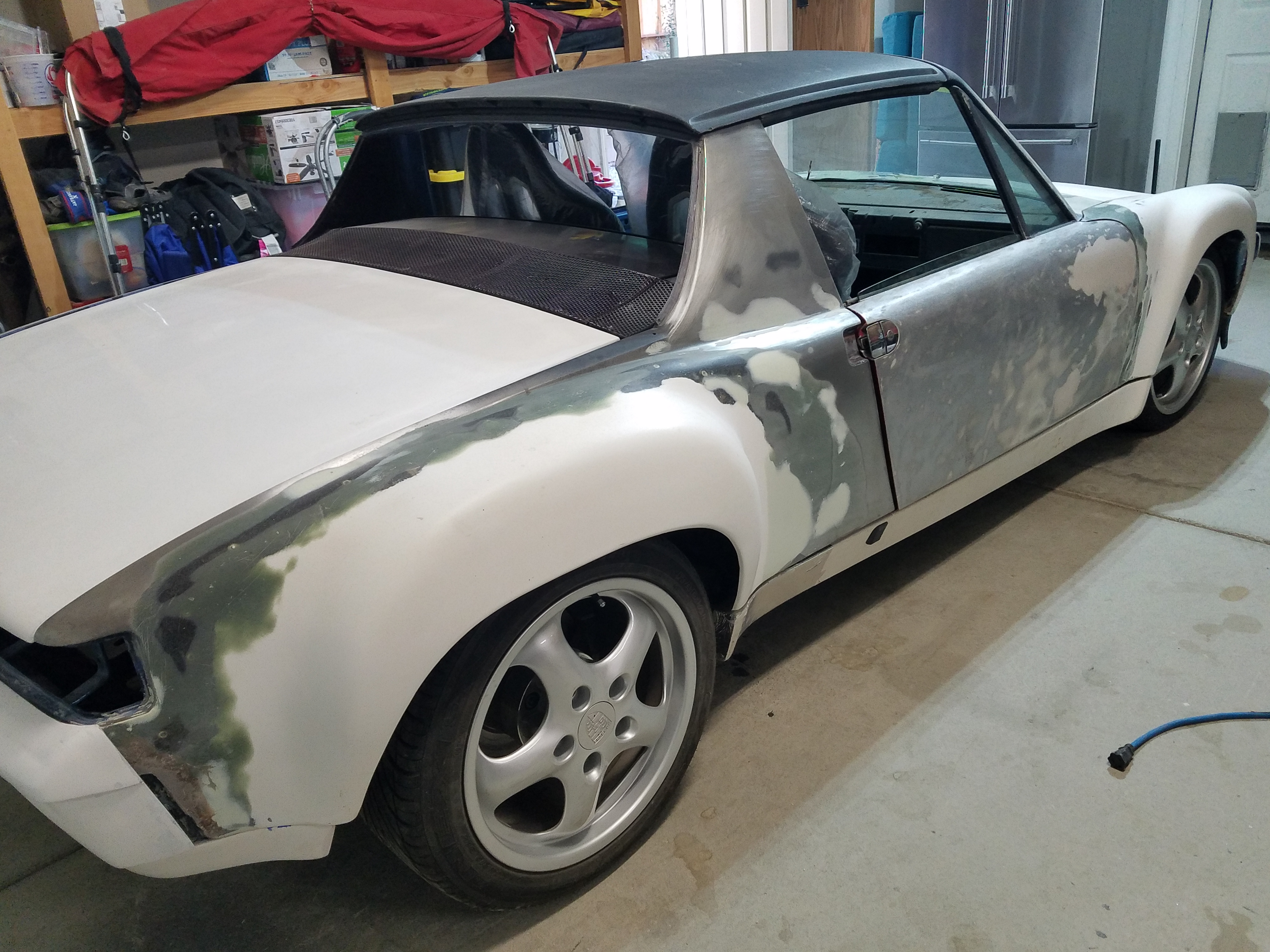

raw1298
post Apr 1 2023, 05:22 AM
Posts: 616
Joined: 9-March 09
From: Rocklin,Ca.
Member No.: 10,148
Cup 2 17x9 and 17x7.5. Attached Image
Could fit 17x10 and 17x8 with these flares. QRS fiberglass quarter panels.
