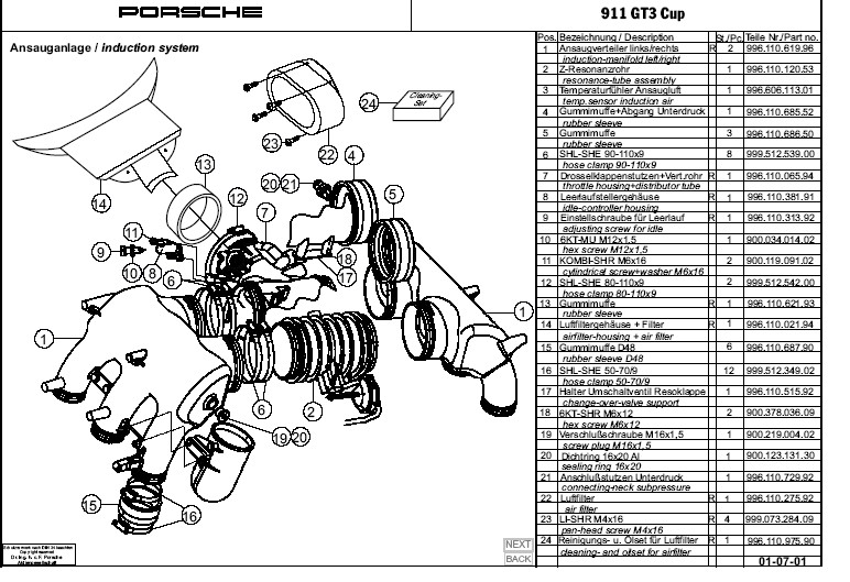

for my 2316 it seems that the stock plenum might be reaching it's limits as far as volume goes.....so, I either fabricate a larger common plenum, or go with individual throttle bodies such as TWM or Jenvey*
single plenum would be easiest, but the individual throttle bodies look better (IMG:style_emoticons/default/smile.gif)
has anyone switched from one to the other on the same motor with everything else being the same???

I got this from the 2004 GT3 cup car manual... pretty kewl stuff INDEED!

TimT   Mike the GT3RS we just tore down has a big box ple...   Dec 18 2004, 02:09 PM

TimT   Mike here is the GT3RS plenum, I couldnt find wher...   Dec 20 2004, 04:19 PM
TimT   nuther   Dec 20 2004, 04:20 PM
TimT   YOu bolt the different restrictors to that round ...   Dec 20 2004, 04:22 PM
Mueller   thanks Tim, that is a huge plenum...and dusty to...   Dec 20 2004, 04:48 PM
