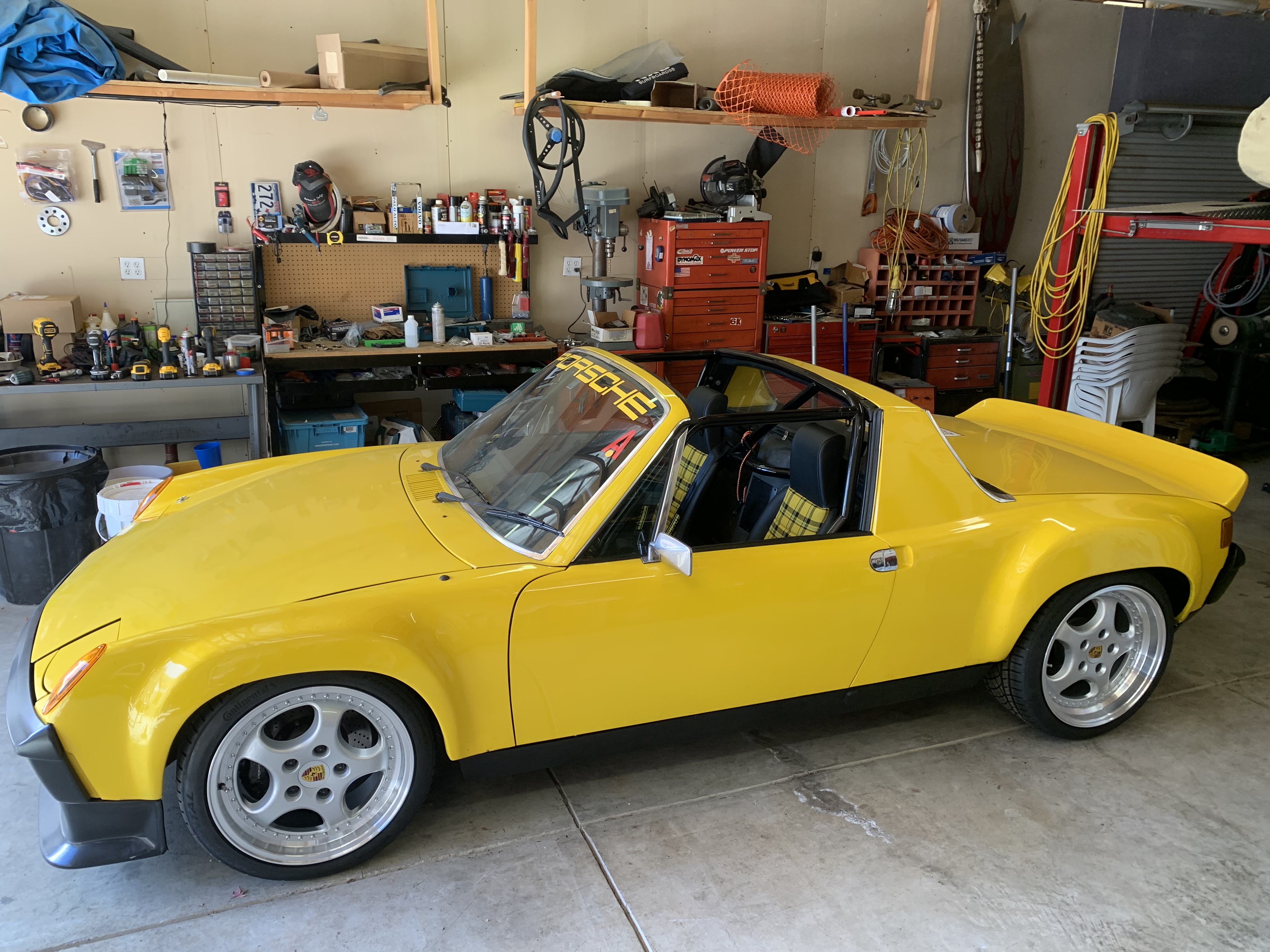

ssstikircr
post Apr 1 2023, 05:11 PM
Posts: 217
Joined: 11-January 09
From: Fair Oaks, Ca
Member No.: 9,920
F: 18x8 225/40-18

QUOTE(ssstikircr @ Apr 1 2023, 04:11 PM) *
F: 18x8 225/40-18
R: 18x9.5 255/35-18
This is beautiful

ssstikircr   F: 18x8 225/40-18 R: 18x9.5 255/35-18   Apr 1 2023, 05:11 PM
flat4guy   F: 18x8 225/40-18 R: 18x9.5 255/35-18 This i...   Apr 14 2023, 09:09 PM
