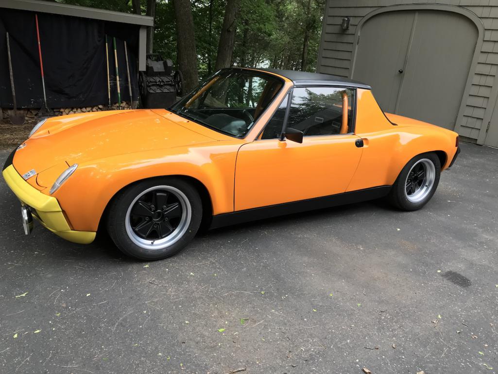

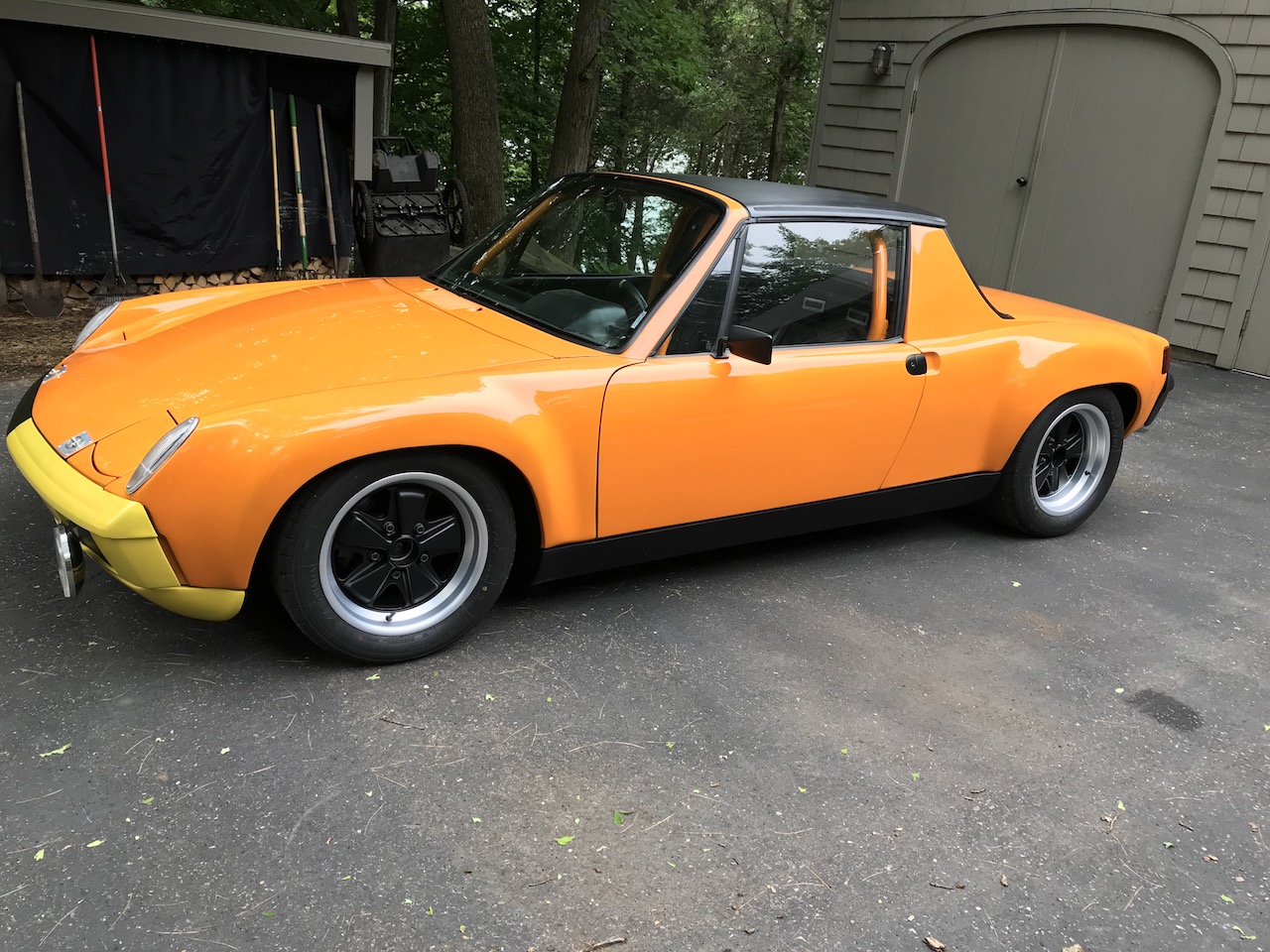

I've got 7 and 8's x 15 Maxilites, running 205/50 front and 225/50 rears. Fronts have 1/2 wheel spacers, Rears none. MarkAttached Image
