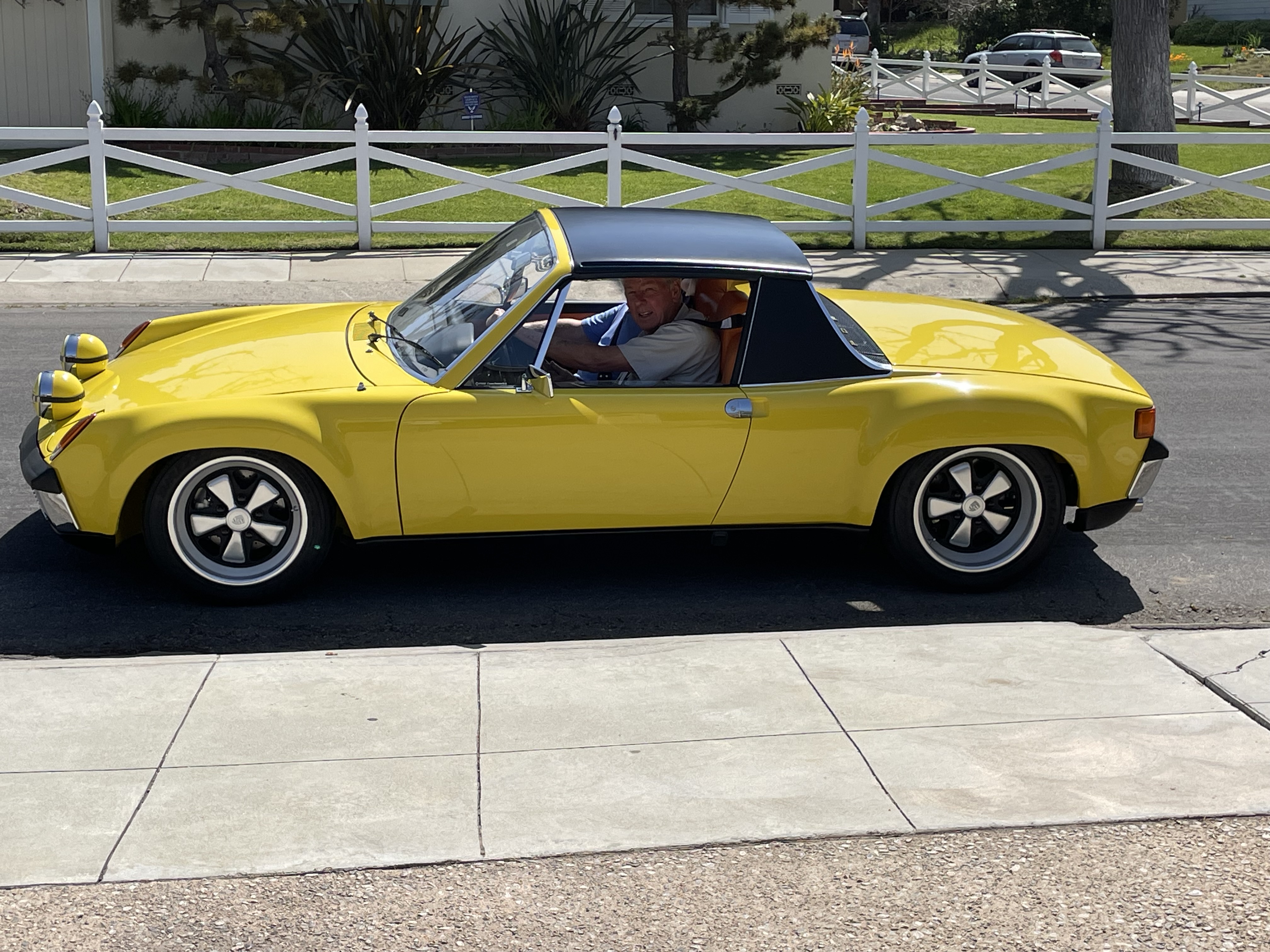

burton73
post Apr 15 2023, 02:11 PM
Senior member, and old dude
Posts: 3,851
Joined: 2-January 07
From: Los Angeles
Member No.: 7,414
Alan driving my 6. "Baby you can drive my car, Yes I'm going to be a star"
Beep Beep Beep Beep yea
Bob B
7 x16 and 8 x 16 factory Fuchs 911#
