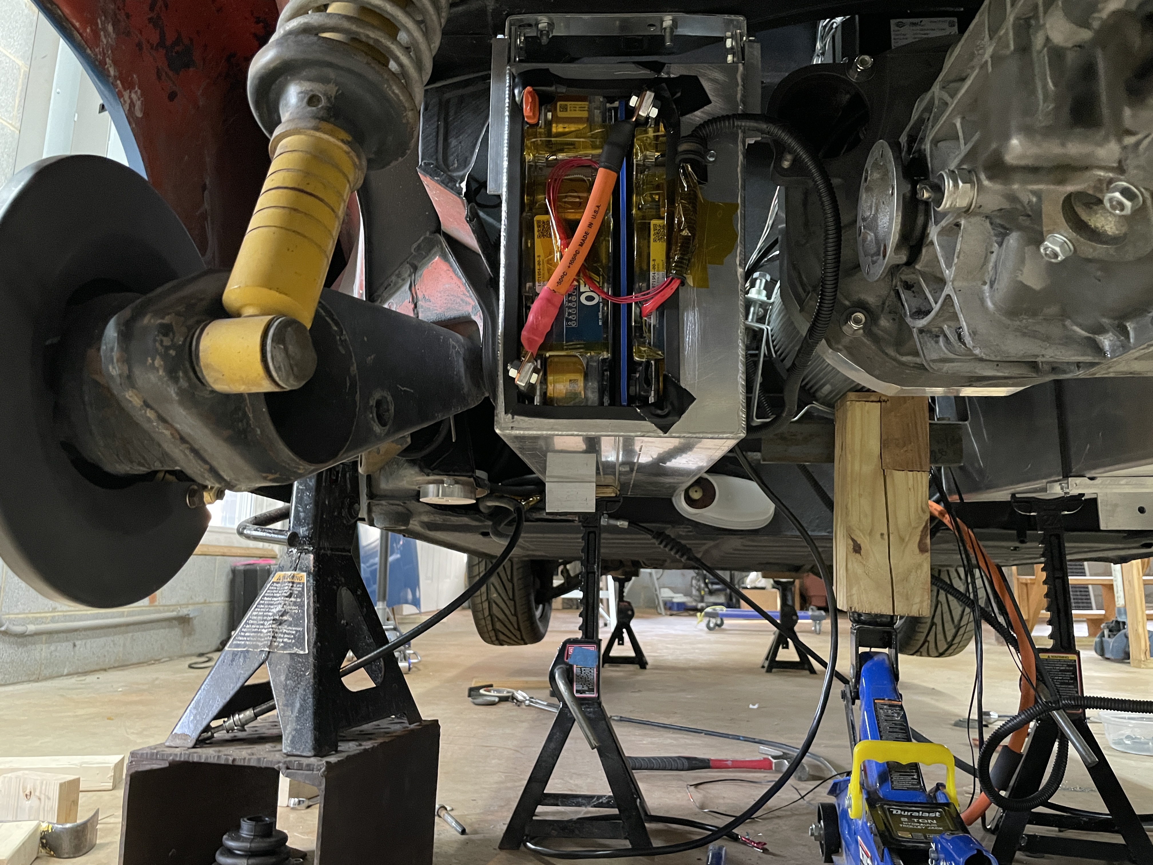

Batteries are all in. 7 Tesla modules and 6 4s18 p 2170 cell packs I built for the lower voltage stuff. This way. I don't have to rob and power from the Tesla modules. 4 Tesla modules are astride the motor in the engine compartment, and three are in the front. Th 6 4s18p batteries are where the fuel tank was, and in the very from of the trunk. I got new CV's and booties from PMB, There is very little room for the axle shafts to clear the rear batteries. Frankly, I'm worried I may twist the shafts out and short the batteries.

pek771   Update 1 October 2023: Rear battery boxes are in (...   Oct 1 2023, 05:04 AM
Gint   Wiring is a PITA Yep! Awesome project. Can...   Oct 3 2023, 04:58 PM
VaccaRabite   How close are the axles to the battery boxes that ...   Oct 2 2023, 09:49 AM
pek771   I lost two roll pins for the new CV joints (lobro)...   Oct 10 2023, 04:43 AM
