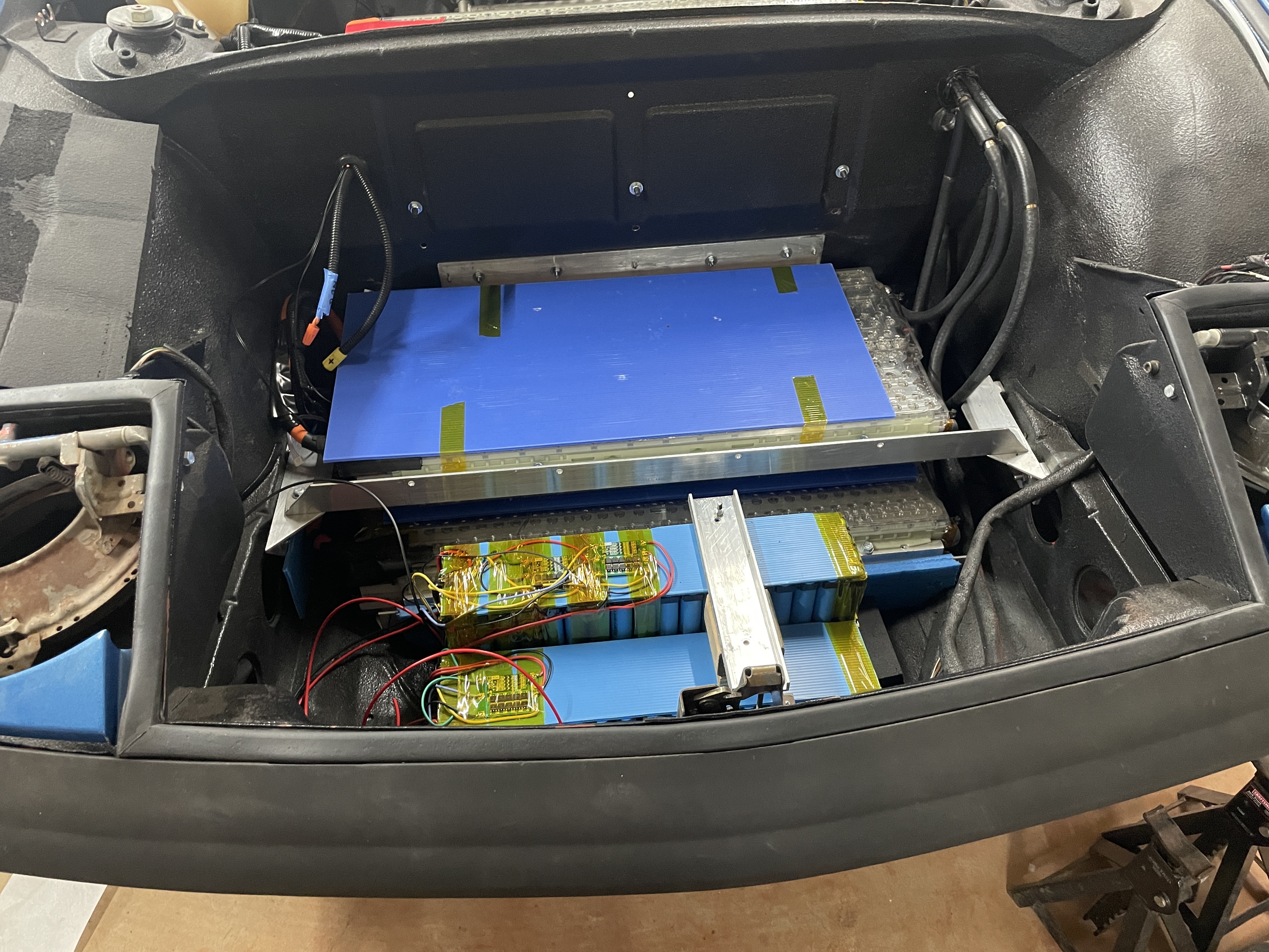

pek771   Update, Decoration Day 2023. Batteries are all in....   May 30 2023, 07:45 PM
pek771   I am rewiring the lighting at the moment. Don...   May 30 2023, 07:50 PM
pek771   Last photo for today:   May 30 2023, 07:51 PM
