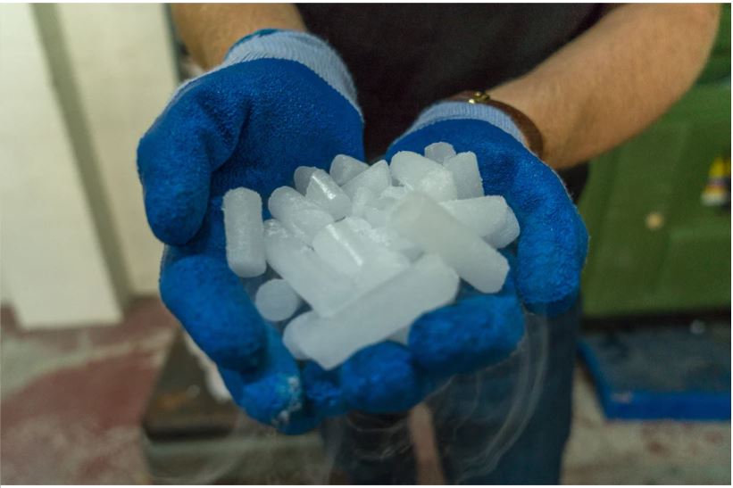

Have done it with the Fein tool before but I am curious about the dry ice option.
Is this the type of dry ice one would used?
And if so, what quantity would be needed for the whole job?
Thanks! (IMG:style_emoticons/default/smile.gif)
