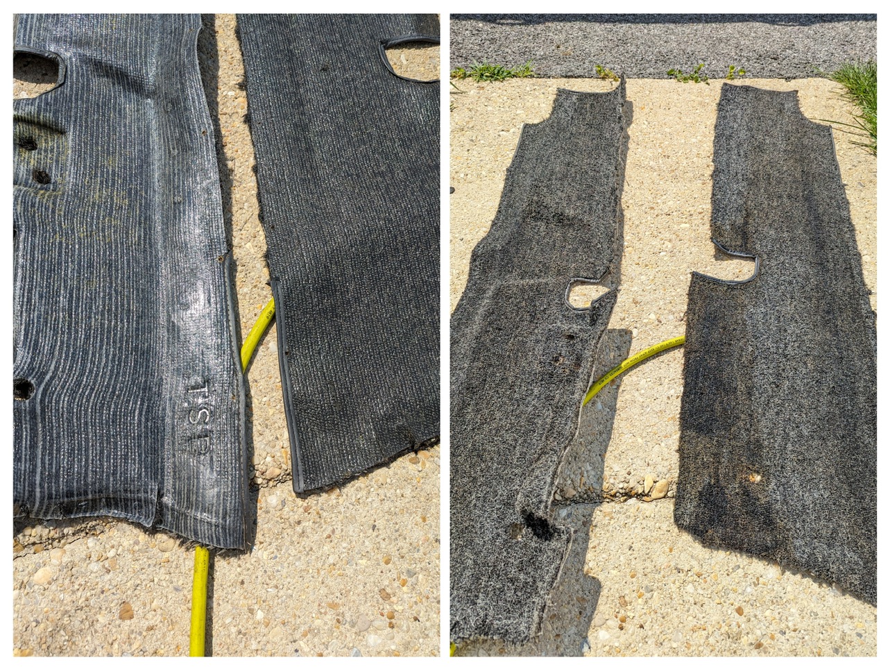

Timely conversation, I’m a couple days late, but I think I can add value here. I was out degreasing and power washing my carpet to see if it can be saved. I noticed that there is definitely a typical VW parts bin effect here. Passenger side has a black rubberized base while the driver side is more translucent. Maybe its a coincidence, but the passenger side would not come clean, whereas the drivers side washed out pretty well.
Also, the drivers side has TSB embossed on the backside. (IMG:style_emoticons/default/confused24.gif)

@StarBear and i have been through that.
what you got is consistent with what was in ours.
not as parts bin as you think.

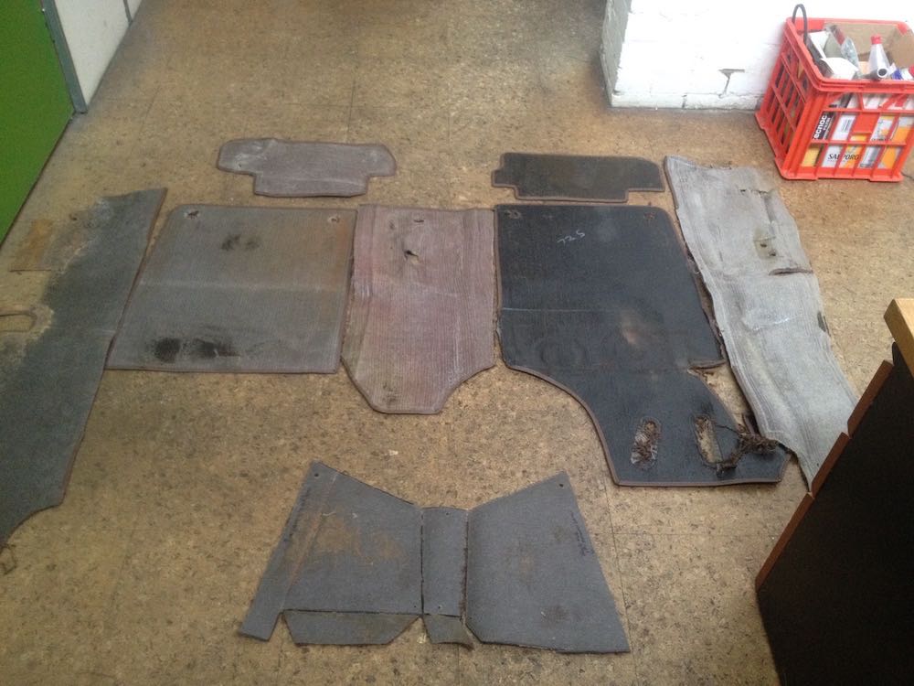

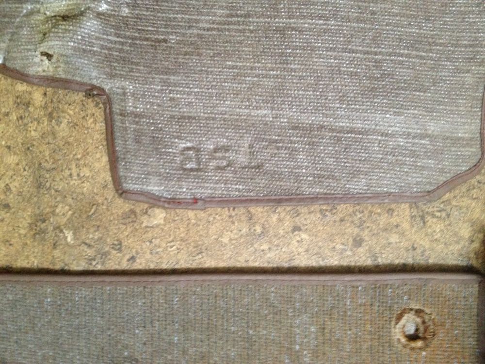

the ones that are moulded to a shape have the TSB markings and the thick plastic base on the back surface to hold the shape that is heat formed to contour. left hand side sill (for handbrake hand recess), tunnel piece to hold shape there and the little piece behind the passenger seat is moulded to allow for wiring through for interlock relay. drivers carpet piece had a kind of rubberized black backing. from memory the other pieces were all the standard base carpet backing, thinner flexible clearer plastic.
my old left hand drive carpets.
(driver piece is butchered to get the pedal slots and heel pad out for the rhd set i made).
its another sign you got a very original car mate. (IMG:style_emoticons/default/beerchug.gif)
