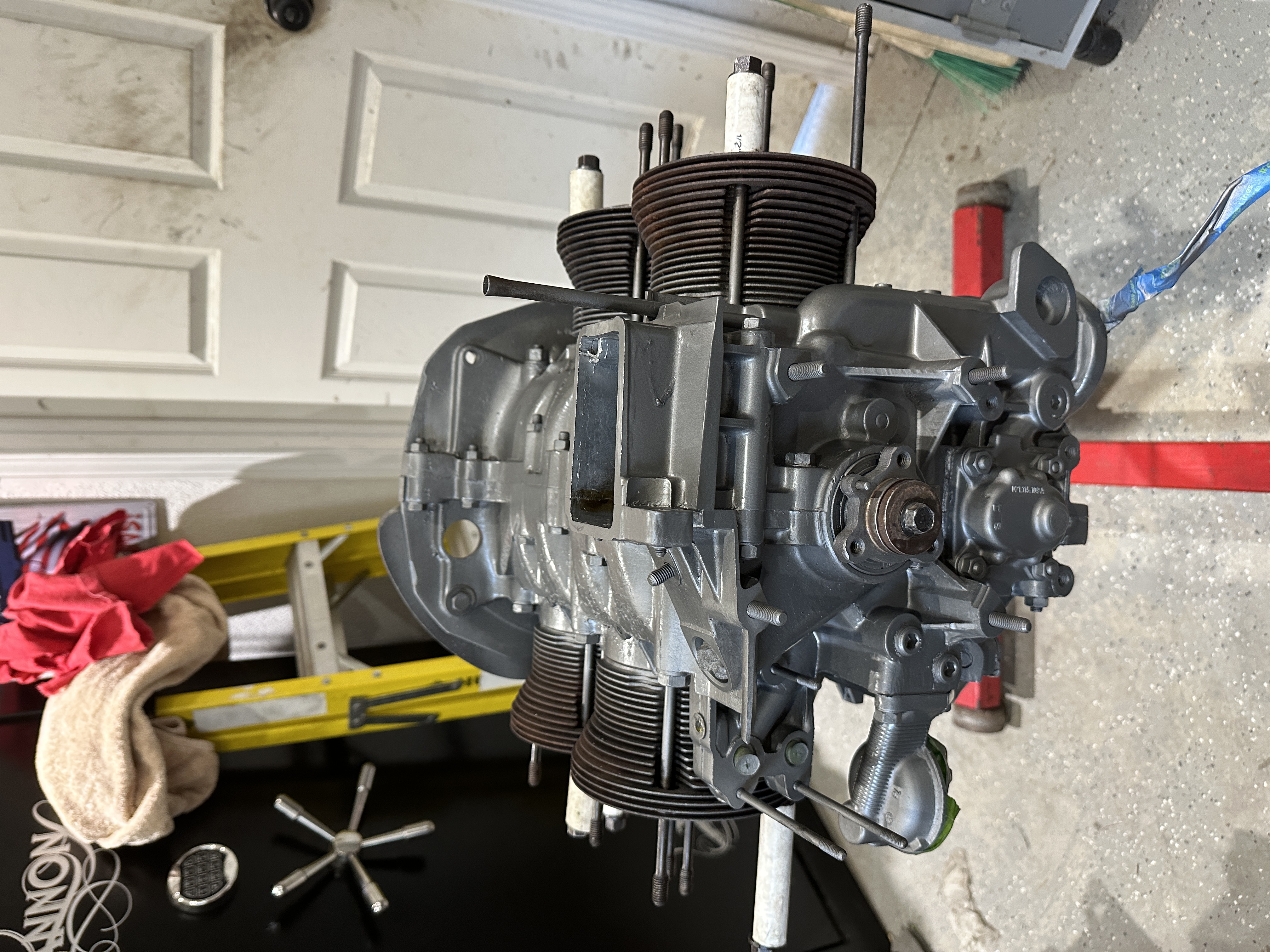

Playing with a thermal dispersion paint from Cerakote (transfer Gray)
Here:
http://www.914world.com/bbs2/index.php?showtopic=366063Attached Image

rfinegan   Playing with a thermal dispersion paint from Cerak...   Jul 17 2023, 05:30 AM

rfinegan   Darn, the engine yoke got me again. its touching t...   Jul 23 2023, 07:30 AM
rfinegan   DIY: Jet Doctor for idle jets or just by them fro...   Jul 23 2023, 11:11 AM
rfinegan   oil primer in progress...   Jul 23 2023, 02:30 PM
rfinegan   engine update..stubs and tins next...   Jul 23 2023, 02:34 PM
rfinegan   engine yoke mod...#3 cylinder   Jul 23 2023, 02:36 PM
rfinegan   cylinders hitting the the yoke frame   Jul 23 2023, 03:25 PM
