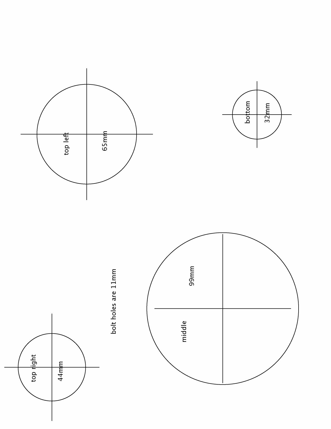

McMark always said do not use hole saws - scribe a line and sneak up on it while you can see the relevant tank port behind your internally circumscribed removed metal.
These are some raw measurement supposedly for the DWD tank, but I think it had the same fidelity as the original:
The proper hole diameters to scribe:
The template to be scaled and printed at 8.5" x 11"
