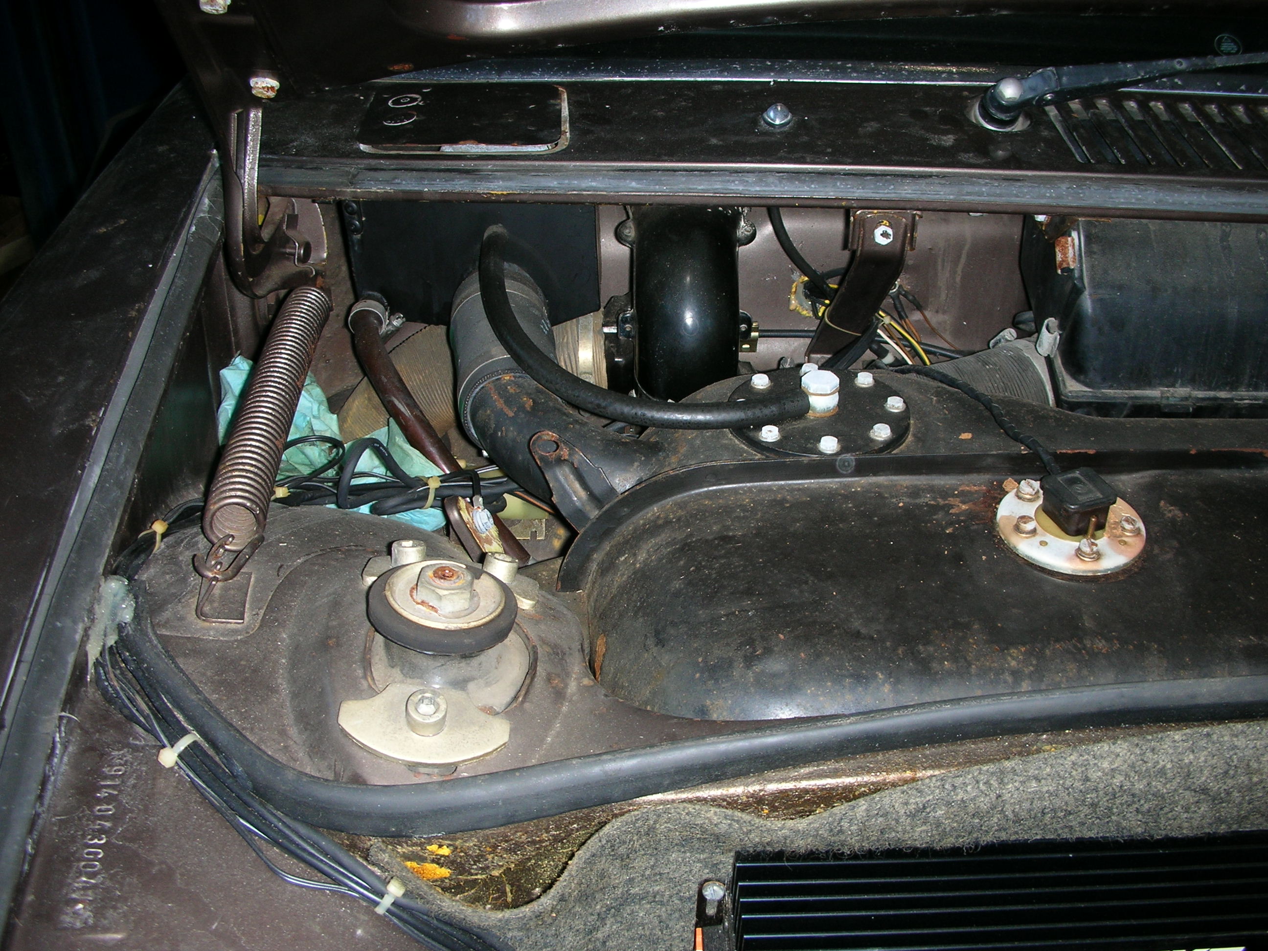

burton73   Ok boys, Here is a picture of the fresh paint on #...   Sep 24 2023, 09:18 PM
930cabman   Ok boys, Here is a picture of the fresh paint on ...   Sep 25 2023, 04:56 AM
