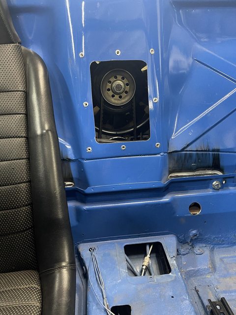

With the engine in, we cut an access bay to enable easier service without having to drop the engine or wrench backs:

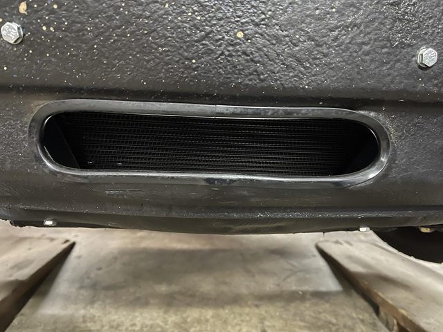

The front mounted cooler was a smaller one, so we didn't have to cut the front valence. There's enough gap between the bumper to enable lots of air to pass through.

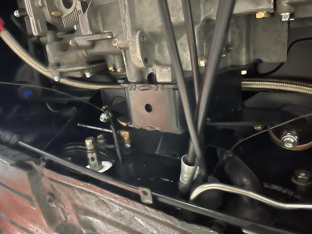

Here's a shot of Rich Johnston's mount - I love it much more than the Patrick Motorsports mount I have on my 3.2.
